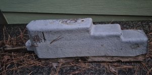

My original mount was overly complex. It had multiple step downs and angled corners that are not necessary. My version was much easier to build and will be easier to glass. Maybe it was designed that way to accommodate different motors but it's not necessary for mine. I like simple!

Motor mounts are installed. Covered the bottoms and sides with CSM before installing them. Height and levelness (word?) are dead on so looking good in terms of engine fit. For reference, I ended up using about 20oz of PB for each mount.

I also used a table saw to get the bottom angle. That worked really well once I figured out the appropriate angle.
were the step downs facing the bow or the stern?

Was thinking maybe they were for access to accessories or starter , which is opposite where the step downs were… if your fuel filter is bottom left as you face the engine might be close ??
My engine is currently on a stand very similar to the motor mounts and I can't see anything with restricted access. The oil filter in the back and fuel filter is well above the mounts. Both are easily accessible with the motor installed. I guess I'll find out the hard way if I'm not seeing something.
