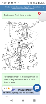

info from the ETEC world.... post FICHT

dingbat
Nov 20, 2001
17,352
I never even knew it existed
