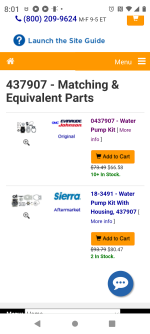

Maybe you have the wrong water pump.
Is it this one? Your model number indicates rope start.
I will have to check part numbers, I ordered several trying to eliminate that as a possibility.
The current one is same as what came out. BUT, it could have been wrong. Again, engine e was bought used, ebay. There's just no telling..
