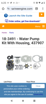

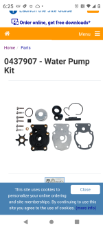

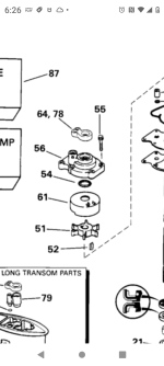

Parts breakdown for your motor looks just like the one your using. OEM #0437907 I included a Sierra pic too
Not sure what's going on.
I will try to find out what the previous # was we tried that looked like this. We tried several, by looking up part. Not sure why I got conflicting #'s but I did. The one we tried that had the same design seal as shown in the pic you provided, was too big. It was like for a 50 or bigger. The seal resembles what I believe would be correct. There seems to be a seal needed that would fit that way and lay flat and even across the surface of the midsection. I will try to get some #'s from previous and current housings..

Honorary Supreme Mariner
39,985
0340811 is the part # for the seal ( grommet ) between water pump and exhaust housing.-----This should not be a big issue to install the correct parts.
This is a different pump than what in it now, and what was originally in it when he received it.
We ordered this pump and it was too big. Looked right as far as design, just too big.
