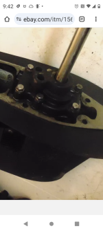

Ok, eBay had a gearcase for sale.....zooming in I see what it should look like. Clearly isn't the one you have.

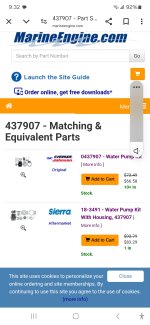

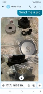

Ordered the 18-3491 pump kit. Turned out to be one I've already tried. Way to big, looks like it would be for a 40/50+
It's hard to see the pic Saltchuckmatt of the one you found on ebay, but it looks close to what is advertised in your post.
Below are some pics of the 18-3491(second one we ordered) and it's clearly different.
Racerone, input on right parts?
The grommet your speaking of is not going to remedy the housing being too tall.
I have worked on several outboard and rebuilt a few. However I'm not ( but looks like i will be) familiar with this year/3cyl design.
Just a random idea.. would a 2cyl lower unit fit the 3cyl engine? ( agin, it was purchased on ebay say idk what may be mismatched) Gonna check lower unit housing numbers tomorrow and verify hopefully.
Thoughts on that?

Some " club fisted " clown on E-Bay sent you the wrong parts !!
Update
Yes racerone, wrong parts, correct part numbers.
He ordered the pump from Amazon, 5 different vendors. So, twice we received a pump that wa for a 25, once for a 50(?)up and once for 90(?) Up.
What was so confusing is he ordered with same part numbers that is now correct. Dumb ass people. So, the engine as he received it had the 25 impeller housing that was supposedly just replaced( he bought the engine on ebay). Upon disassembly I noticed something wasn't right, but we had the right part numbers pump( atleast that's what was on the box it came in, and looked to have been unopened).
Got new correct pump, height looks good, seal etc.
Going to start putting back together today. The power head is off and the cyl. Head. So it's gonna be awhile before we get it going 100%, but i will update as progress is made.
As you can see compared to the incorrect pump the height is clearly seen.
When you keep getting wrong parts, and the one in the engine was wrong to begin with its challenging to get the right one..
