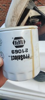

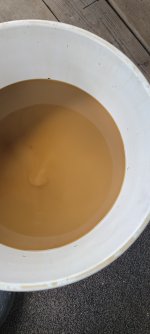

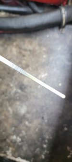

It would be nice to see the oil that you took out of the engine.
After you run the boat, it would be good to remove the spark plugs to see if you are getting any water in the cylinders.
The battery may be bad, so see about getting a new battery.
I drained the new oil that I used to flush the system into the same bucket so it's darker than it did look. The dipstick pic is the color it was.

You need to at least get the old milky oil out of her, take out the plugs and get what you can out of the cylinders and put some fogging oil in there. Letting her sit with water in the engine is not good. I had a similar problem one time, turned out ti be a tiny hole in the exhaust manifolds.

Take off the oil cap on the valve cover when the engine is cool & see if there is a mayonnaise like deposit clinging into the valve cover. That’s a sure sign of water in the oil. That will show it more accurately & sooner that on the dipstick. Your dipstick oil doesn’t look bad but the oil that was drained looks milky.
