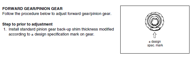

Are you not seeing in your service manual how to go about selecting the pinion gear shim and how to test for backlash?
Begins with something like this

To be honest, I do not have a Suzuki manual. Yamaha is similar and looked it over in the 7-33-34 and talks about the backlash. I may have not been clear in my question but was referring to the pinion gear only not the upper bearing cage just under the oil seal cover.
My Yamaha in comparison to the Suzuki has little different inners.. sorry
