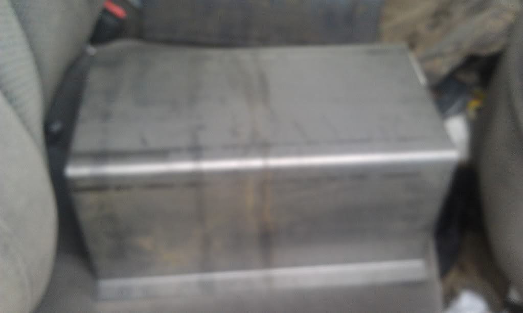

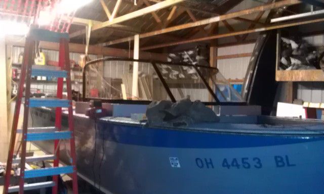

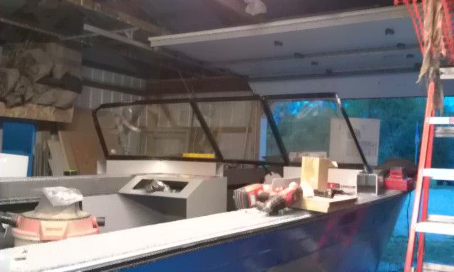

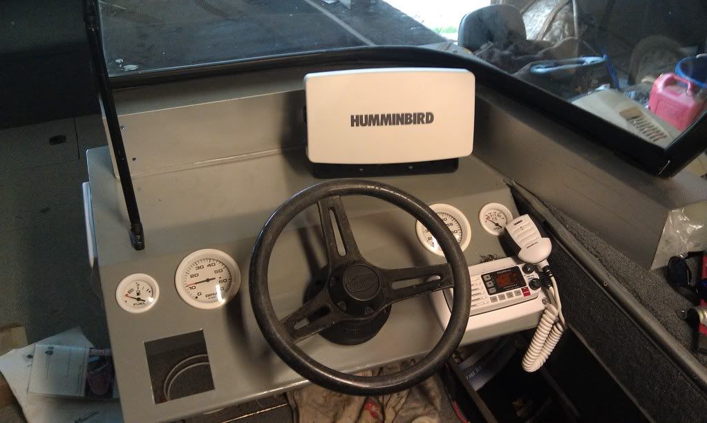

Went to install the windshield i picked up for it, but when it sat on the consoles it seemed really low! I wanted to raise it up, much like you see on alumacrafts. Here is what I came up with. Its not the prettiest thing, but it was cheap and raised it 4.5" so my melon isnt above the glass now!
4.5"x4.5" aluminum square tube, with shear blocks rivoted top and bottom, plus a nice lathering of DOW cws on the inside to help "hold things together":D
Ill try to get some better pics of it up.

Also mounted the bird gimble and drilled out access holes for wiring. Im liking it!

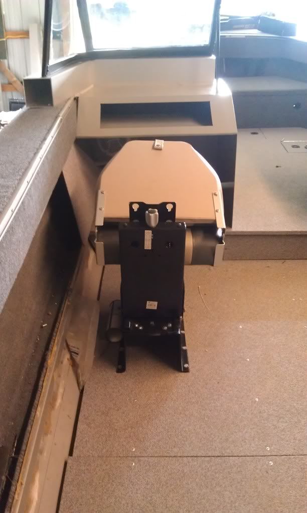

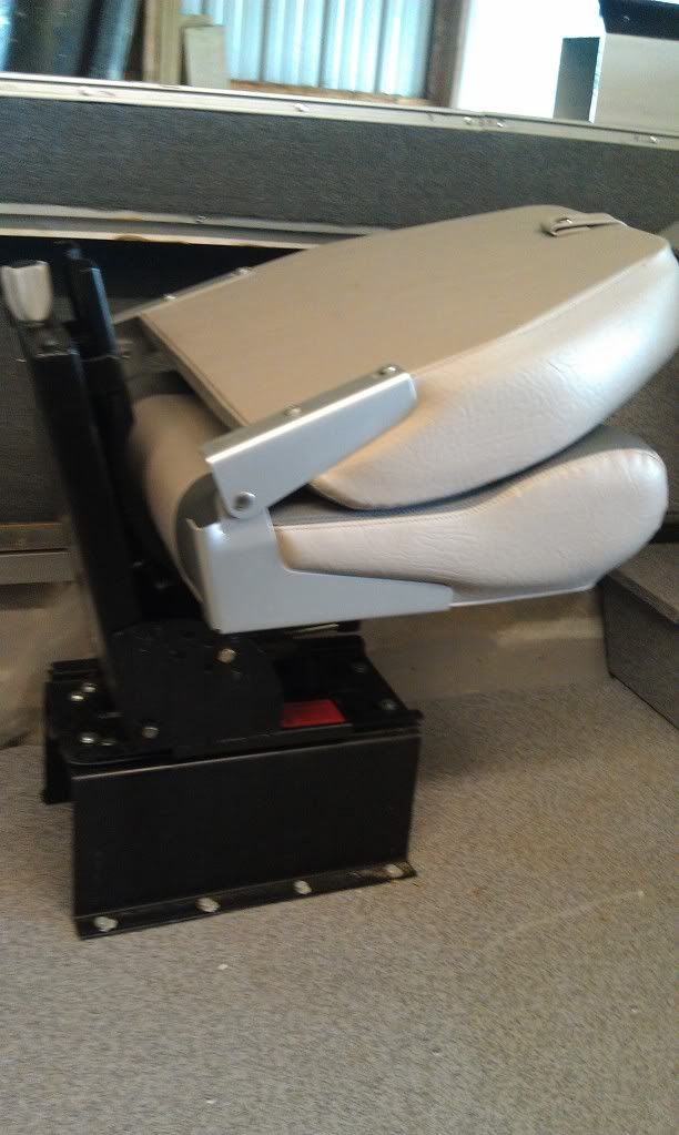

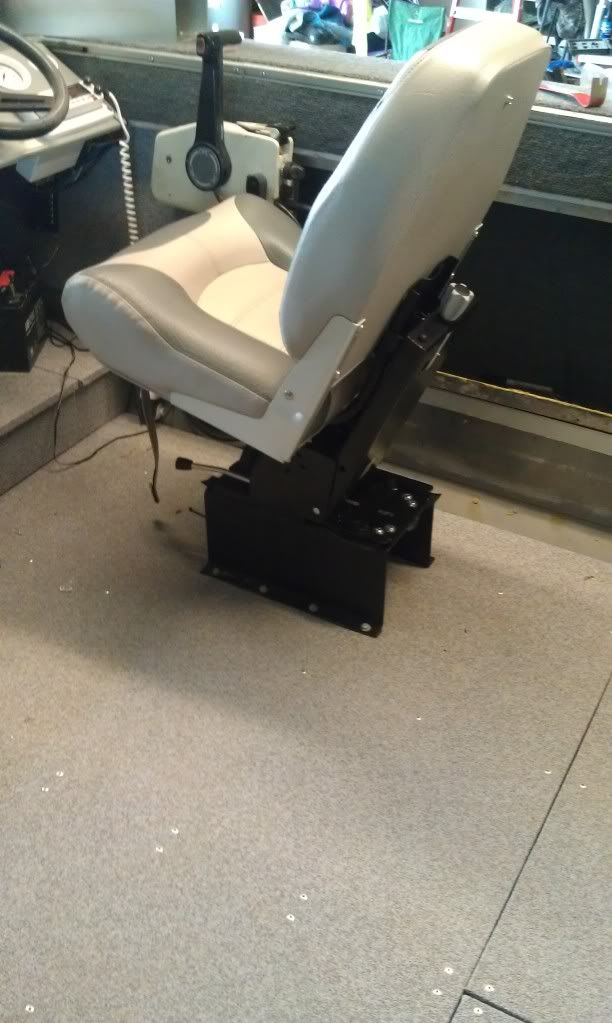

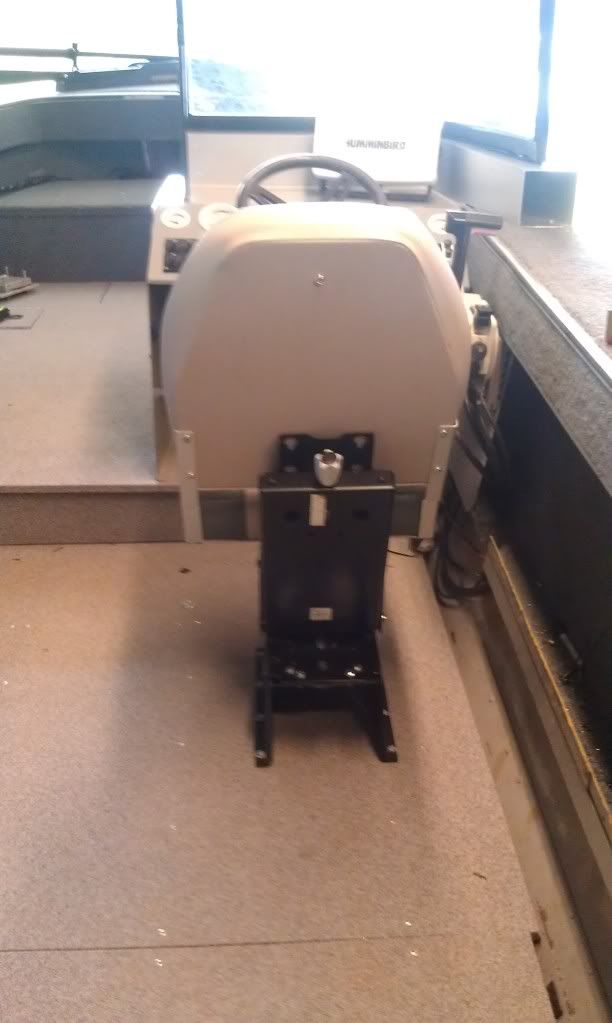

Those steel pieces were bent up and powder coated to be braces for my seats. I couldnt see dropping $400 bucks a piece for smooth moves plus buying seats on top of that, so I made my own. I bought the $99 tractor supply spring tension universal tractor seats and mounted them to the steel braces. Then mounted new seats from cabelas to the universal frame.

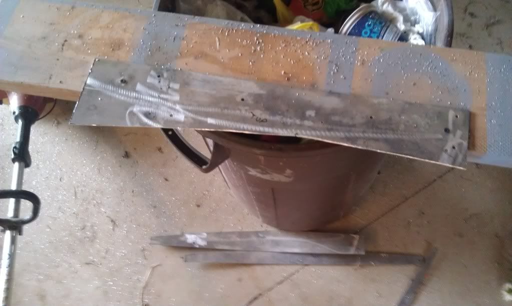

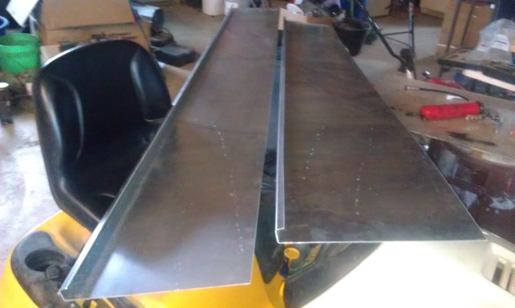

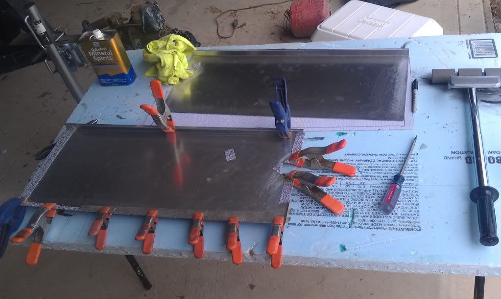

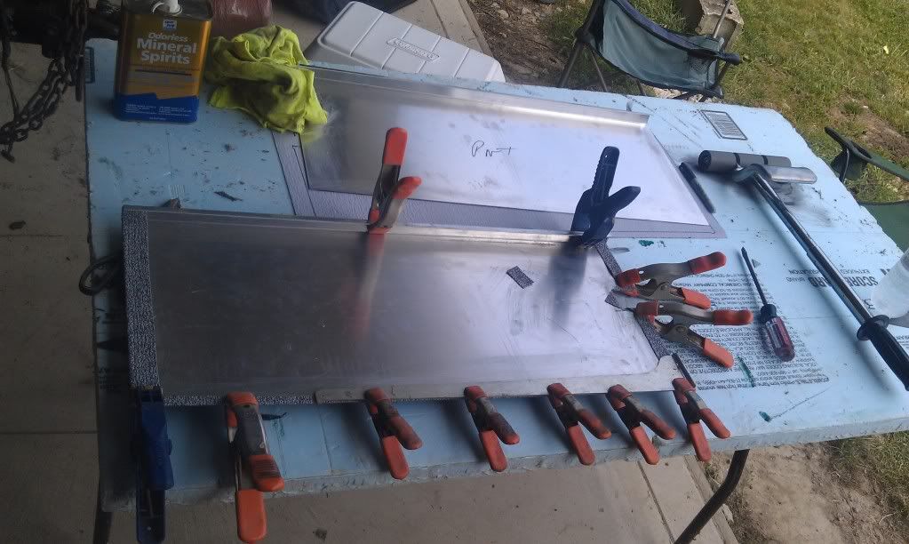

Had some aluminum bent up awhile back. Plans are to cover it in nautelex and use them on the gunwales.
Ran out adhesive and only got one piece done. Here is gunwale without

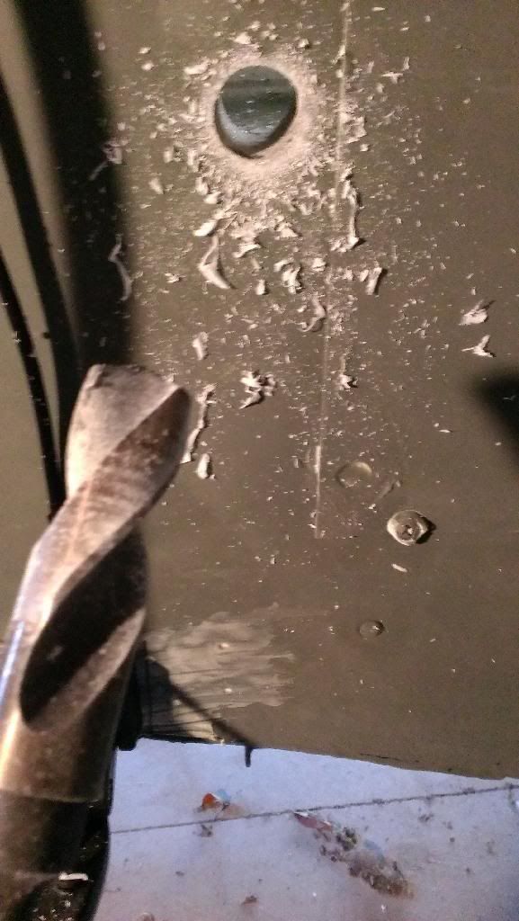

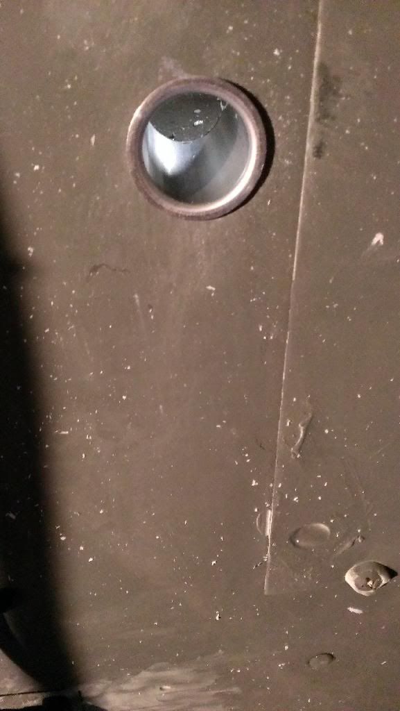

Drilling 1" holes in your boat is fun:eek:
Drain tubes for the backsplash well
