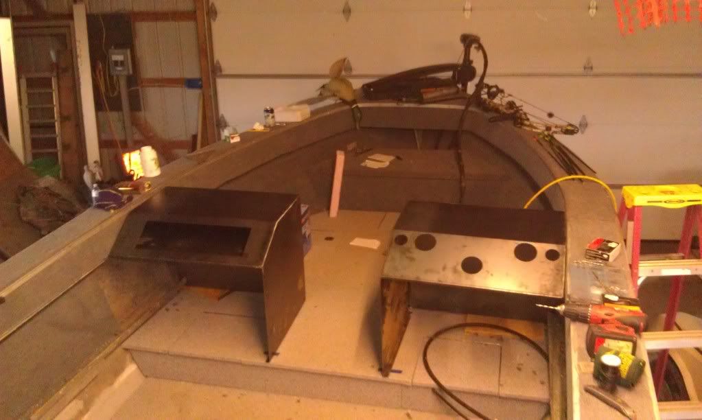

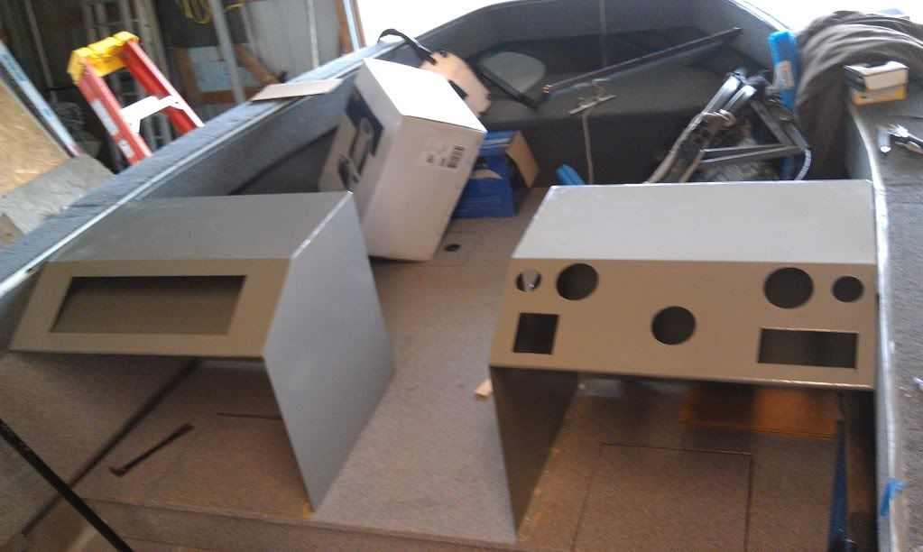

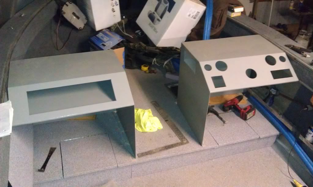

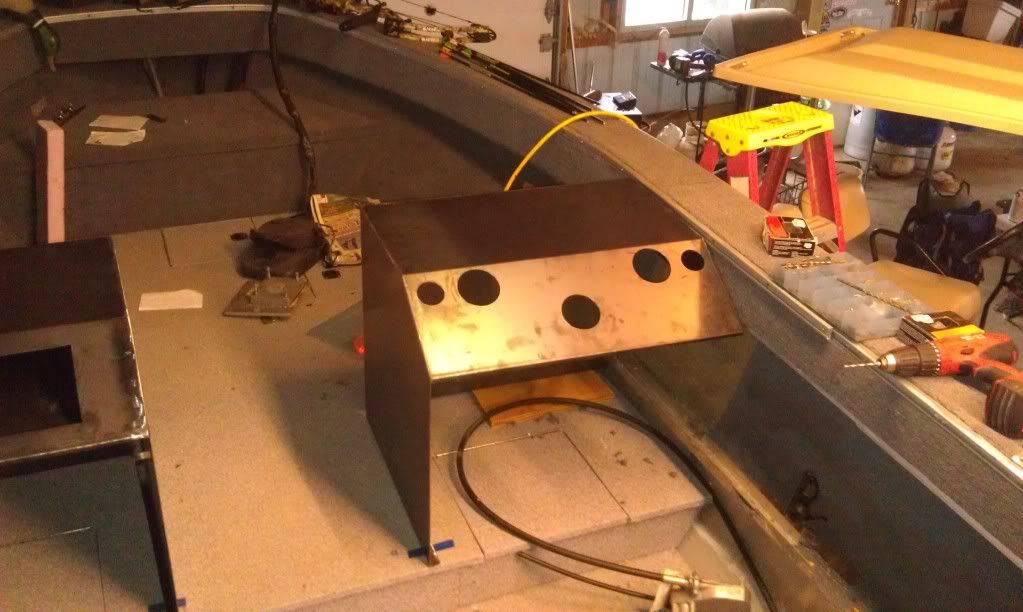

Well, its been awhile, I havent totally forgotten my project lol. I finally got my consoles built!
I had it priced out to powder coat them........:facepalm: Looks like im just gonna have to paint them!

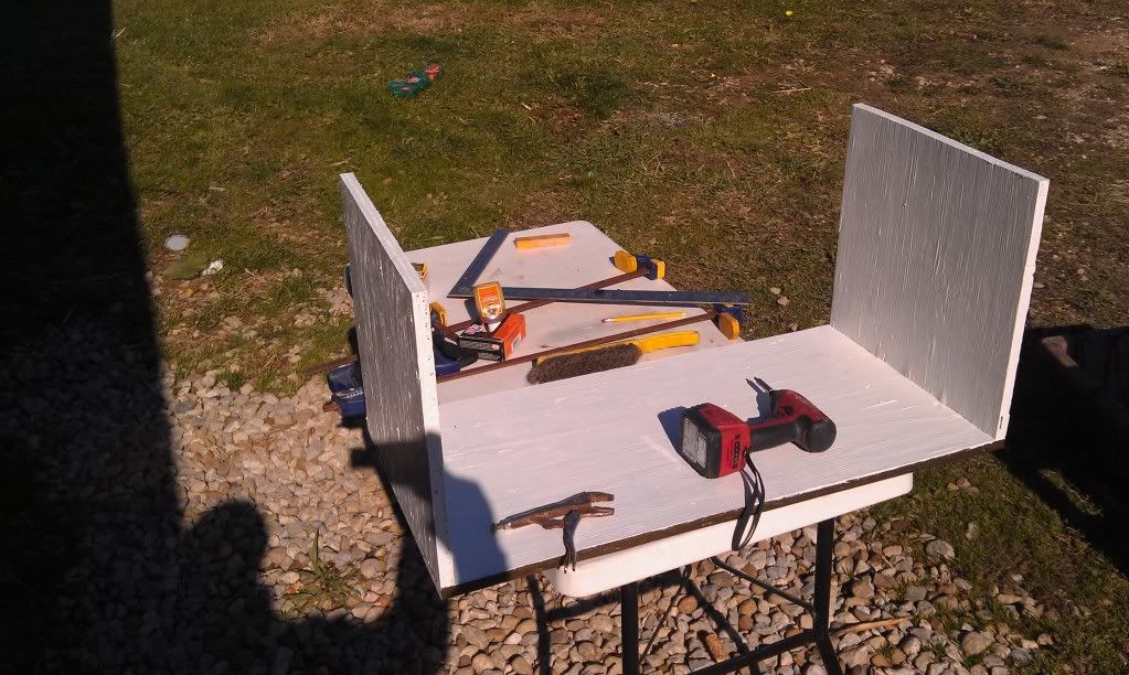

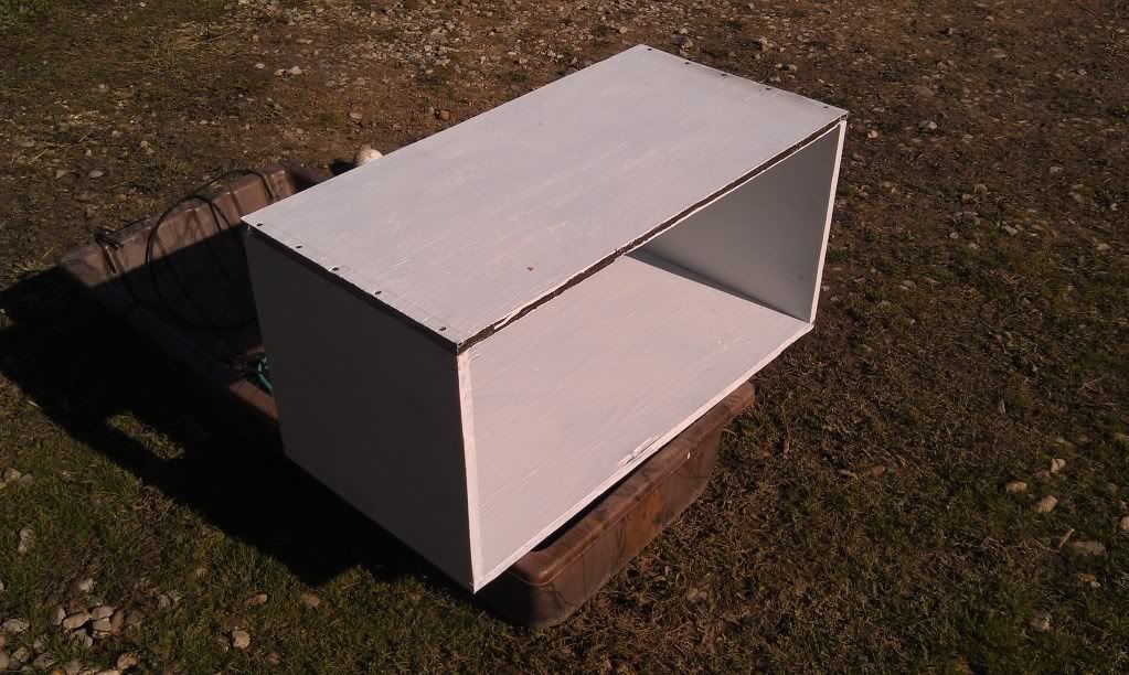

Ive also started making some bench seats. I decided to make them large enough to store 55 qt coolers in them.
I have some hinges that I think will work, but im not sure exactle how i need to attach the top seat/hatch. Also not sure if what i want to cover them with! I will def have cushions on top though!

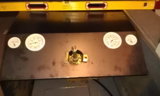

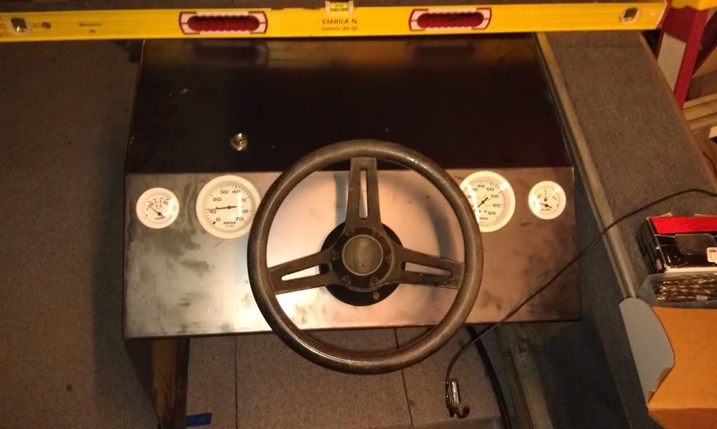

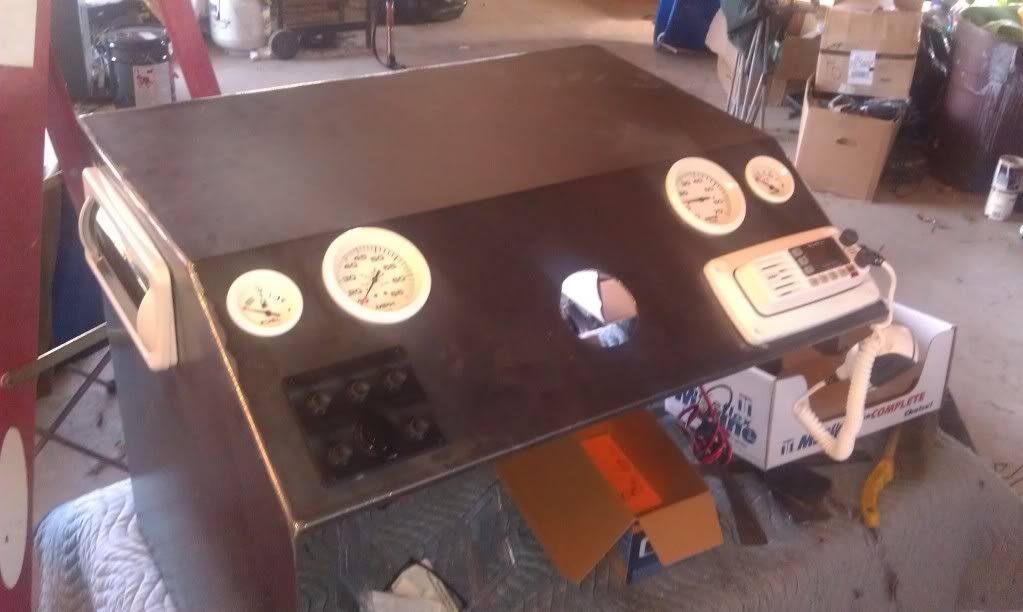

Had a little extra time so laid out fot the switches, vhf, and cd player and cut those in yesterday. Hoping to get these consoles painted pretty soon and installed.

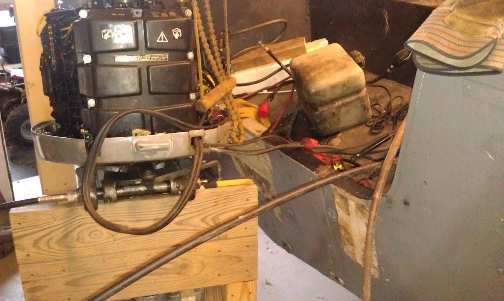

Well, I just got back to working on my rig. Its looking like im gonna have to pull that 175 and replace my transom. I swear im textbook for how to restore a boat backwards! Oh well, it is what it is. Uhhh transom question, How much epoxy do you guys think it will take to seal the new wood transom? I would hate to not order enough, but I really dont want a bunch of excess sitting around either!

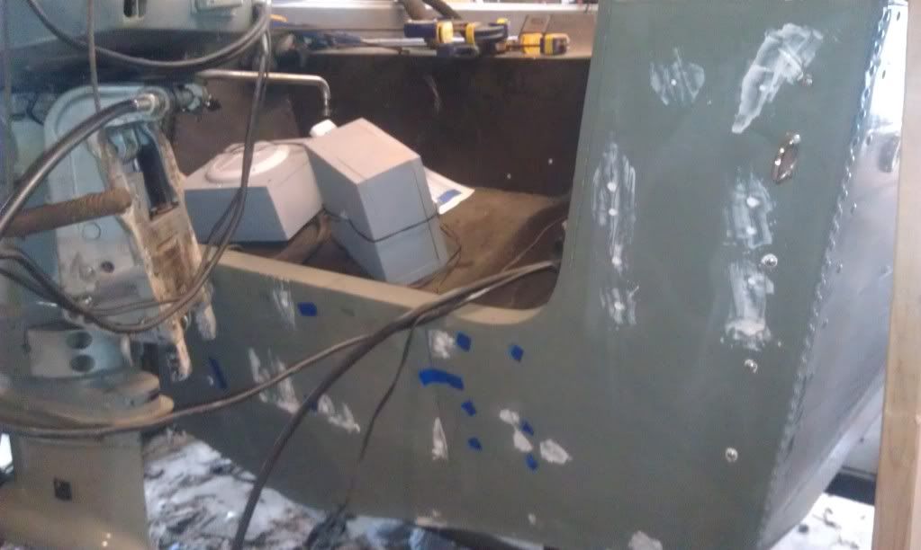

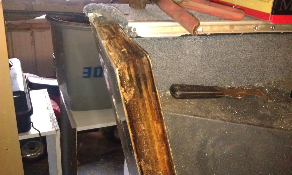

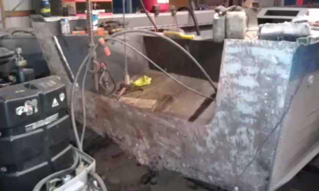

pulled the 175 off
this contraption came in handy

Re: 22' bluefin rebuild with some pics

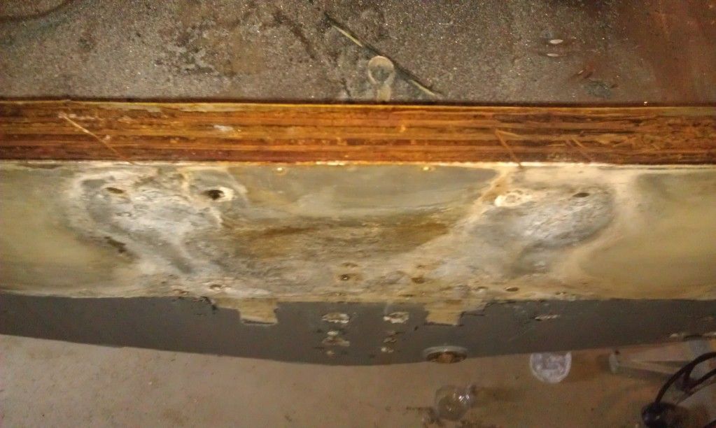

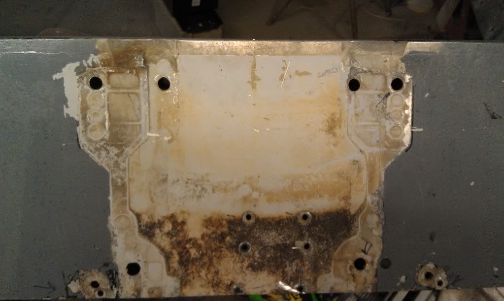

Glad I decided to do this! WORM FOOD!
64osby
Jul 28, 2009
6,826
Great call on taking a look at that transom. Certainly has seen better days.
Buckeyedude
Apr 4, 2012
238

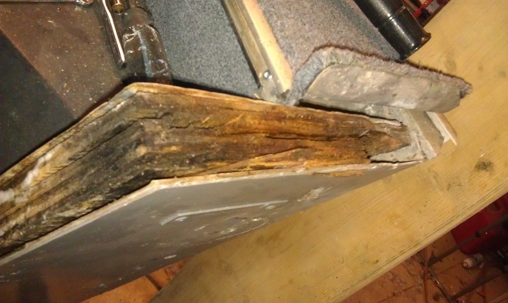

I REALLY feel bad for secrectly laughing at all the guys having to tear out flotation foam on thier restores. (Mine didnt have any) Now that my transom came out in literally wet splinters :mad: Took alot of digging and persistance, but got it all out!

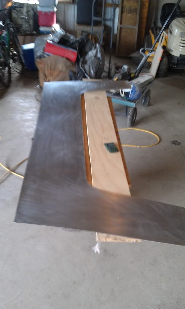

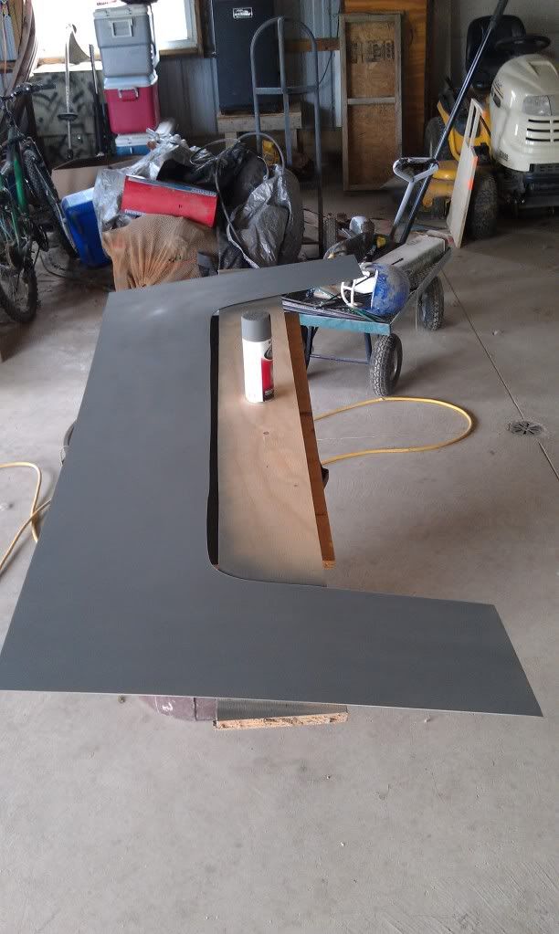

I decided to have a new interior aluminum skin sheared for me. The old one was terrible, tons of extra holes,( a big slice in it from me getting crazy when trying to remove it)etc. It is just bare aluminum, is there anything I should put on it before re-installing?
Buckeyedude
Apr 4, 2012
238
Update. Took my new aluminum skin, wiped it down with mineral spirits, then a good dousing of vinegar and water, scuffed it up little
Then used rustoleum self etching primer on it
Been filling predrilled holes and coating new transom with epoxy. (in the basement for temperature purposes)
There ias some oxidation on the inside of the alum transom, so im planning on cleaning it up with mineral spirits and a bath of water/vinegar also. Once the exterior is sanded down and wood transom is installed,Ive got ALOT of extra holes to fill in. I was thinking on using jb weld so I can sand it down for painting, unless there is something better I should use?

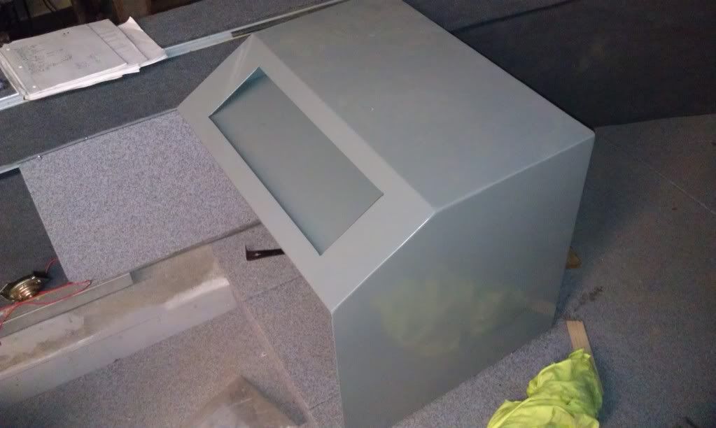

some update pics!

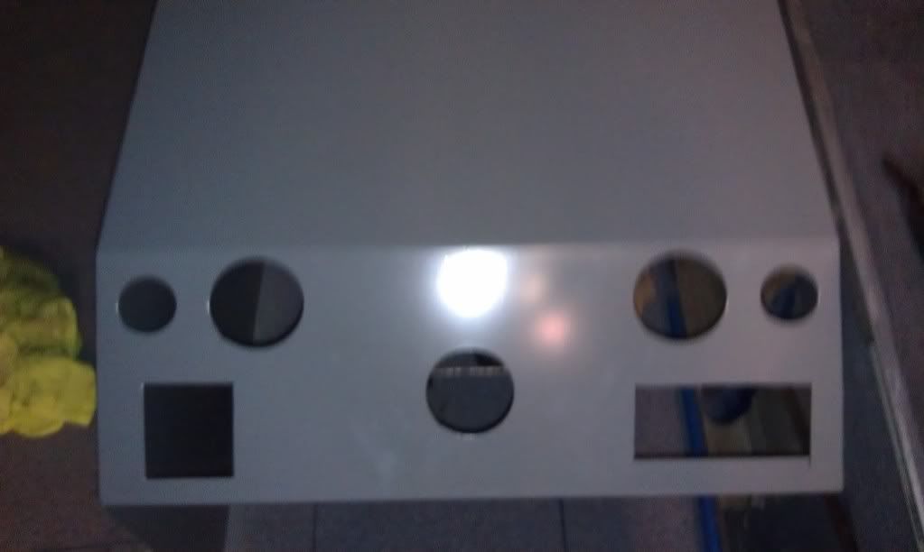

First off, I got my consoles powder coated and installed:joyous:
jbcurt00
Oct 25, 2011
25,262
Nice looking consoles. I like the under foot storage below the console.

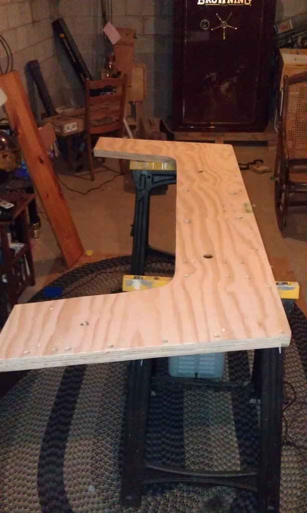

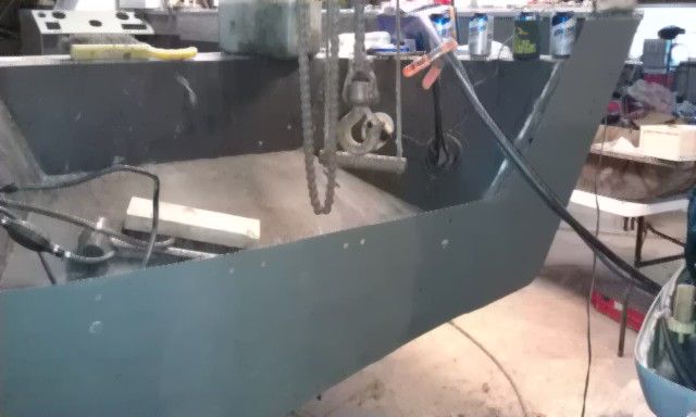

Transom is installed, ended up going with several layers of epoxy, all holes were drilled out 2x the necessary size and filled up. before installing it, I went ahead and gave it a final coat or two of some left ovwer dutch boy porch paint. I must have goofed on the thickness of the wood, it seemed super tight and ennded up pounding it down with 2x4 and sledge hammer the last 1/3 of the way! Made the u-shaped transom cap flare a little also:facepalm:
old
sanded down
fresh primer
marine epoxy filled in excess holes

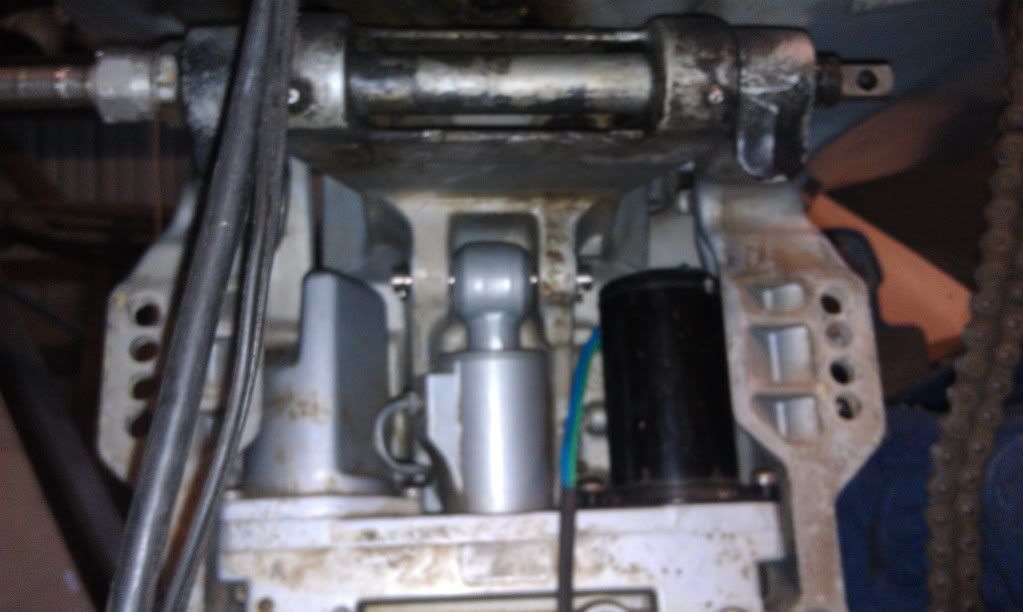

trim/tilt installed on motor
had to order new bolts and make a new outboard motor tilt pin from a chunk of stainless and some stainless cotter pins!
