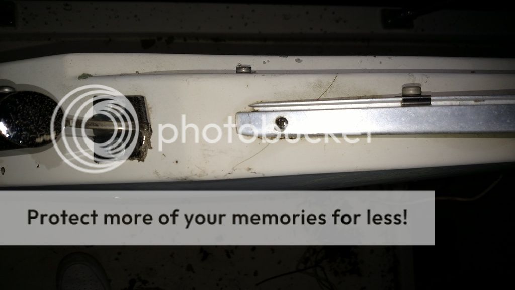

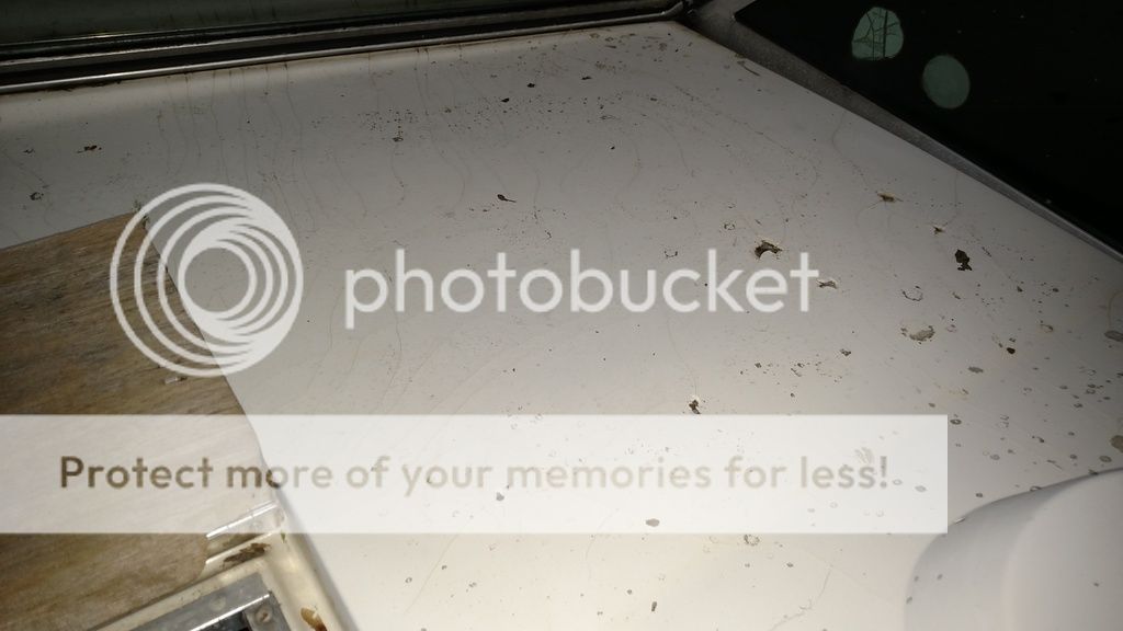

Here's a couple pi s of some of the cracking sorry it's dark an they suck I will try for better ones tomorrow
URL=http://s485.photobucket.com/user/csadad/media/Mobile%20Uploads/IMG_20160718_210030946_zpswiddqycb.jpg.html]
[/URL]
Second Chance 248
Dec 28, 2014
132
The cracking on the dash is from a black material that Wellcraft used on the Sportsman model, the heat from the sun is what cracked the gel. The cracking around the window frames is from the screw holes not being countersunk. The window frames are fastened with screws, you'll have to take the weather stripping out to access them.
