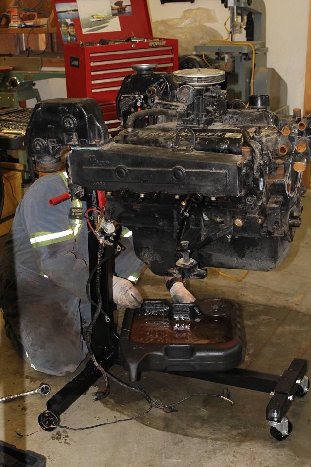

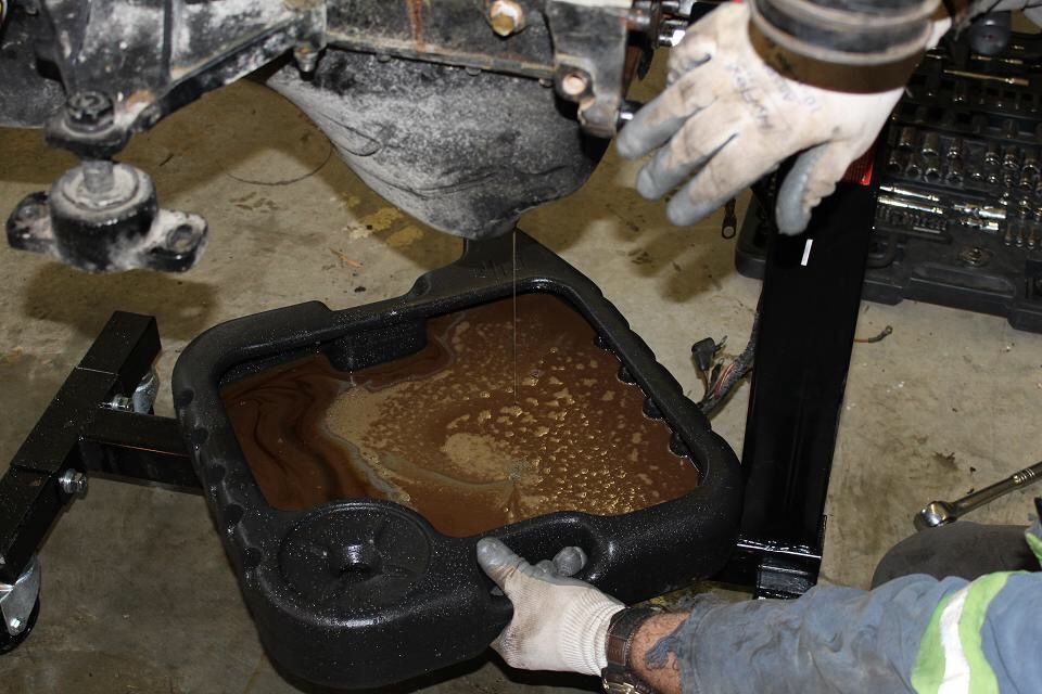

Well, got to tearing down the 888 engine today. I'm sure glad I bought a good engine stand. They are well worth the money. Took the engine right down to the core, and found no cracks visable to the naked eye, and no evidence of any water in any of the cylinders. All the domes on the heads look good, and the exhaust manifolds are not leaking internally. What dad and I think is that the intake manifold cracked (easily seen) on the thermostat housing, and that the intake manifold gasket failed, causing water to flow into the engine valley. In light of this, we are going to send the block to be magnafluxed and go from there.
Anyone for a milkshake?
That's good news! I wish you guys the best of luck. Hence why some of these guy are adamant about going through the proper procedures to determine what's wrong, rather than throwing money at things hoping it's what's wrong!!
Sounds like a weekend project now!
~Brett
