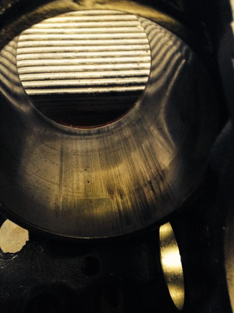

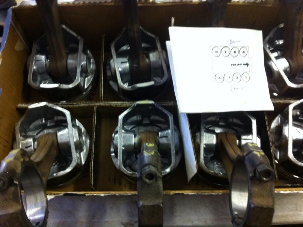

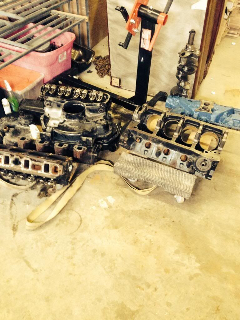

Some other pics of the tear down:

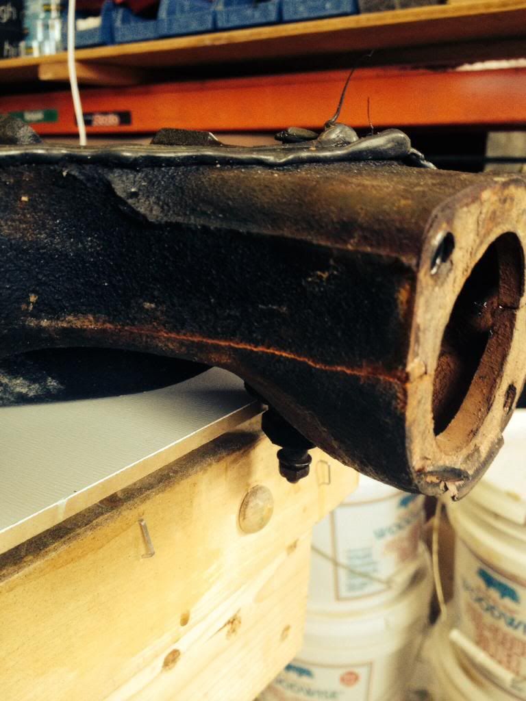

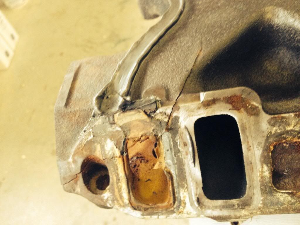

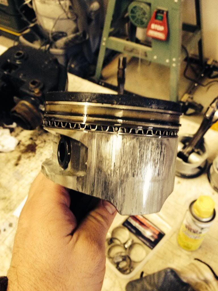

Here is the culprit of the water making its way into the oil:

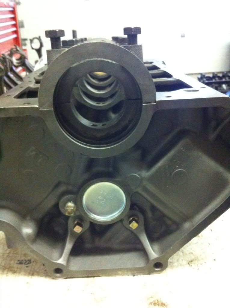

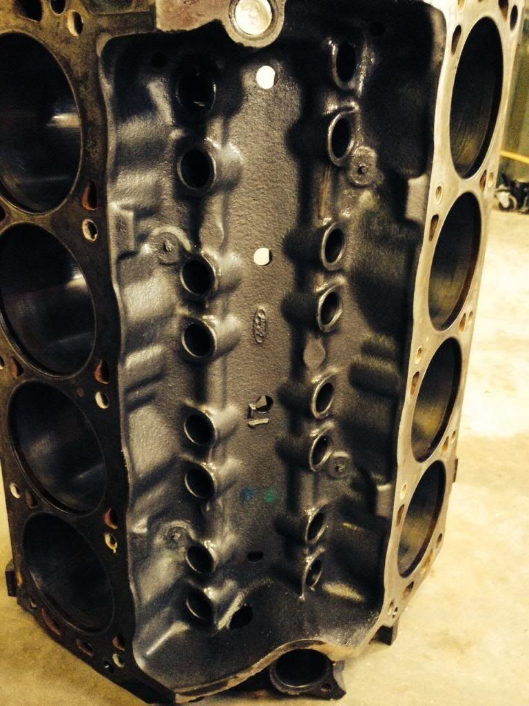

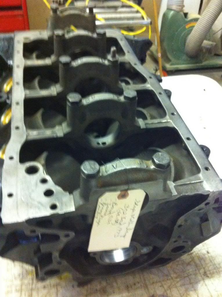

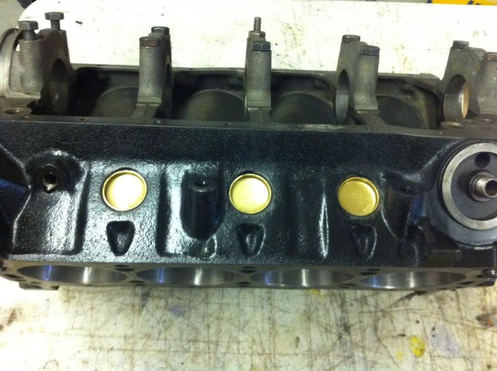

Instead of paying to remove cam bearings, mag, bore & hone, re-intall bearings and core plugs, we got this block from the machinist for the same amount it would cost us to do all the work to the other one. Bore is +0.030"

Bondo
Apr 17, 2002
71,471
Re: 351 marine conversion
Ayuh,.... Cool,... Looks like a good solid start,....

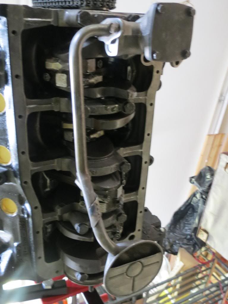

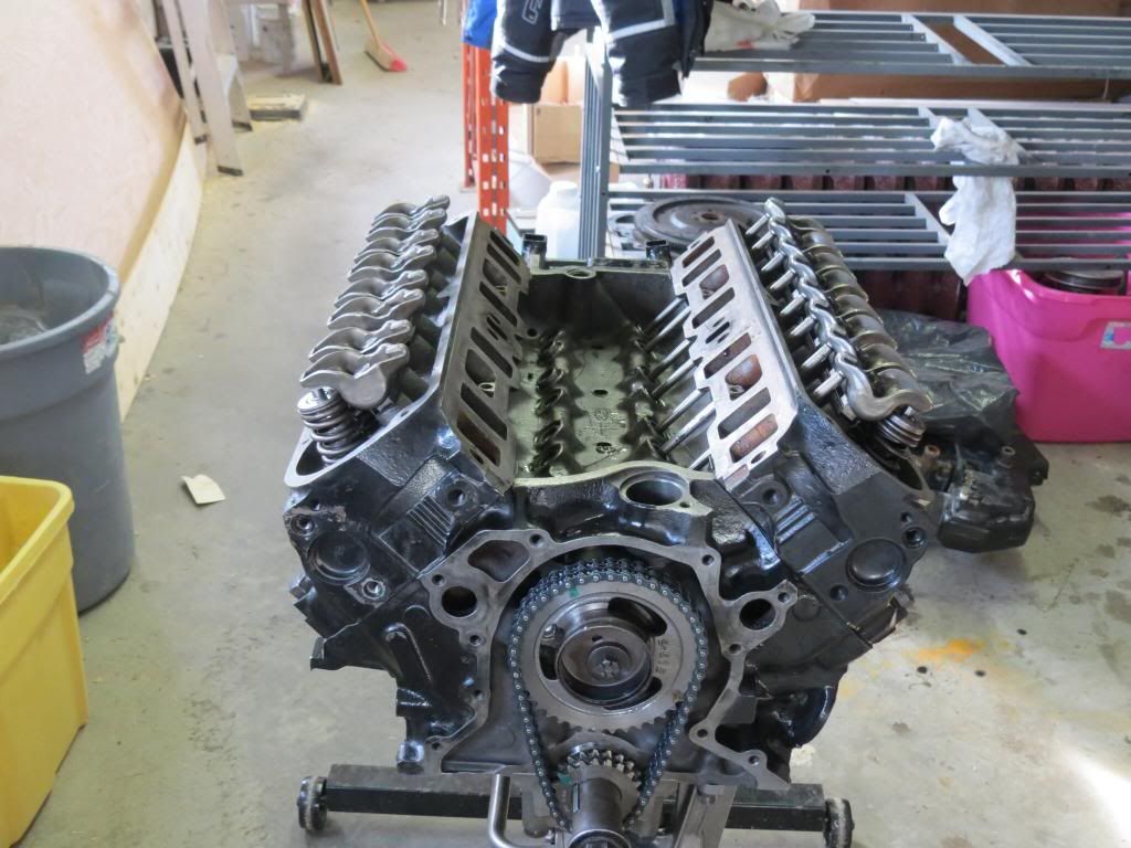

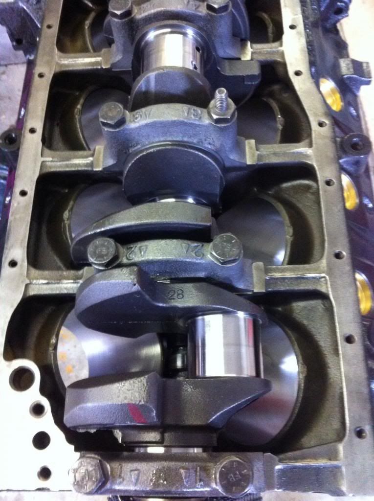

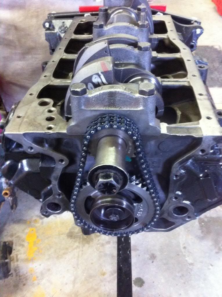

Officially got the build underway today. Crankshaft, cam, and timing set installed. I've learned tons just by watching a few people doing instructional videos on builds:
Kernallklink
Petty Officer 3rd Class
Aug 1, 2013
85
Re: 302 marine conversion

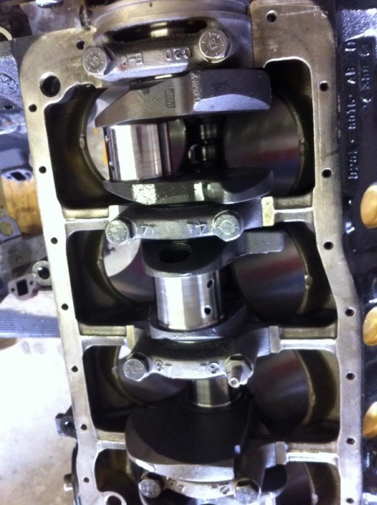

Some pics of the install.... Please let me know if anyone sees anything out of whack.
Rods re sized, pistons installed and ready to go!
haulnazz15
Mar 9, 2009
3,720
Lookin' good. Make sure to use the proper assembly lube for your bearings/journals to protect it prior to start-up.
Kernallklink
Aug 1, 2013
85
U betcha, used a liberal amount of Lucas oil semi synthetic assembly lube on all bearings, lobes, rear seal, timing chain, and fuel pump eccentric.

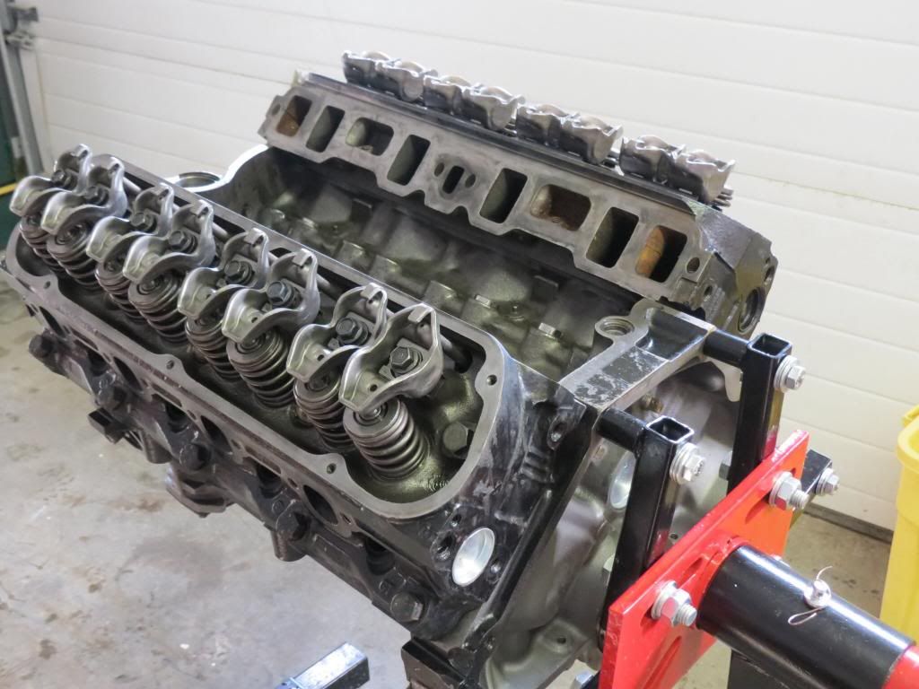

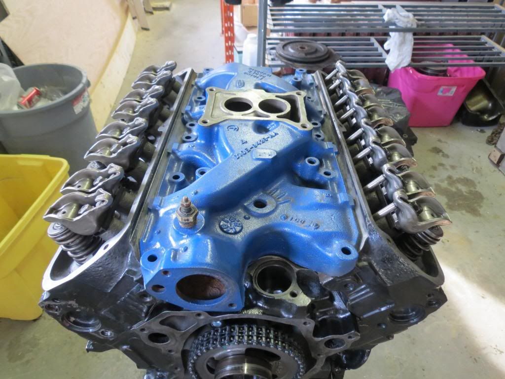

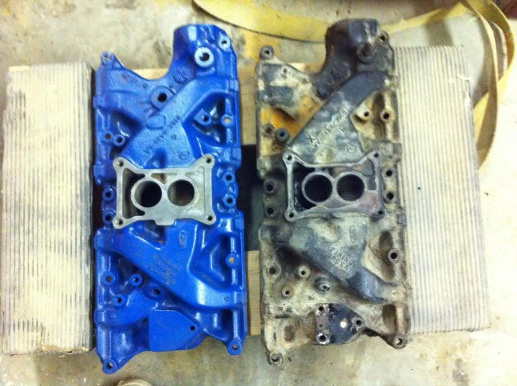

Moving along with the build. Did a little bit of inspection on the heads and I noticed they are stamped GT and have the 3 vertical lines on the front of the head. Some mustang forums identify these as GT40 heads. I'm not quite sure, but were these stock on the mercruiser 888?
I'll probably leave that intake blue, looks kinda neat.
