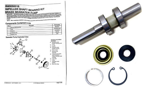

Found a kit that ought to work too new Merc part number 710-8M0140001, 'old number 8m0050018.
Search the part number online.

Have not taken one of that style apart but have rebuilt other style. If you have a press you should be able to replace the bearings
This is parts for ones I've rebuilt, cost was cheap. I found aftermarket bearings by searching on Merc numbers

If the shaft is good then using the old number yields a bearing set found in the first 2 options here, https://www.ebay.com/sch/i.html?_nkw=8m0050018&_trksid=p2334524.m4084.l1313&_odkw=8M0140001
Or order everything individually or search out Hardin marine sea water pumps for an stainless steel upgrade. https://www.hardin-marine.com/c-116-water-pumps-accessories.aspx
