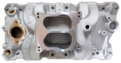

Yep… it’s a 1991; the long block was replaced in 2007 with a rebuilt, and that’s the original intake manifold. I don’t think they make this iron manifold anymore… “pre-vortec”, and I only have 1 inch clearance under the engine cover (i.e. deck), so I’m not sure if the vortec is a “high rise”, and whether it will fit.

You have to use the intake that matches your head design; pre Vortec heads require the pre Vortec intake. 12 bolts instead of the 8 bolts on the Vortec and the pre Vortec used the exhaust crossover.
They may not be made new but can be easily found used. I found a few good ones for my 4.3 pre Vortec but the original as I said is still fine. Check on eBay…

you can likely find a used fresh water one the dimesnsion listed for the marine edlebrock probably doesnt fit what you outline for height
