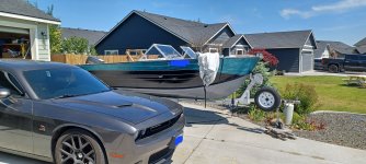

Not much in the way of updates due to car repairs taking priority. I did decide my final direction for the gunnels. If I patch the holes, putty or weld, and then paint, the finish will never look right. So it's back to a covering. The budget has inflated a little more, so I went looking for eva or vinyl flooring. I didn't like the vinyl colors, and eva flooring was too thick. I then found some 3mm eva sheet foam. I'll use this and contact cement, probably just give it a putty patch just cause.

Some progress.
Revised bow flooring is complete. Latches still needed. Then I sanded/countersunk/cleaned the gunnel holes and patched with putty.
Now I'm working on covering with EVA foam. There's some air bubbles, but I think I can fix that with more contact cement. It was a little sparse in areas. I'm not going to be too particular on this as long as it stays down. I might use this foam for the bow trim as well. Should stay cooler than vinyl and I can glue it straight to the sides.

Finished up the foam today. Had some more bubbles. I think my issue was not letting the contact cement dry enough, mixed with the foam being slightly oversized and under constant pressure. Redid those and I'll check them in the morning. It's not fantastic but better than a thousand holes. Once cleats, downriggers, and other things are attached it should stay down even better. While working on the bow I also came up with an idea to make a raised anchor caddy that I can also mount nav lights to, and possibly a spotlight and horn.

A couple progress pictures. Reattached dash and working on instruments. I will mount a gps speedometer and somehow hardwire it (usb powered). I also have a digital tach to hardwire (battery operated). I'll probably go the easy route and find an automotive usb outlet rated to the correct voltages. I got the steering wheel on and then realized I forgot the cover for the dash mount. I plan to just leave it until such time that I find a nicer steering wheel, because everytime I remove it, another crack in the plastic forms. Then I started a cover for the top of the dash, where I've cut clearance holes due to raising the dash. It's plywood glued to carpet, I wanted to use eva foam, but didn't have a big enough section left over. I'll hit the wood with something to waterproof, then figure out how I'm going to attach with screws. Not shown, I marked some sections to cut out for a glove box and also footwell storage. I'll get to that next weekend.

Anyway, I finished the windshield, wasn't careful enough and got a crack or two, should have cut larger clearance holes for tje mounting screws, time will tell if such screws were a mistake with thermal expansion as well. Also, careful of what plexiglass you buy, the material bought for my front windshields, while transparent, has lines/waves through it that obscure vision, we'll see how long I stick with these.
I added an anchor nest, not fully complete, and mounted the horn below it and spot lights to the sides. The nest still needs some uhmw guides and a roller, maybe this weekend. The glove box has been created, but I need to figure out how I want to hinge a plate for the door.
Otherwise, I'll call it officially splashed this last weekend. It ran pretty good, but trimmed out to far and got an overheat alarm, it then went into limp mode. I don't think there was any damage, but need to make sure.
