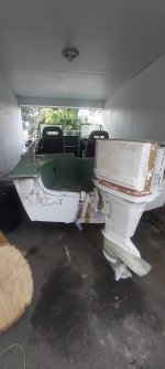

Im restoring an old Crestline tri hull. Came with a force 70 im guessing mid 70s maybe. It can with the wiring a mess, i belive i have the motor side good but having trouble with the ignition side of things. I looked up some diagrams and i thing i have the wrong ignition. The boat came with a push to choke and the diagram shows just a 6 post round. Ive wired it up a few different ways and all i get is a click when i turn the key. My skills in outboards is limited so i dont really know where to start looking. Any help

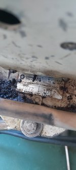

Nordin
Jun 12, 2010
2,698
From the pic this is a Chrysler from 1974 and up.
From 1974 they were rated 75Hp until 1978-79 I believe.
If it has the belt driven distributor the keyswitch should be as follows.
Red B terminal
Yellow S terminal
Blue I terminal
Green C terminal
The two M terminals are not in use in this ignition set up.
If it has the Prestolite magneto CDI ignition and that system was used from about 1981 and up it is as follows.
Red B terminal
Yellow S terminal
Blue M terminal
White M terminal
Green C terminal
In this set up the I terminal is not in use.

Chrysler motors came with a tag on the bottom/inside/front lower cover.
That has model, hp, serial#. post that info ?

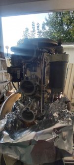

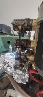

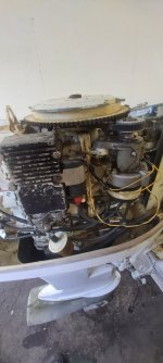

What ignition-system do you have? this?
I dont think thats it... Theres some parts there i dont think are on mine and i know it does have a belt drive distributor thats not in that diagram. Ive put up all the pics i currently have one me, i can post more if needed
The Force power
Feb 3, 2019
2,359
Judging by the Rectifier...I'd say it's the second pic. I send
but many people have repaired/replaced parts on engines

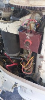

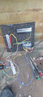

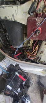

Well, check what Ignition system you have, send a pick of the ignition-system
Jmusick
Petty Officer 3rd Class
Sep 23, 2021
79
Hope this is helpful

Ive also found this mystery ground wire i can only assume goes to the starter as there is no ground to the starter
jerryjerry05
May 7, 2008
18,196
1969 70hp.
You need the switch with the push for choke. Sometimes WD40 sprayed into the switch can revive the old switch, spray activate , spray and repeat.
Starter is grounded through the 2 bolts holding it in place?
Pic of the wire in question?
When taking pics, get closer.
