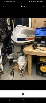

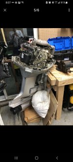

Sorry guys... I gave up on her. I sold the motor last night and bought a evinrude 125. I took the easy way out, but i have hit the limit of my abilities with this one. Wish me luck on moving forward with the evinrude. Ill keep posing updates on the project for those who stay interested
Jmusick
Petty Officer 3rd Class
Sep 23, 2021
79
Hoping for the best with this one
39,781
So now you have a motor ( 1971 or 1972) with electric shift .----And a motor with an ignition system that is not in the top 10 on the hit parade------Nothing wrong with the electric shift if you understand how it works.-----Not easy to find a shop to work on those.
