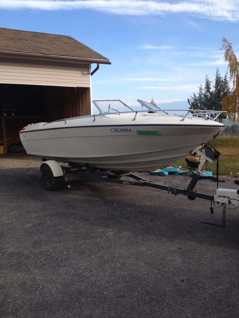

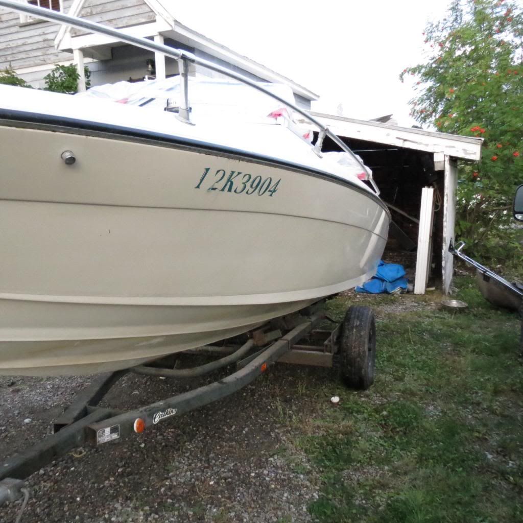

Hi all,

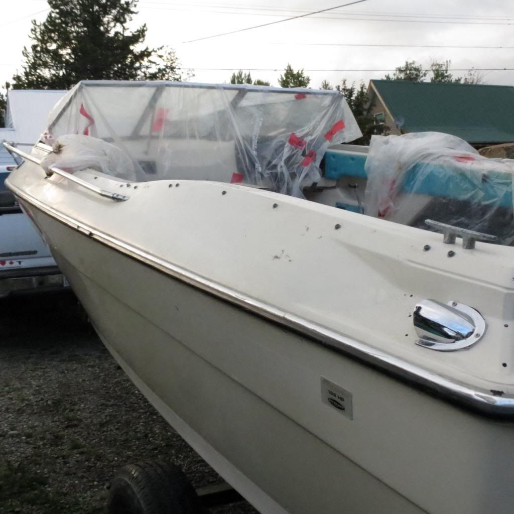

Here's how this all started. About a month ago, I just so happened to walk out the front door of the house and saw the neighbour outside in his driveway. Upon having some neighbourly chat, I saw the bow of a boat poking out of his carport. I asked if he was going to get it on the water, but he said no, she needed some work and he already had a bayliner Capri, and that he just wanted it out of his carport.
Now, me being who I am, became interested immediately and started to research the Internet. This is when I found this incredible forum, and started to read and watch. Particularly trooper, gwpsr, friscoboater, tbone, and zool. After arming myself with information, and gaining confidence, I convinced my father in law, and my sister's bf (who I will intro later) to take on this project with me, so that we can all enjoy this with our young families.
I assured these guys that we would not be alone in this project, that there is a large community right here that we can receive guidance from, and pass our skills onto others that may need help from time to time.
So, without further adeaux, here she is:
More to follow soon

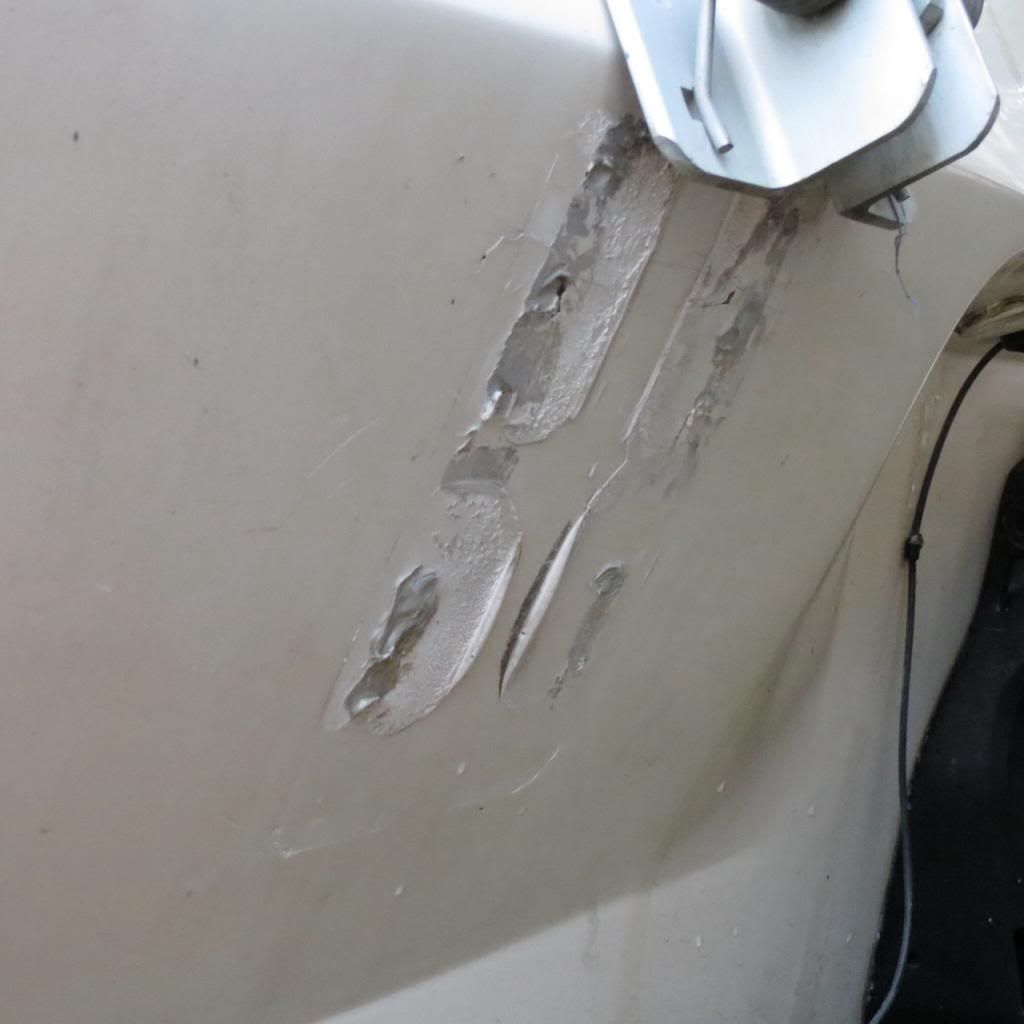

Here are some other pics of work that needs to get done:

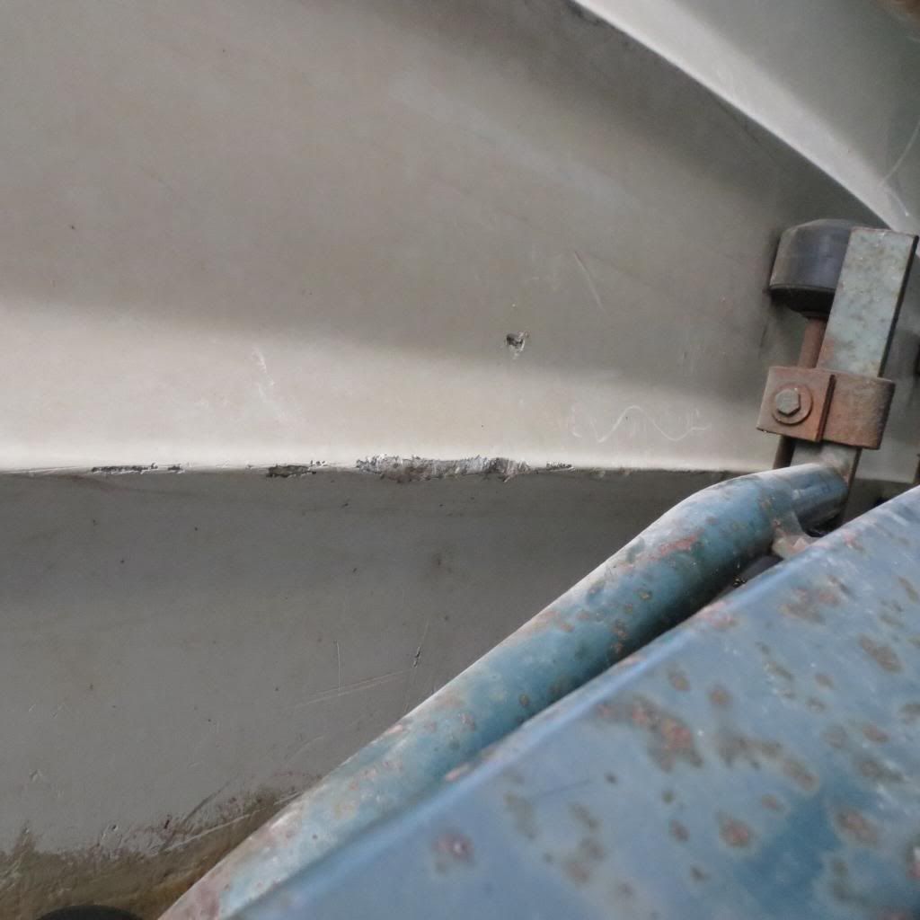

Some glass and gel coat repair on keel
Some gel coat repair here and there

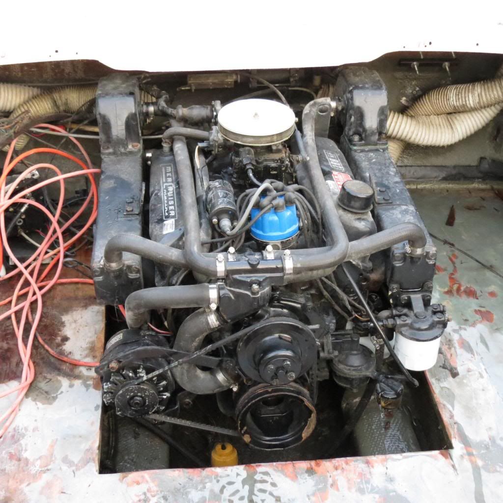

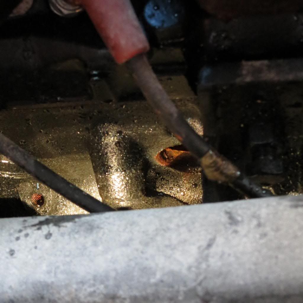

And the big one: the frost plugs on port and starboard of the block are popped, but no evidence of cracking on the exterior of the block. I'll have to test run it after replacing the plugs....crossing my fingers.

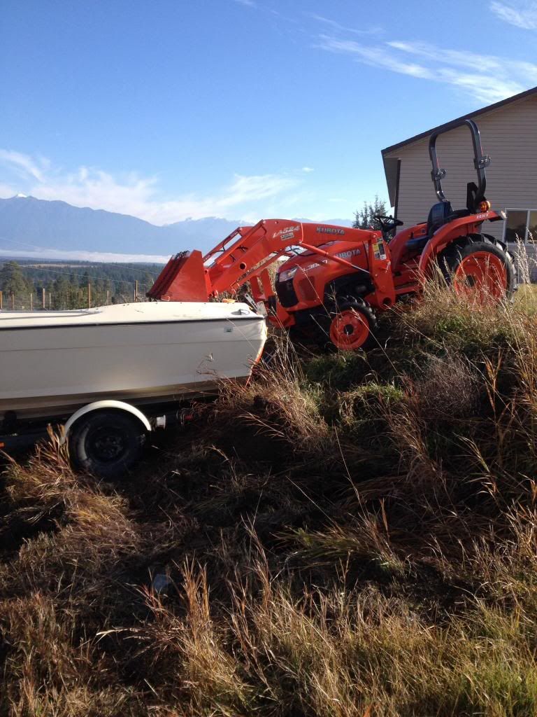

So after hauling the boat to its new home at dad's shop, we were finally able to do some brainstorming over the last couple of weeks on how the work will progress, timeline, and some particulars on paint scheme and overall desired look.

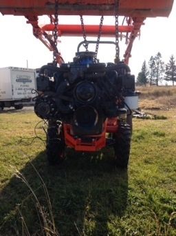

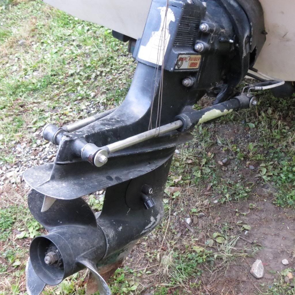

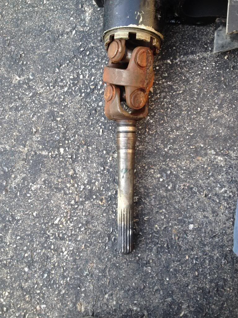

Today dad and I removed the mercruiser 888 outdrive, and found about a cup of water in the bellows. I'm wondering if this is normal, or is there possibly a leak in the bellow. The universal joints were wet, but still looked, and felt brand new.

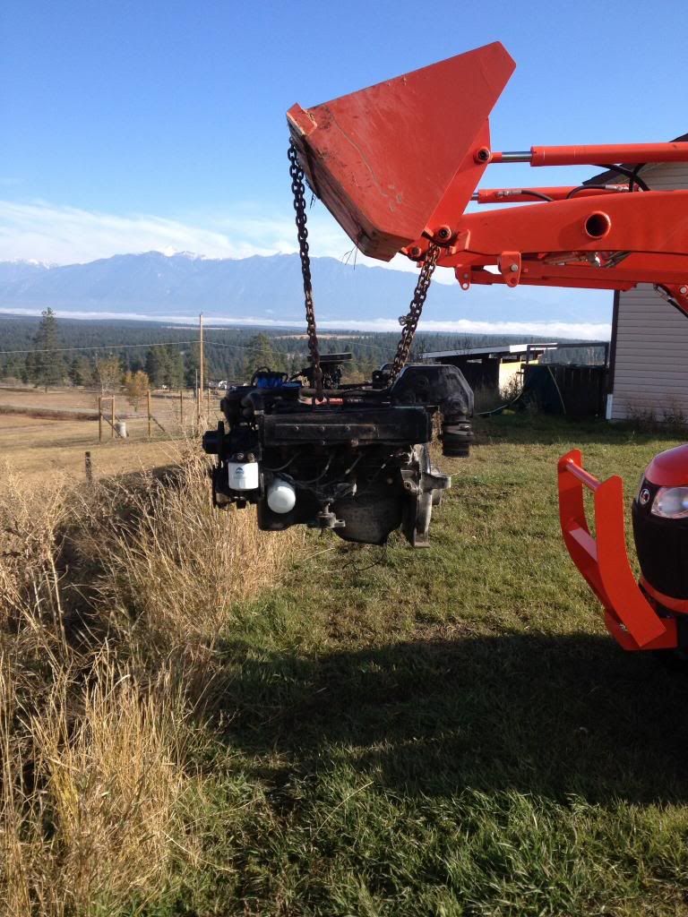

We got the engine mounts unbolted, and all the cables and hoses removed. We were just about to hoist the engine with the tractor bucket, when the admiral and crew loaded up to head home, so the kraken will have to wait till next days off.
Anyone have any suggestions on how to flip the hull? As soon as the engine, gimble housing, windshield, and rails are removed, we are going to flip this sucker to start the hull repairs.

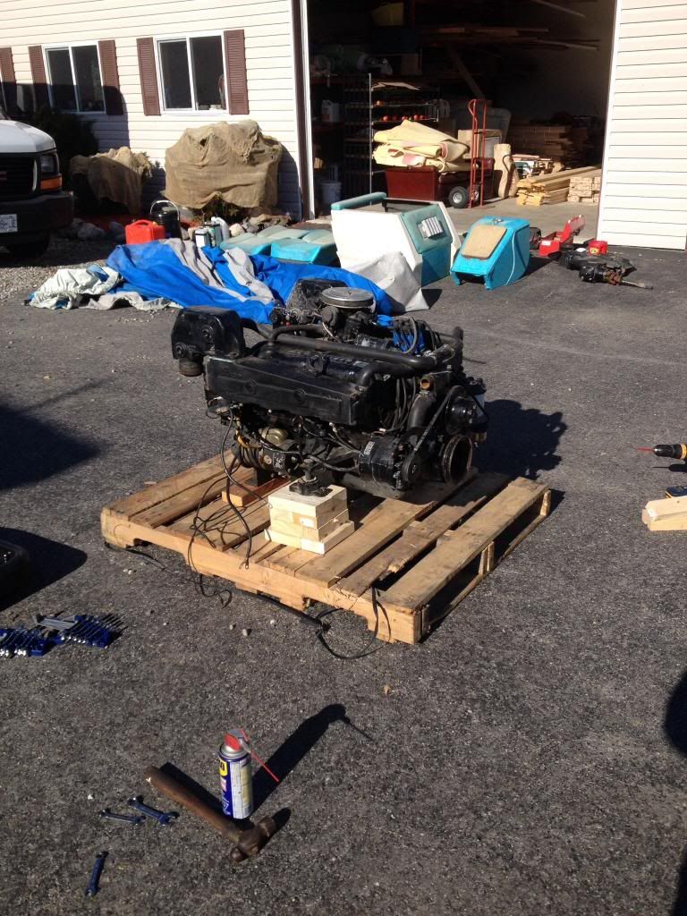

Today it was finally some nice weather so I got out to do some work:
Here she is at the new home
Dad trying out the new name

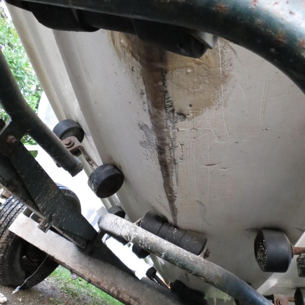

Here's the outdrive with the rust I was talking about...I'll have to check out the bellows closely

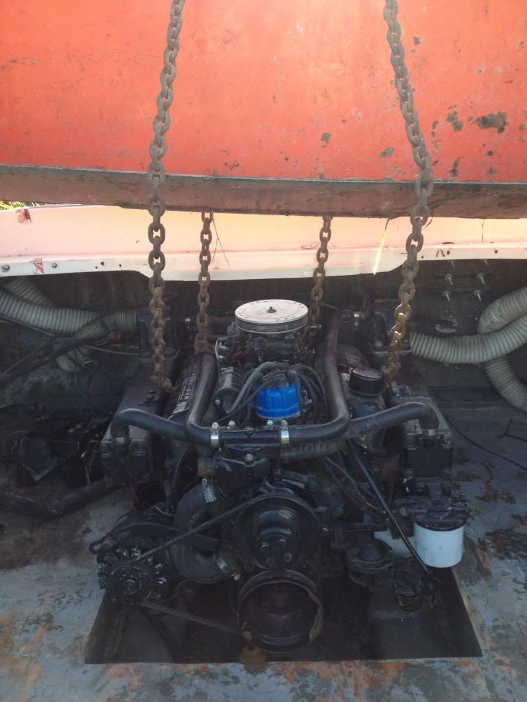

Getting ready to pull engine

Kernallklink
Petty Officer 3rd Class
Aug 1, 2013
85
Re: 75 reinell v1901 project "kraken"
All chained up
Re installed the frost plugs, and changed the oil, but ran out of time to get it started. I'll get er done next time, and I'll be sure to video it for everyone.
that 4th pic is great on so many levels - looking forward to seeing your continued progress and learning more

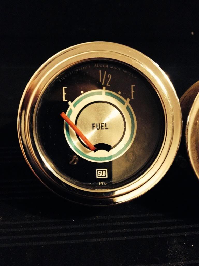

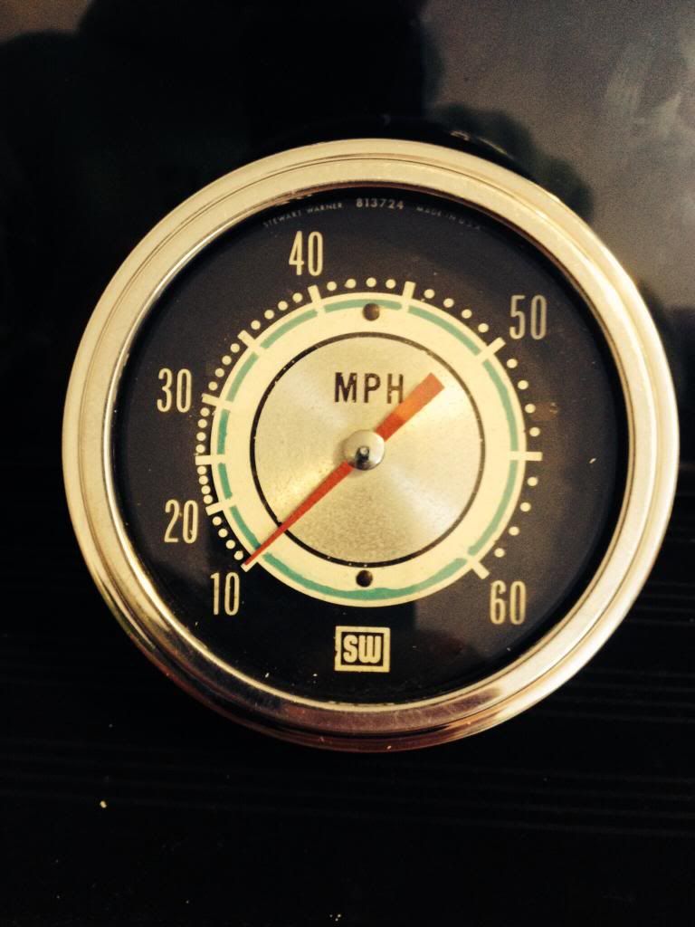

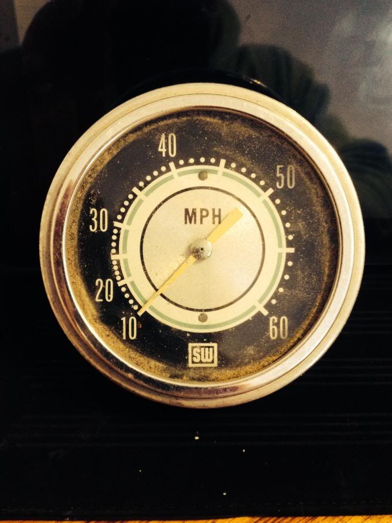

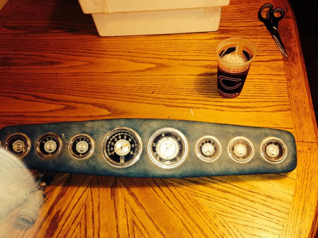

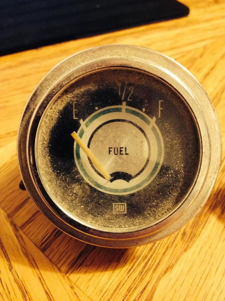

Hello all, now that it is officially winter up here in the great white north, I'm stuck indoors. Not a problem though. There is still other work that I can do to the boat. I decided to take a crack at restoring the instrument cluster that came as a bonus with the boat.
I did a little research on the instruments, and they are stewart warner from the '60s
Before
After.
I'm in the process of doing them all now. I'll post some pics of the complete set.

Got the speedo redone today.
Before
After

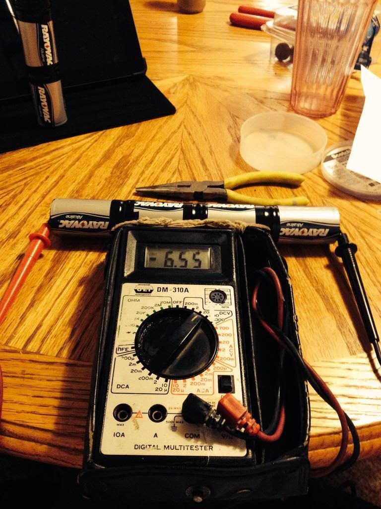

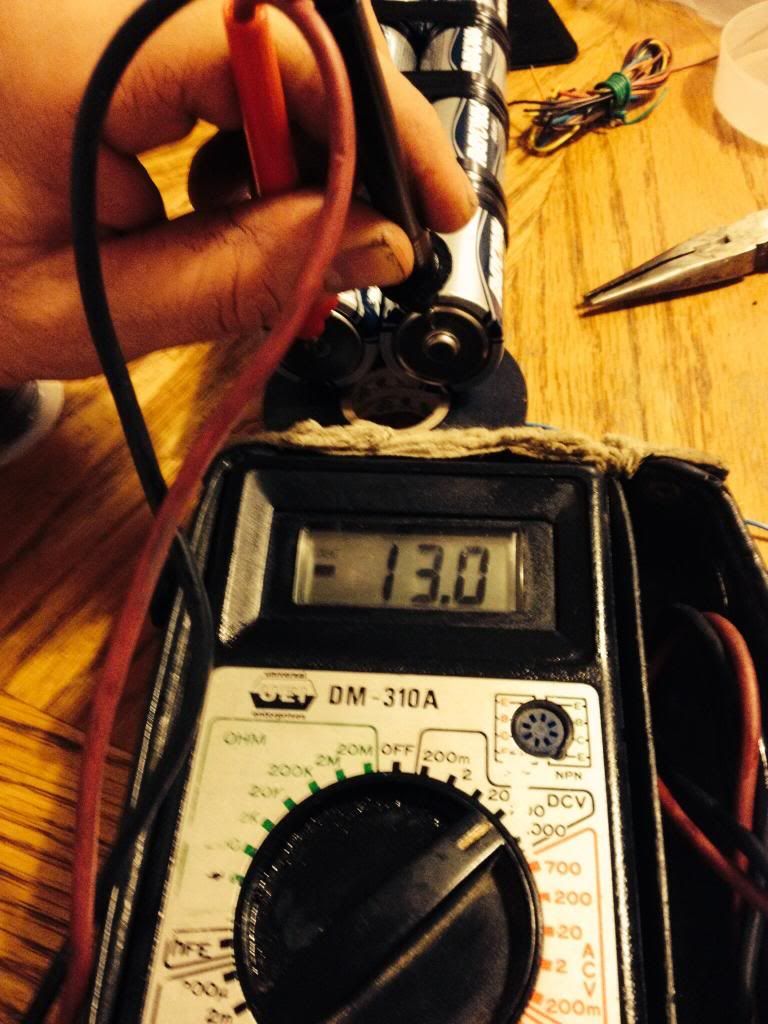

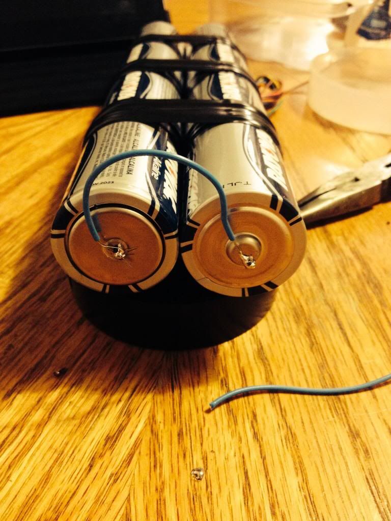

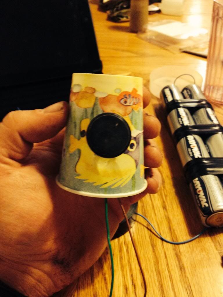

Happy thanksgiving to my neighbours to the south. Well, today was a pretty productive day. After a good 10 hour mine rescue practice, I got to building the bench test unit to check the function of the gauges.
Materials list:
8 - d cell batteries
1 - old citizen portable radio
Electrical tape
Multimeter
Dixie cup
Step 1: tear apart old radio and salvage potentiometer ( volume control), and bits of wire.
Step 2: connected D cell batteries in series to form 2 - 6 volt cells
Step 3: connected 6 volt cells in series to make 12 volts

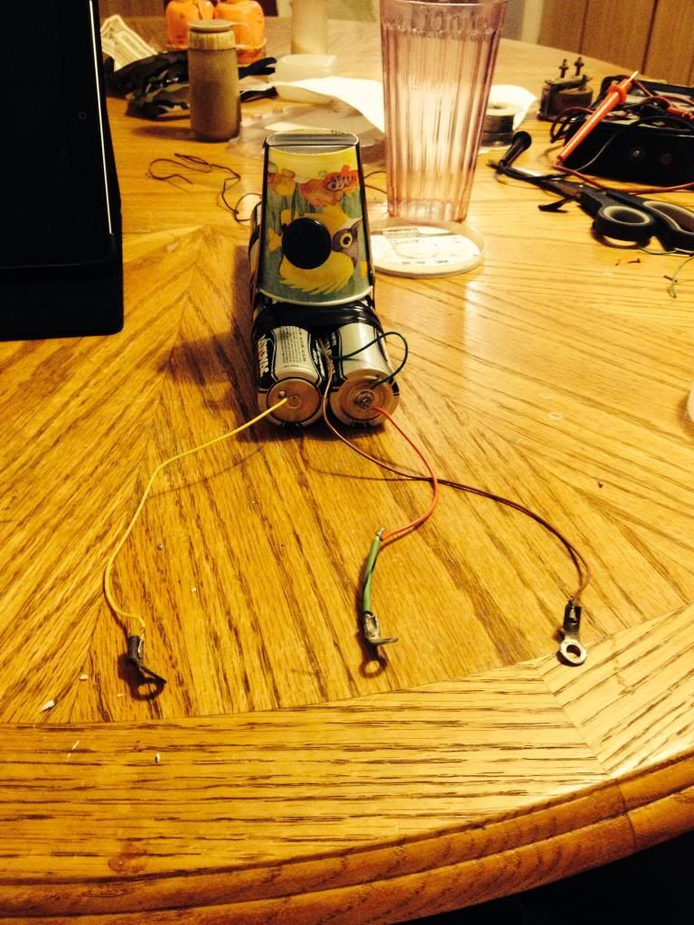

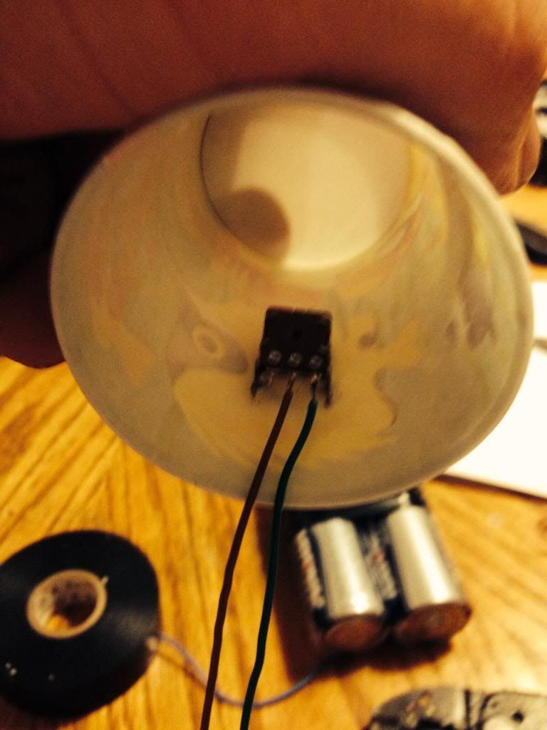

Step 4: solder leads to potentiometer and mount to Dixie cup.
Complete!
