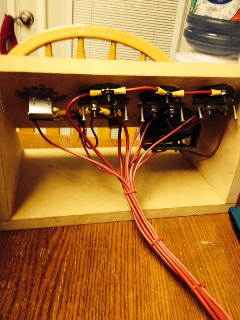

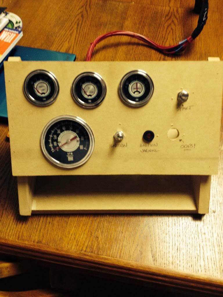

Need a little help here, I'm looking to test run my engine on the pallet, but I'm getting stumped on how I can build just a simple box with a 2 pole switch for ignition, and a push button start for starter. This would just be off of the engine harness of course. Maybe someone here could give me some guidance or a quick diagram. I have the engine wiring diagram from the mercruiser service manual 2. Thanks

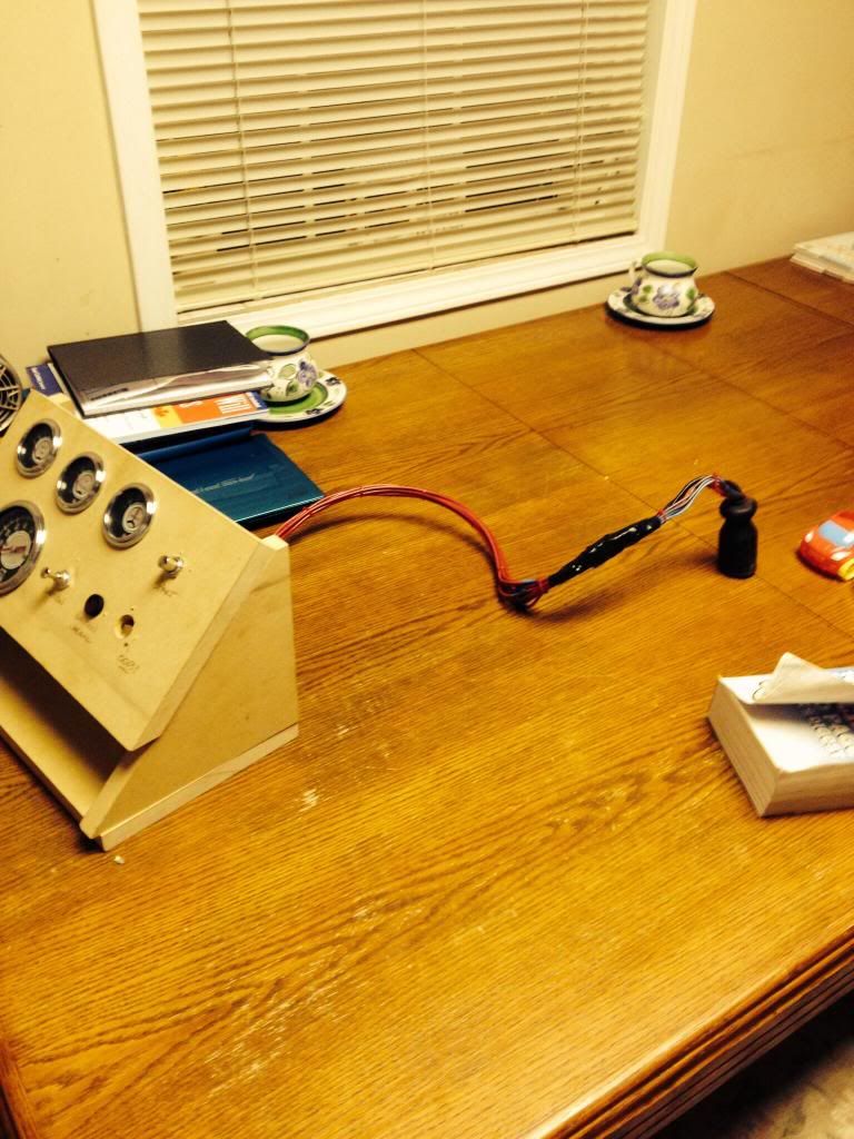

After doing some research and testing, I got the console finished for the engine run up. Dad and I plan to get at it tomorrow morning. Forecast is for -7c so we will have to be quick with water hook up and run, then get it back in the shop before it freezes. Crossing my fingers, can't wait to hear this baby roar!

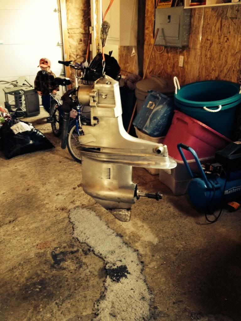

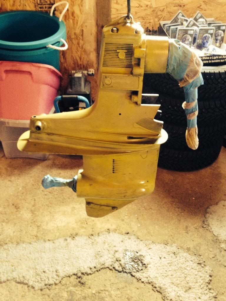

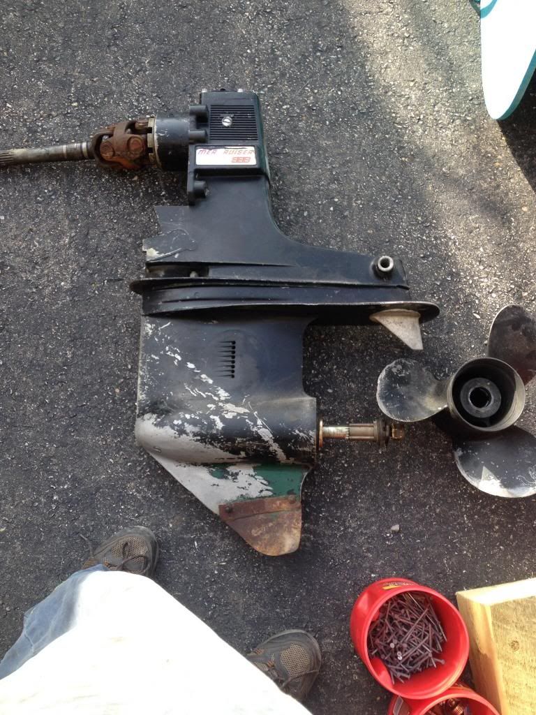

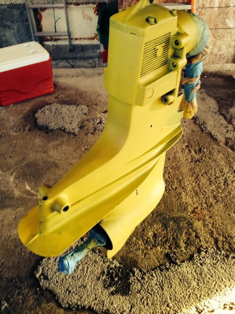

Time to take care of the outdrive while I've got some spare time in my home shop. Drained the oil and greased up the u-joints. The gear oil came out clean, and I checked the receipt I had from the last service, and the impeller was replaced, with 0 hours run time since. Kinda nice, I don't think I'll need to split the housings then to change it out.
Before:
Paint stripped:
1st and 2nd coat of zinc chromate primer:

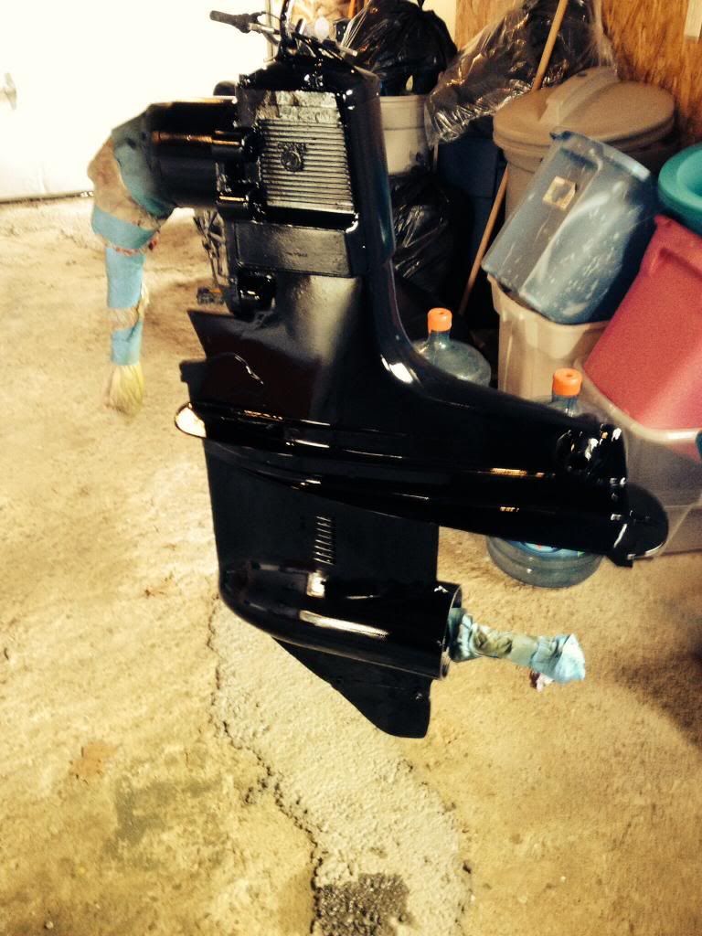

I'll get to doing coats of black gloss tomorrow night if the temps hold up.
zool
Aug 19, 2012
3,433
Re: 75 reinell v1901 project "kraken"
Looking good kernel...I don't usually see yellow ZC around here, so I thought you were painting it Caterpillar Yellow :rolleyes: lol
Kernallklink
Petty Officer 3rd Class
Aug 1, 2013
85
Thanks zool, cat yellow would be fitting, just like my D-11 at work. I was going to start the top coats, but I picked up the wrong paint (lacquer) instead of epoxy. It will have to wait till I'm off of shift.

Finished up painting the outdrive this morning.

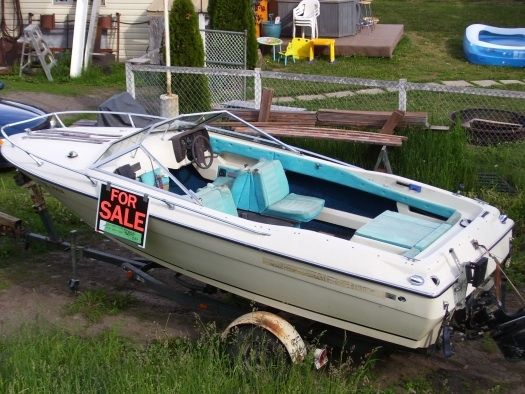

Did some looking around on google today to find some bits and pieces of any info I could find on the boat, and found this image in a deep, dark corner of a server, and tagged on the image is the name of one of the previous owners. Good reference to see the original interior setup. Dad got some upholstery work off the ground today with 2 small panels completed.
