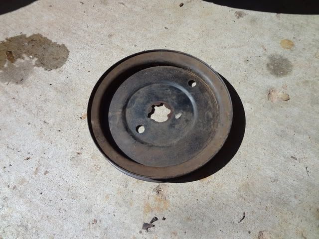

Got up early. Went out and pulled the rearend out of the lawn mower. Cleaned it real good. Everything looked fine, didn't tear into it, couldn't see a reason too.
Luckily my father, who has been keeping up with my progress remotely on this thread (in Ohio), saw what I had said I was going to do and gave me a call. He has been rebuilding mowers for quite a long time. Told me he has never had to tear a mower transmission apart. While we were talking I put my hand on the nut holding the drive pulley. To my amazement it was loose.
This is what I found...
So nothing open around here on a Sunday, will try and get a replacement tomorrow.

Looks like you found the problem alright. Looking at that pulley, I am surprised it didn't come off.

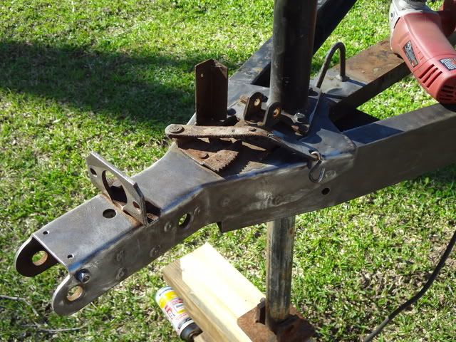

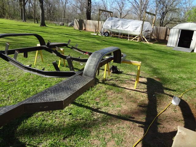

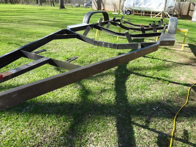

Today however, I did get back on the trailer.
Little grinding, little wire brushing.
Hope I am not getting too carried away with this. I can't help myself. I start a small rust area and before I know it, I have all the paint removed.
Working my way up the left side...
And even further...
Tore the actuator apart. Pins were wore real bad. Brake cylinder was dry. This part here is bent and not working. This is an Atwood actuator. I did a little looking, haven't found parts for this particular model yet.
I'll be starting a week long vacation this Friday evening. Hope to be able to get a welder to borrow to fix the issues that need addressed with the welder. I had not planned on needing to replace the actuator. I hate to paint the trailer without getting this fixed too.
