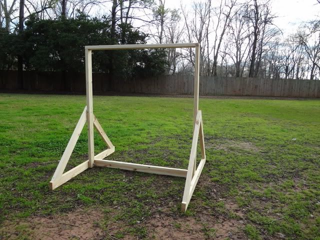

Sorry if I missed it, but are you going to hang the glass on the back of the bench? That looks so much better than my saw horses and plywood bench.

Frisco, I think he built a 2nd rack for the glass rolls. That much weight, high, might be a bit much & tippy. But, yeah we all have workbench envy:cool:

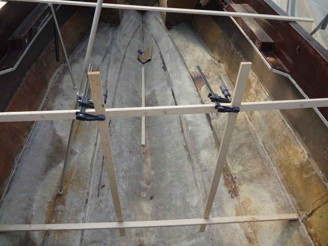

I have a bit of a situation. I was gettng prepared to mark out the bulkheads and found that the wood is not tall enough. When i had cut out the wood for stringers and bulkheads i had figured that they would be no more than 12" tall. Well they are going to need to be 14" and 17". I cut the stringer material 10" Wide and will be cut down to almost 8" at their tallest. Wish i had made them 9" now, would have given me an extra 3" on the bulkhead strip. Now do i go pay $42 for a whole sheet, or figure out a way to stretch the pieces i have? By the time i put a few layers of glass on the bottom of hull the amount i need will be less, but not enough. I will try and figure something out and post results later this evening, burning daylight.

I'd probably get the extra sheet for $42. You could stagger some 10" pcs together & rip a fill in pc for either side. Glue it all up & wait for it to dry. But now you've got twice the lumber in each bulkhead & extra glue. Not a bunch of weight, but extra weight too.
For $42, I would lean towards a new sheet. Trade the drive time to get it, for the time to assemble and to 'stretch' the ply pcs you have already cut, and a few dollars for the extra glue.
All you got left is the price of the sheet, the weight, and the time the assembly will take to dry. <<-- Is this worth $42? To get another sheet, order? Or on hand at HD/Lowes?
Can you use the existing 10" pcs anywhere else on the boat, or in the garage? Do you need a whole 4X8 sheet for bulkheads? You might find a damaged sheet that is <$42.

Ya, I think you are right JB. I almost had myself convinced to try and salvage what I had. I will just get a new board and be confident that it done right.
Cleared a spot for the workbench out in the shed.
This is how I was doing the transfer of the shape to the bulkheads. Well...until I realised my stock was too short...doh!
I was clamping the bulkhead to the 2 vertical pieces. The lower horizontal piece is real straight and gives me the deck height. I wish I had went with something with a little more heft to it. These fir strips were kinda bouncy.
To answer your question Frisco....Here is what I will be putting my glass on. Once I get the iron pipe and holes drilled for it. Figured I would wait till the glass is in before getting the pipe, so I know it will fit.
