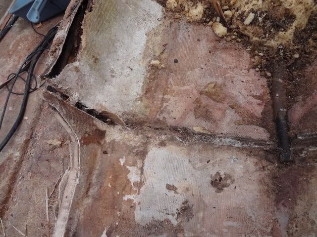

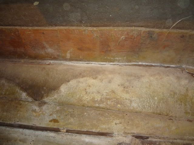

Removed the cross member towards the front of the tank area.
Different angle. The fiberglass in this area seemed loose.
Was able to lift it and get my chisel under it quite aways back.
That black rubber hose might not have done much for geting water into the bilge area, but it sure made pulling the wet foam out a lot easier!

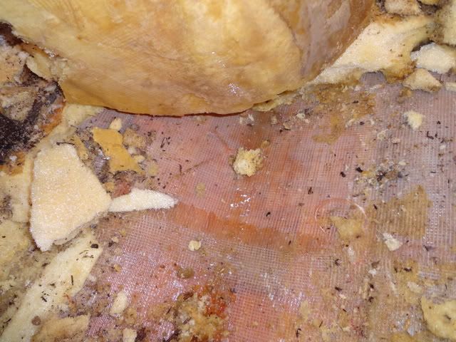

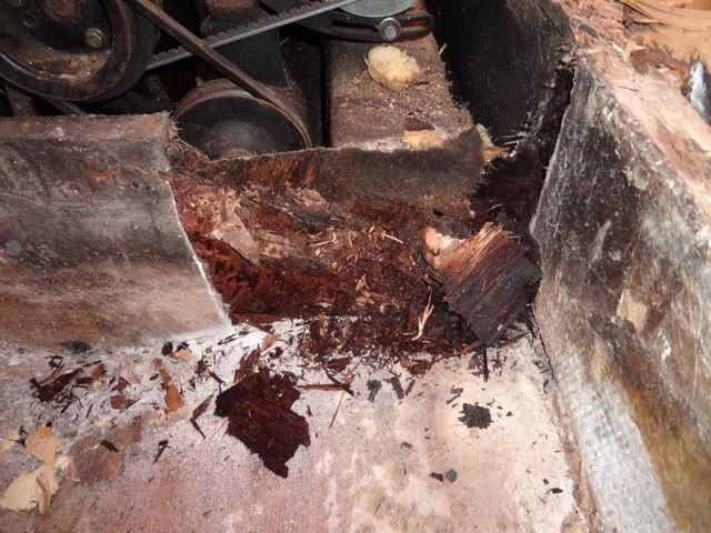

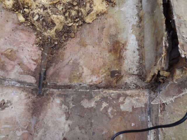

As you can see the foam was very wet under the tank. Anyone know why the glass looks reddish/pink here?
3 layers of tabbing.......with huge air pockets?
Not looking good here, but I knew it wouldn't.....
Motor mounts are gone! I was able to get the chisel all the way back as far as it would reach in there...motor is coming out for sure...

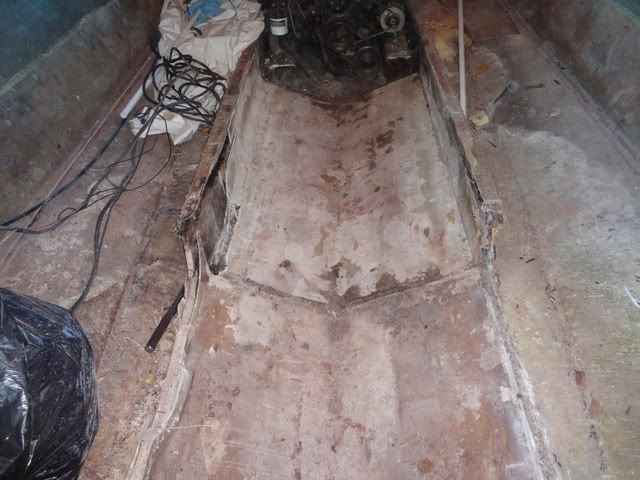

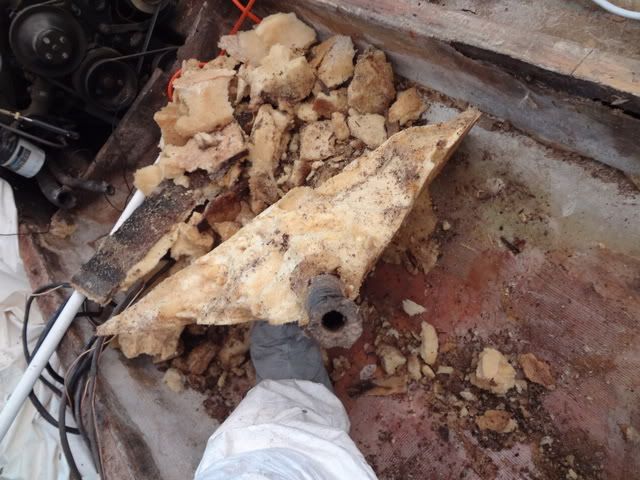

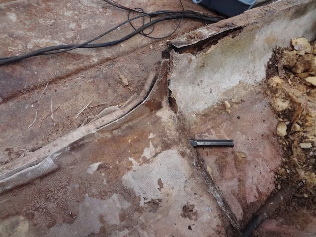

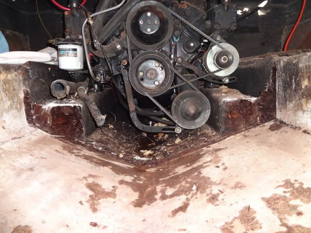

Here is a view of what I got out today, ran out of blades for the oscillation saw - that thing is fantastic BTW.
The area in the 'valley' of the hull here looks different than other areas ( the fiberglass).
Previously I had noted a softspot (red oval) After today I believe there is a 1/4 plywood under this different fiberglass. Because the wood is rotten, I need to get to it.
Question to you all, what is the best way to get these sheets of glass up? Can I make a cut along the stringer then pry the rest up? I assume this will be the least labor intensive way, as long as there is a sheet of plywood along the entire length.
Do I risk damage to the hull by prying fiberglass if it is connected to the hull?
When I took up the tank the foam underneath was of a different type than what was on top or under the deck outside the stringers. This foam was more plastic looking, with larger cells. It also completely filled the void that was under the tank and between the two cross members. This leads me to believe that it was original. If so, then this different looking glass must be orginal too. If I pull this glass up, to replace the wood beneath, I will need to replace it with the same type of glass, correct?

You can replace it with CSM and biax like everything else. :D
Trooper82
Nov 21, 2011
2,648
I would think, that if this was from the factory...using woven, as it appears, that it was put there for added strength and need to be replaced with like?
zopperman
Jun 22, 2011
1,551
1708 is a newer fabric and probably wasn't in production when your boat was built. It is plenty strong. It's what I would use on trans and stringers too. its 17oz cloth stitched (as opposed to woven so it's stronger with less material) with an 08 oz backing of matt. Are you using poly or epoxy? I would use poly if you are undecided. I cannot justify the extra cost of epoxy.

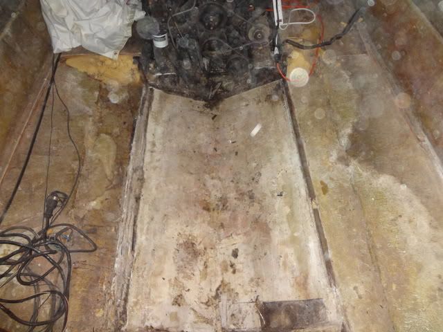

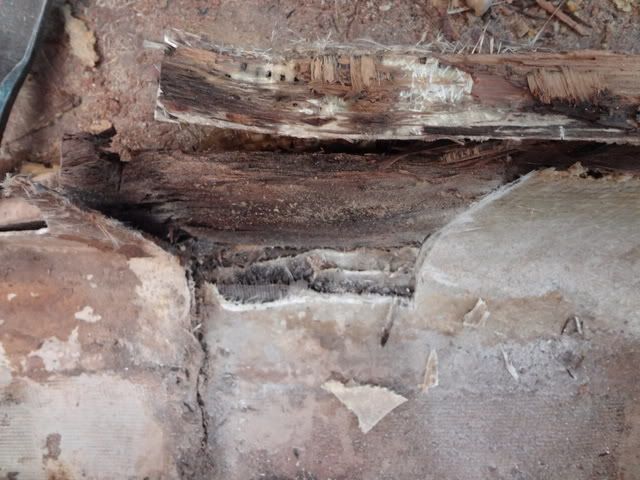

There aint no stringers no more, no more...

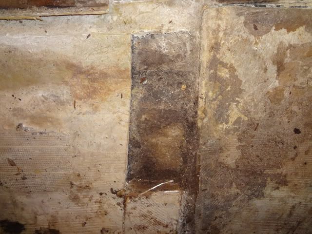

I pulled a plug from the bottom of the 'valley' - I was correct there was rotten wood under here. This is not going to give up it's hold very easy either.
The center is almost solid resin about 3/8 of an inch think. the wood in this area is also decent so it is hard to come up.
Got started on the sides where the deck ended. One draw back from the oscillation tool...blades go fast. I have been using the slowest speed setting so I don't burn it tout too quick.
Anyone know if the grout removal blade will work on 'glass?
