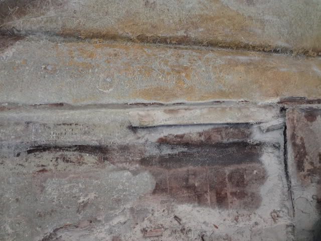

OK today I found that HF dsoes sell High Speed Steel attachments for the oscillating tool. I bought a couple and also got a diamond grit attachment. The diamond tooll does work, but very slow. Turns out the HSS attachments work rather well. I was able to get the majority of the highspots from the deck/stringer attachment areas. I worked on the balsa core areas. I still need to pull the fiberglass out, I got rather large sections and did not have enough strength to get them out. I wish I had read oop!' last post closer. I was grinding the stringer area to get it down to the same level as the surrounding glass and decided to see how the rough and scuff would go. I am using a 24 grit 4.5 inch grinder. It does go rather quick, but mercy what a mess! I will need to upgrade my shopvac, the one I am using has a small diameter hose and is getting clogged with small pieces of foam, glass and wood.
My next order of business will be finding a way to get the motor out.
Here is the area I hit with the rough and scuff. Is this deep enough? I was taking it down till all the foam remnants were gone.
Here is an area I did not hit for comparison.
oops!
Oct 18, 2007
12,932
yeah.....what you want to do is remove any top resin, and just expose some glass.......the top resin is contanimated, and also a brittle barrier for the next new layer.....so you just want to lightly take it off. you want to expose a few strands of glass so you get a good bond for the new layer.
but looks good !
