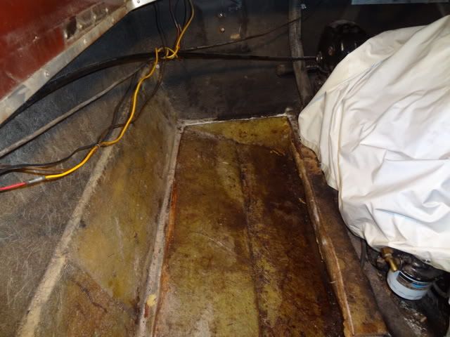

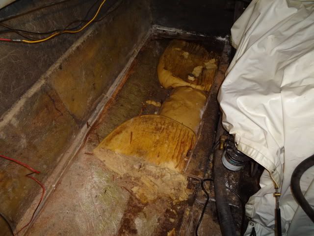

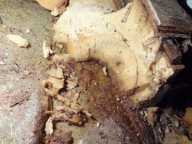

Hope I can keep this up.....I worked on the remaining deck on the port side near the inboard this evening. There was about a half inch of foam that was completly water saturated in this area. As I was pulling up the foam I found a spot that looks like a rupture in the hull, that must have only been repaired from the outside. It was too dark by the time I got things cleaned up to confirm there is not a hole on the outside. It could be covered by one of the bunks so would be awahile before I would be able to see that. I figure if it is a hole it can be repaired fairly easy with the help of the pros.
Is this a hole? Opinions?
All cleaned out
Not sure how far I need to go towars the front. I am thinking I may as well take it all out to do it correctly.
In your pic, I do not see a hole per se, but the glass might be a bit thin so when you do some grinding you should be able to tell and if it is just lay a couple of layers of CSM on it with a final layer of 1708 and you'll be good to go. As for the deck, I vote to remove it all. If you take the time now then you can rest easy for the next 2 decades knowing that this boat will be structurally trouble free and you can use your time for enjoying it instead of working on it.

I can't tell from the pic if that is a hole or not. I agree, the glass looks kind of thin.
I have to go with the others on replacing the deck. At this point, what is a few more hours of labor to do it right.

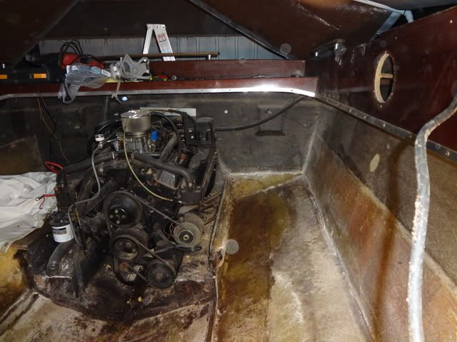

I have been nursing it for a week or so, I was not sure what I had done to it. It hit me tonight as I was taking out the foam on the last section of deck next to motor.
The chisel I so like for taking up the foam is kinda heavy and it was reallly hurting tonight
There really wasn't that much foam to come up....

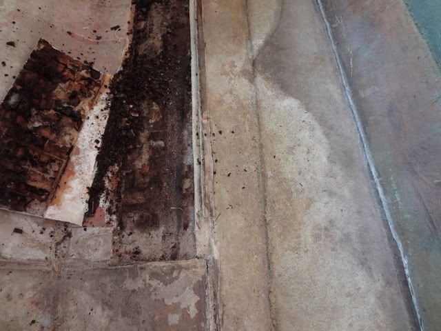

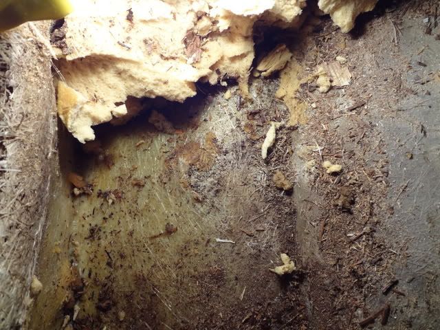

Lots of water in this side, I found out later why, the screws for the speedometer sensor.(I forgot to get a pic) I found alot of the foam down on the lowest section here was dark, brittle and HEAVY. Almost looks burnt. I was thinking it might be due to some chemical reaction to gas or oil from the trim pump mixing with it. Then I figured that the chemical reaction was actually due to when the foam was pooured in. This due to not mixing correctly?
All clean on this side....now to tackle the reamining floor!

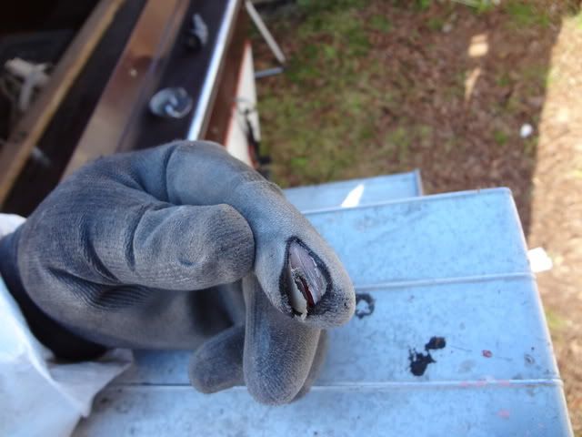

Now I get to say I put my blood into this boat, literally.....
It looks much worse in the picture than it really is....
And all cleaned up ready for a bandage..

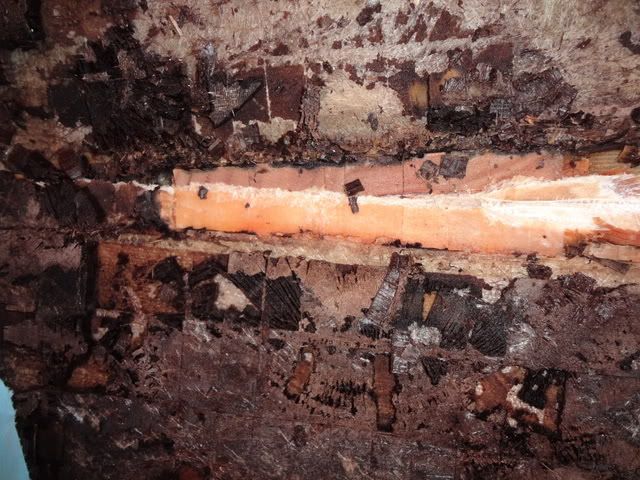

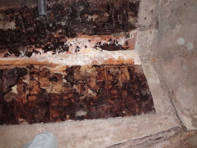

Earlier in the thread I had mentioned that the hull was soft in some places down in the valley. Later I thought that there was some 1/4 or 3/8 ply underneath the added fiberglass in the bottom of the hull.
Well I got a big section up today and it looked very strange.

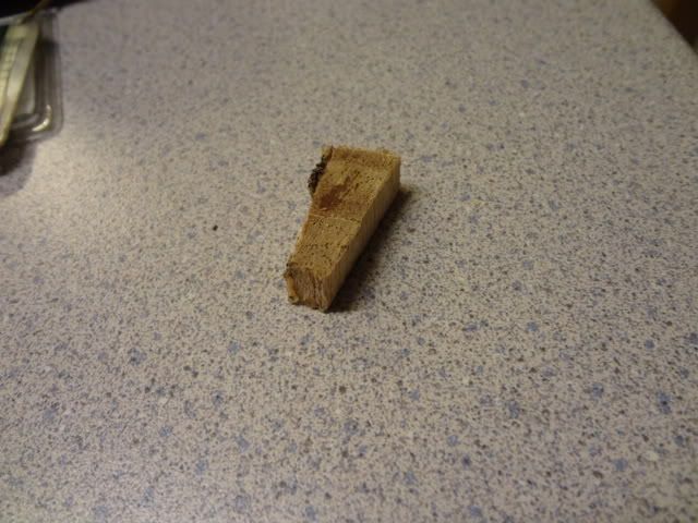

Was I seeing squares? Honeycomb or cellular structure? But it looks like rings of a tree in places....was this wood? Sure looks like wood, but it looks like it was cross cut.
Can anyone tell me why this is here? Is this normal to find 'tiles' made from the end of a board that has been crosscut? And notice the reddish tint? That is what I was seeing up under the glass before....
Here I found some of the pieces that was not yet rotted out. Definitely wood....

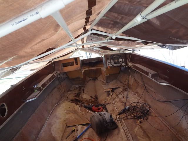

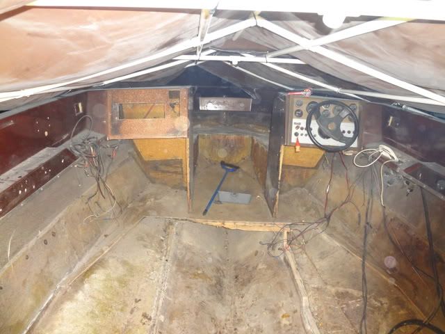

It doesn't show in this pic but I actually got all the deck out today. I am debating if I will tear out the seating area up front.
Like I said before, not a big fan of the console the way it is, so this is coming out eventually. I did take part out already today.
I was using a cutoff whell on the grinder todat to cut the fdeck out in the tight areas. I was also using that same wheel to sharpen the blade to my oscilating tool.
I bought the Chicago brand tool from HF. Anyone know which adapter I can buy to fit other brand name tools to it? The blades from HF are junk. I want to get a good tool steel blade.
Does it look like this boat had 4 stringers at one time? The flat bottom notches are what I am seeing that makes me think it did at one time have 4.

That ply could have been relief cut to conform to the hull shape.I'm just guessing.I have never seen that before.From the looks of it,I don't think the floor has ever been out of the boat,so I am guess it only had the two.You're in it this far,I'd pull the cap and do it right,all the way to the bow.
That's just it though, it wasn't plywood. Looks like they took 2x4 and cut 1/4 inch lengths from it and layed them out on hull. I did not see any glue, they come up fairly easy, the one's that are rotten anyway.

end grain balsa core.
sorry bout your hand. im relly glad you were wearing gloves....it could have been much worse.
as far as the hole.....it is tough to see bud.....but the area around the suspect hole, is glass shot out of a gun that was not properly resin rolled....that is the difference between a build crew paying attention to one that is just doing the basics.
the weird colored foam is a mixture of bilge water and lake water in the foam.....it can really change colors.
most of the foam in build shops is shot from a gun that mixes the stuff out side the nozzel ....the can be out......but for the most part they are pretty consistent.
as far as your delema....about the balsa core.....i would just rip it out and glass over it with csm and 1708......then when you re pour the foam....it will stiffen up just fine.
