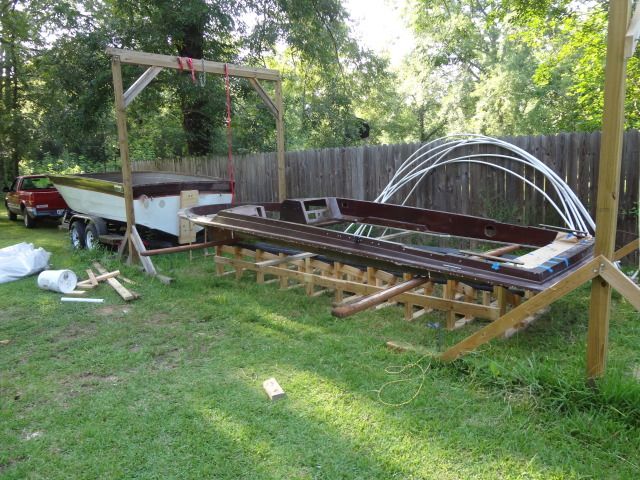

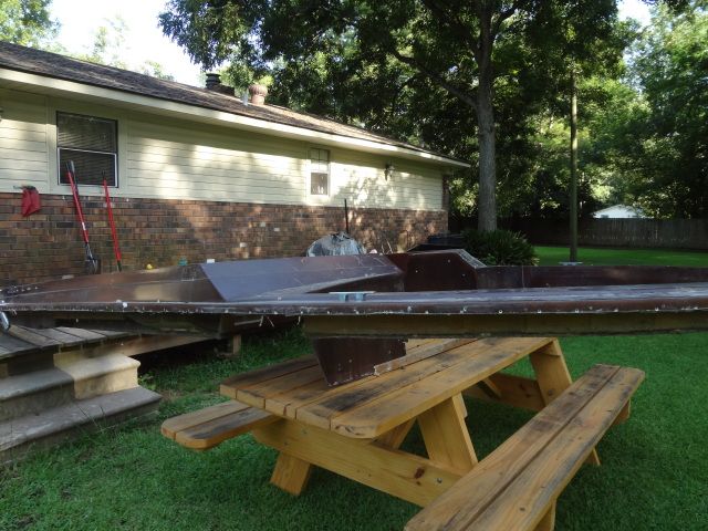

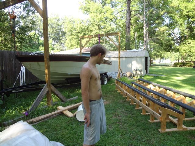

OK....didn't feel too bad today, no fever which is a good sign....soooo...............
Daughter, son in law, one grandson, one grand daughter, the Mrs and I all went outside for a visit........
Hot out there......sun must have done something to our brains...because before I knew it......
Grandkids looked like this....
and this....
and the boat found it's way on here....topless I might add...but you observant folks noticed that in the last pic I bet...
Top taking a rest....
Things in their new homes..for now.....
Now that the boat is mobile...when I get to feeling up to par I can move her around to some nice shade in the back yard....
A little help goes a loooong way!
ps...this thing is HEAVY!! Not sure how the flip will go when that times comes...might be more of a controlled roll....

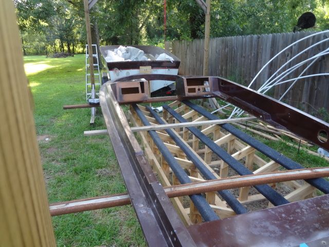

#1 reason to have a 'temp' shelter like you built. 'Easy' to dismantle and remove for now. If need be, 'quick' to put back up.. PVC worked good... Did it fatigue at all in the sun/heat? Sch 40 tends to 'sunburn'... That's how it looks, burnt, when exposed to heat & UV.....
Congrats on getting the 2 halves separated. Now you should have lots of stuff to work on while waiting for parts & materials or something to cure out :)

Nice job on the decapitation ! YA know when your done with the cradle I think you could probably build a cool half pipe for the kids with it..:)

Good to see you feeling better. The boat sure is sweet looking up on the trailer. Looks like the cradle held the hull in great shape.

As for the cradle holding the hull.....I had to go check it out REAL close tonight after what PMC posted over on his thread....It looks good, didn't see any dimples...Recall that I placed new boards on the trailer..to be honest I did not even measure the old ones...they looked centered left to right on the supports and just put the new ones centered...well it is a real nice tight fit between the chines...I got lucky there too!

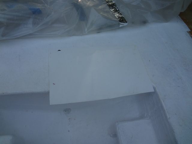

The other thing I did tonight was removed all the screws and snaps and the vents from the hull....then looked inside and couldn't get over how dirty the deck is...so..drilled a drain hole on the lifting block(needed to anyway) and then cut a piece of that plastic sheet I had used when installing the fuel tank...took some silicone (this is a temp solution) laid a real heavy bead around the tank inlet and the access plates(which are not 5200'd in yet)....then put that down on the bead...purpose is to act like a dam to hold water out of there untill such time as I have the dog house in place....then got some warm soapy water...a scrubbing sponge and went to town..then hosed her out....
One night uncovered under a tree...there were 8 partially eaten pecans...way too early for those but the squirrels always try them...bird doody...bug doody...bugs...leaves...sticks...dirt from just walking in it...cleaned it out let it dry then put plastic in it to keep that stuff out untill I can get some gel coat down and sprayed with PVA....feed back I got from my question on the tacky gelcoat pointed towards needing to use the PVA because too many variables to trus that the wax is going to work...and I don't want to have to go through this again...whew long winded tonight :)

Here is the little lid/flap deal I put over the tank inlet until I get the doghouse covering it...
