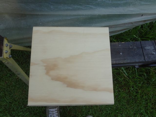

Started feeling bad again.....laid in bed all day....think I will use an air grinder with a sanding drum to make a beveled edge after drilling holes....doesn't need to be that big or perfect, just a bevel to hold the PB. Hoping I can go out today, still not 100% this morning.

Eureka!
While explaining to the grandson what the plans were going to be for today..it hit me...
Was talking about a bevel...and PBing the tops and bottom edge...hey why not just bevel the whole board and let the fillet hold it against the hull?
I think it is going to work fine..much easier than drilling and grinding 144 holes!
Kinda hard to see in the pic, but I ran a 45 degree bevel along the top and bottom edges of the board....

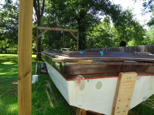

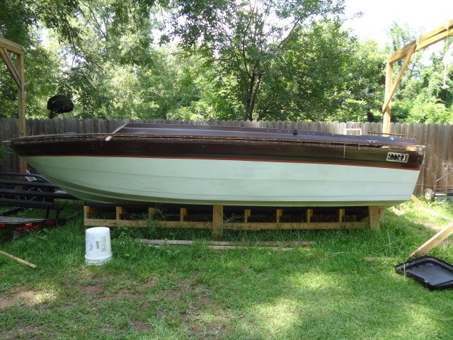

Well....it is just too darn hot to do any glassin'....this stupid stent is giving me pains too....
Figured to do something that didn't take too much time...was comtenplating putting the boat on the trailer...so I can move it to shade when I need to work on it...but no bolts for the rollers yet and didn't want to just lay it on the bunks....so...
I Cracked her open :)
Tests show that lifting from the front of bow will induce a lot of strain right in front of the console area...willl take a few more hands than I have right now to lift it out and away from the boat....
Besides I need to biuld something to hold it too..

Build a ladder frame under the cap, use it to help ya lift it off, and leave it in place & set it down @ flat spot in the yard temp for 1/2day while you put the boat on the trailer. Use your current cradle for cap, w/ only minor mods...
If you decide to switch back to boat on cradle, put the cap on the trailer...
Maybe ??:confused:??
You could even leave 1 2X long at the bow & stern for you & 3 others can each grab a corner.... Or if you can move your gantries closer to 1 another, suspend the cap from them...Unless you need them to help transfer the boat to the trailer

Troop don't push it! becarefull with that stint still in place. It may be best to wait till all your ducks are in a row before moving that cap to avoid any uneeded damage do to stressing weak areas. You may want to shore up the walk through area before moving the cap any further. Good luck and take it easy will ya!

Good call on needing to shore up the consoles....had not crossed my mind today...
The little progress made today vs the pain.....not worth it....it will sit like it is till I get to feeling better.
