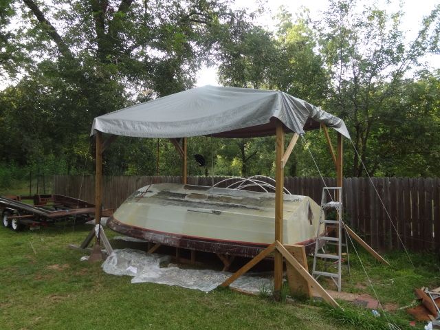

trooper 82 how tall is your gantry 10' or 12'?

Thanks, I find them pretty handy...could have had a better design though....
I made them from 10' PT wood. height and width....4x4...wish I had 4x6's fpr the tops now...would have been stronger...

Hope everything goes well with the ks Troop.. Tarp looks great should give a little relief from the sun ..

Ordered wood for gantrys, took your recommended suggestion and got 4x6 for the tops. I like the idea of shade with the added bonus of lifting
Boatnut74 made a gantry system I liked...depending on the size of your boat this might work for you....

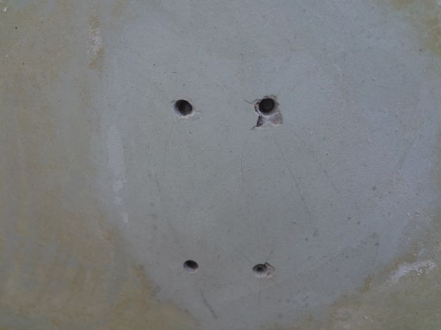

Looking for some advice on what needs to be done in a few areas...this is the lower right side of transom..a plate with some HW mounted to it was screwed in here...Looks like the glass has cracked...another question I had...the gray stuff is about 1/16" thick here...it is pretty much covering the whole boat so figured it was fairing material...I can leave the gray everywhere?
Here the gray stuff is much thinner...and you can see that it has cracked from the ladder mounting screws....

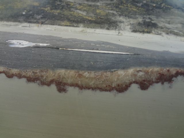

I've been using a scraper..and this is the only place where I chipped this strake?..it is red hard glasslike underneath..not resin like, but sheet glass hard and brittle...

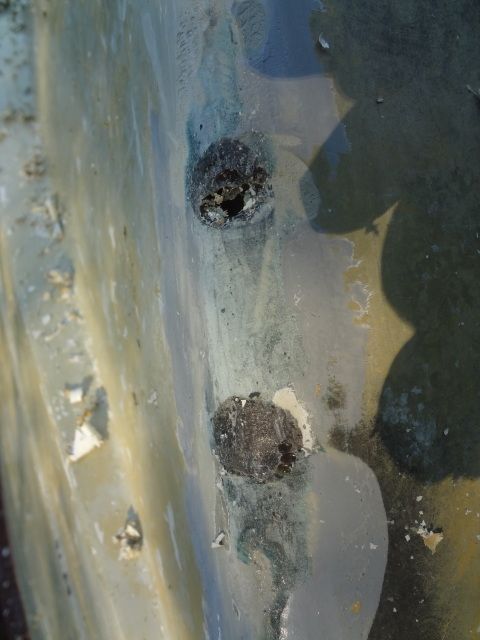

The bow eye that was mounted from factory I supposed..the one that still had metal in these holes...still have not repaired it from the outside..also not the bondo type material..front keel is covered in this...I assume I take that all out, build up layers with CSM/1708 and then grind down and fair?

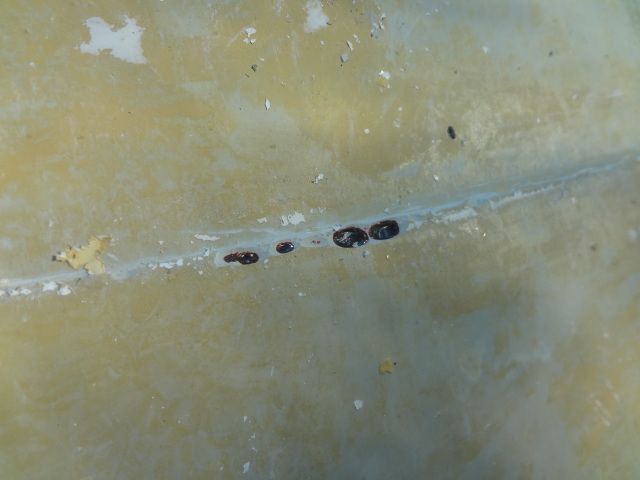

several places in the corners are like this...again same as above...grind it out..layer it up...smooth it down and fair?

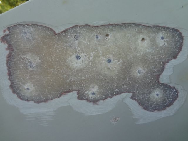

See the red under the gray? that is what the stripe is made of at top of hull sides... hwich is why I asked did the gray need to be sanded down to this?

Looks like you've got a whole lot going on, and although it 'seems' that it may have gotten a re-spray gelcoat at one time or another, I'd have thought that the interior, once stripped & bare glass, would have shown evidence of a 'reason' for a re-spray. It didn't seem to look that way. Have you looked up a '78 Ebko & seen what the original exterior gelcoat color(s) options were?
Maybe it was that metal flake brown and a past owner didn't like it......
I don't know why, no basis in factual reality, but:
Ebko sprayed the mold for the hull just like most did, right? Maybe they shot the outside gelcoat & then shot the strakes & hard edges w/ a harder, more chip resistant gel(?) or resin to decrease trailer rash along the strakes which would decrease the hull's performance :confused:??.... Maybe?

Troop as long as the "Gray" filler is bonded well and not flaking or peeling then sand and feather. You're "spot on" on the repairs, if it's not deep then CSM is good if deep then add a layer of 1708.

thanks man....I have seen other Ebko's of this make and near same year, they all looked the same.....brown paint over brown metal flake...then the red stripe with white everywhere else...doubt I can find anyone with knowledge if it was gel originally or not.....I have assumed all along it was white gel....but then hit it with stripper and it bubbled right up....gel wouldn't do that.
That first bottom repair I did was an area that looked like a fix from the inside to me...def some repairs there on the corners...
