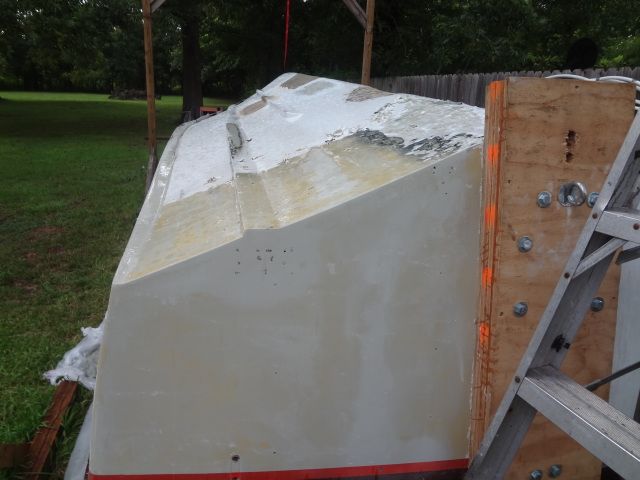

Picked up a few supplies for the weekend...
Tried out some paint stripper...
It did a decent job....GT - I didn't have any plastic wrap so tried using the drop clothe...I could not tell a difference...
The brown that is over the metalflake was a little tough to come off...and you can see where the stripper took off I am guessing a clearcoat...not sure if it is paint or gelcoat though...

Looks like the stripper worked good. Did you do small areas at a time or large area? The old clear coat will fade out and look like that just from being in the sun. Have alot of old bass riggs that look just like that here in Texas.

hi trooper... i got asked to look in on this as soon as i got back on line.
the de lam is a real pain....
you have a hand laid hull.....the de lam is usually caused by too much resin.... and either over or under cured.
the deal with de lam... is that you have to grind it all out... you have to chase the de lam with the grinder.
when you are grinding...you will see the cracks between the layers of glass.......just chase that out till there are no cracks left.
then re glass the area starting with csm.....use 1708 or what ever thickness of material you can to get the desired height.
then re fair and re gell.... its a pain in the butt.....but it must be done or the hull integrity is compromised.

I did that section in three stages...almost glassin' weather!..enjoy the cool down...lol
Thanks for stopping by oops!...heard you were on Holiday...hope you had a good one...ya the delam is a pain..just hope I don't have to grind the entire hull away to find the end of it...guessing I need to just do it in sections so I can replace as I go?

jbcurt00
Oct 25, 2011
25,130
Free boat wash :cool:
Is that de-lamination easy to see as you strip the paint? Or do you have to hit it w/ the grinder?
Trooper82
Nov 21, 2011
2,648
Haven't seen any yet without first hitting with the grinder....i will get the remainder stripped in the morning.....back half anyway.....then start some more grinding.
