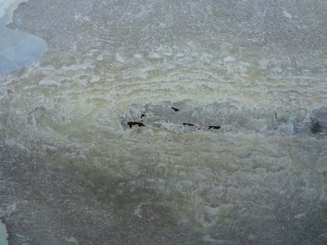

Was there fuel or oily gunk under the tank when you removed it? If so this could have leached into the glass and caused this problem. Just a thought. But hey, what do I know, I'm just a
Decker83
Apr 5, 2011
2,593
Trooper, I was looking and thinking about the delam in the pics. Did you notice if there was any csm between the woven roven layers when you where grinding. The woven roven has to have a layer of csm between them and be laided up wet on wet for it to bond correctly.
This could be the cause of the delam. It looks like there is csm just under the white color but from there I can't tell.

Ya Decker, it does look like there is something...maybe CSM between the roving layers..that is what is failing..I'll find one of the chunks and make a little vid so you all can see how it is doing...

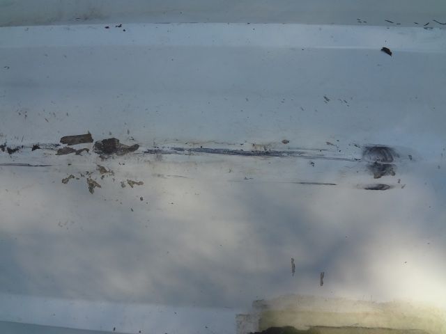

Under the ski locker....
Before...
During...you can see the cracks line up with the material used for the filling....turns out this is the same stuff I saw from the inside...looked like resin, but odd color...and no glass in it!
I offer as proof...a hole through to the ski locker, lol.knew it would happen sooner or later...I had some close calls, but no through hull...Now I am a card carrying member..hahaha

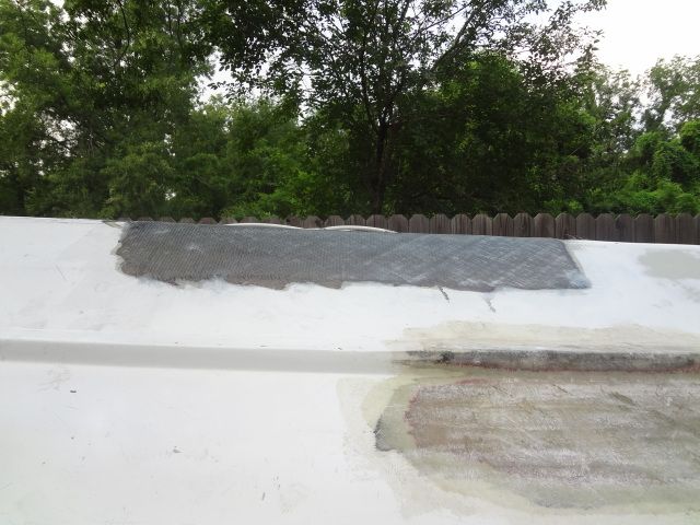

this glass looks like the other spot...looks loose...but it actually isn't, or did not seem to be when I ran a gloved hand over it...no snags...

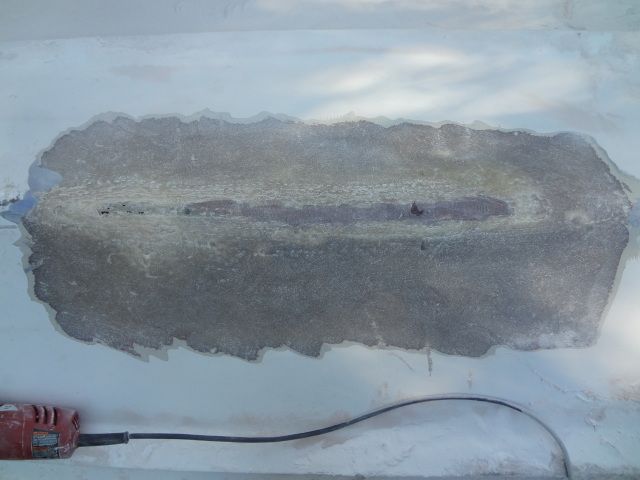

I made this ground out area big, thinking I will need this much space for strength when I glass it back in...this is big enough? I may just slap some CSM on now to keep it dry till I get my next round of Mekp..should have enough to actualy fix this area if you all think I am good to go from here...
Thanks for the help....

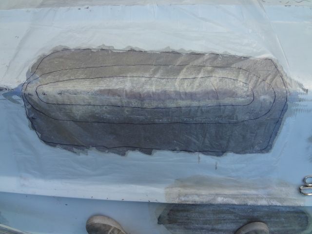

Well.....I did a little more grinding...found a little bit of flaking, but not near as bad as that first section...
Made me a clear template...figured three layers...each consisting of 2 each 1.5oz CSM and 1 each 1708..(ya wood I know you said 2 of the 1708...but to be honest I forgot till it was too late :))
I think it came out fairly close...
Even from this direction...
I started with 500ml resin...then another 400ml...barely, and I mean barely had enough mekp for those two....got it all down and it has been kicking very slow...took the heat gun to it...we'll see how it goes...will check it again in an hour or so...
Had to use styrene to soften the glass....DO NOT get that stuff on your skin!!!

Patch work looks just about perfect. Just a scuff & some fairing filler, it'll be looking real good.
Great to see someone HANDLING the glassing challenges as they come up. You & SP are getting it down. Well done;)

The patch looks good from here.
Thanks Decker...I thought it turned out good too

Thanks Wood....just got back in from checking.....kicked off fine!
