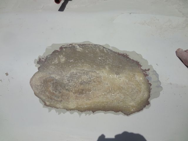

The roller spot ground out....and yes I am grinding in bare feet..
Still more to go, but the heat/humidity is making it tough to stay out longer than 30 mins at a time...3 or 4 layers of roving that is just flaking off...spot is about 15" x 10"...I feel like I will be removing this all over the hull if I have to find some that is still sticking...

Troop, how deep would you say it is??Will 2 layers of Csm a layer of 1708 and 2 more of CSM bring it back to level??
Looks to be about 1/2" deep in places...I only have 10CC of mekp at the moment...too close to payday to pick some of the expensive tubes...I did find some but they want $5 and some change for .37 OZ!

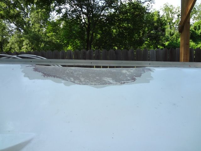

Made a video to show you all what I am up against...the more I grind...the more flaking I find...
So far I am about 3/8" to 1/2" deep...when I get to the roving it seems to be OK.....how far do I have to chase the flaking? I also assume I need to be feathering this out quite abit...I started big but have already approached the feathering I started...think I will need to go out another 3" or so on each edge...but then the flaking will start again...confused.....

As far as the woven roven goes, there should be NO delamination in the repair area. If you don't remove it the new glass will fail.
I don't know what it is about the roven, but I have seen this problem in alot of boats. It seams like it fails alot.
You need to keep grinding untill you find solid glass. Just remember, it's fiberglass and it can be fixed.
I would also use the 1708 in the repairs. CSM dosn't have that much strengh compared to 1708.. 1708 is a structural glass.

yes the flip went much better than I thought it would...I better get a new grinder then....if I have to find all the loose roving...I swear who ever put it in used a mix of mud in their resin!
as for the 1708, WoG already it me up about that...going to grind some of what I did this morning and put a couple layers of 1708 on it..WoG suggested 2 layers of each, CSM...CSM..1708...1708...repeat till I get to correct height....going to need another 30 gallons of resin if I have to do the entire hull like that :( and I do not have near enough 1708 left to do that either....

Troop, Decker is 100% correct. Grind till flaking stops and good glass apears. I can't imagine the entire hull being this way but...If it is...Well it's gunna be a lot of grindin and glassin and you WILL be a PRO when you're Done!

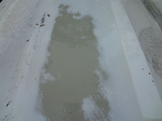

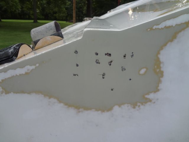

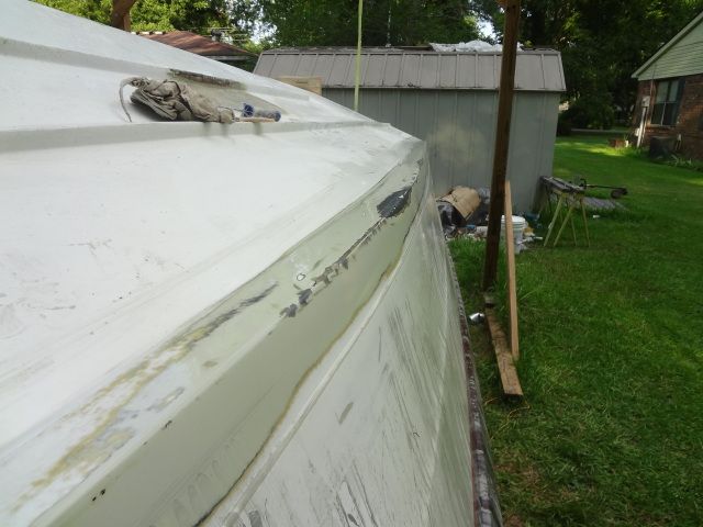

Soo...I found 3 pieces of 120 grit pads that fit my DA sander....but didn't want to use the DA...just wrapped a piece around my sanding block and started testing the waters...
I started out on the corner where there was some cracking evident...
the dark areas is where there was some filler...and a noticeable gap...sure that is where the cracks were...I really don't think there is any gelcoat on this hull...very thin white, I assume is paint...tan color... then black paint type stuff then this offwhite/green primer looking stuff...then glass... Do I need to go to glass or just till it is all smooth?
Just checking out a few spots to see if any is gel coat...this came off pretty easy...this is next to keel and that bright white I showed you yesterday....
Another spot...between the bright white and white..near transom....
This will need to be ground out... my little triangle shaped blocks are behind this area....
