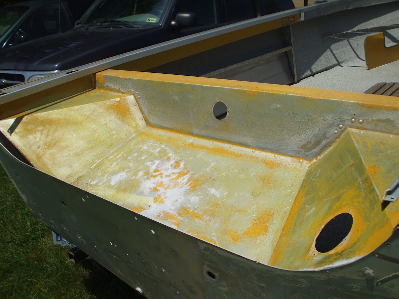

Final touch up coat of epoxy resin on the transom. Nearing the finish line on the transom, thankfully.:)

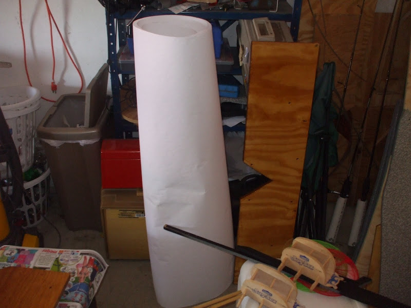

We are going to use this huge paper to make a template for the stripe. We will see how that goes.
More of the same on the splashwell.

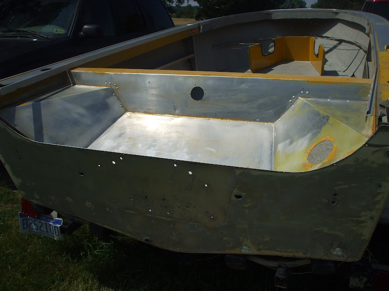

Almost done with the starboard gunwale. I need to figure out how to get the edges.
Maybe some paint stripper on a rag, then a toothbrush to scrape the paint off. We'll see.:)

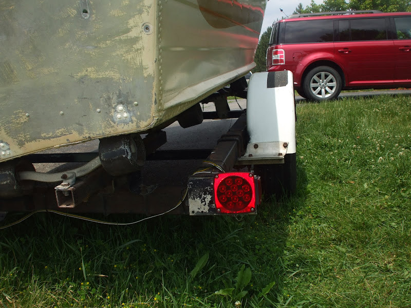

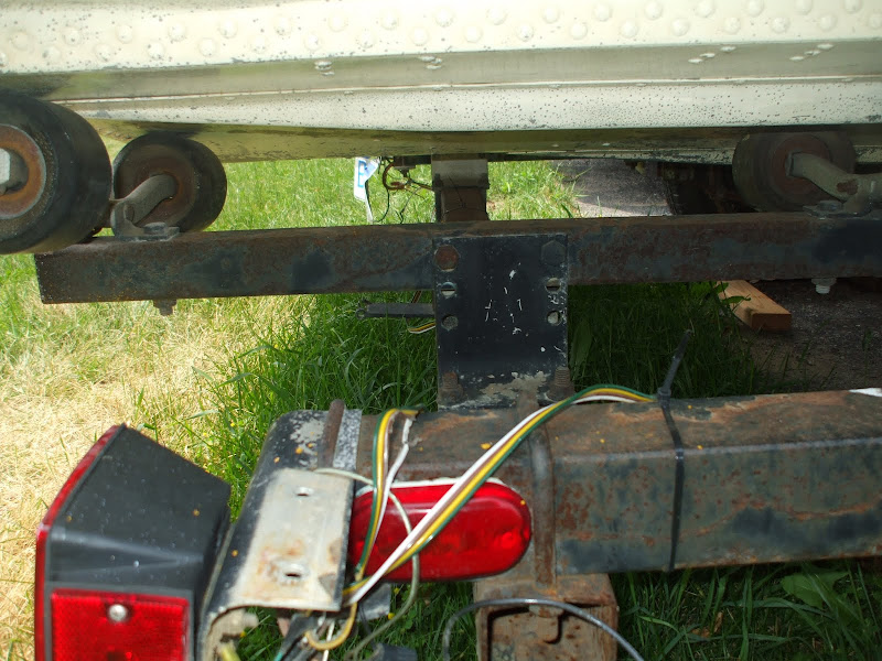

I've been thinking about possibly lowering the rear rollers one hole, to let the boat float shallower.
What do you guys think? I have guide bunks that will be on each side, so I can prevent the side of the hull from making contact with the fenders.
The boat is sitting closer to the wheel on the starboard side, there will be more room when it's properly centered.
In addition, since I can't lower the forward rollers at all, this will let the bow sit higher on the trailer, so water flows out the bilge better.
Not sure if there is a downside to this plan, I'm sure it will appear after I try it out.:facepalm:
