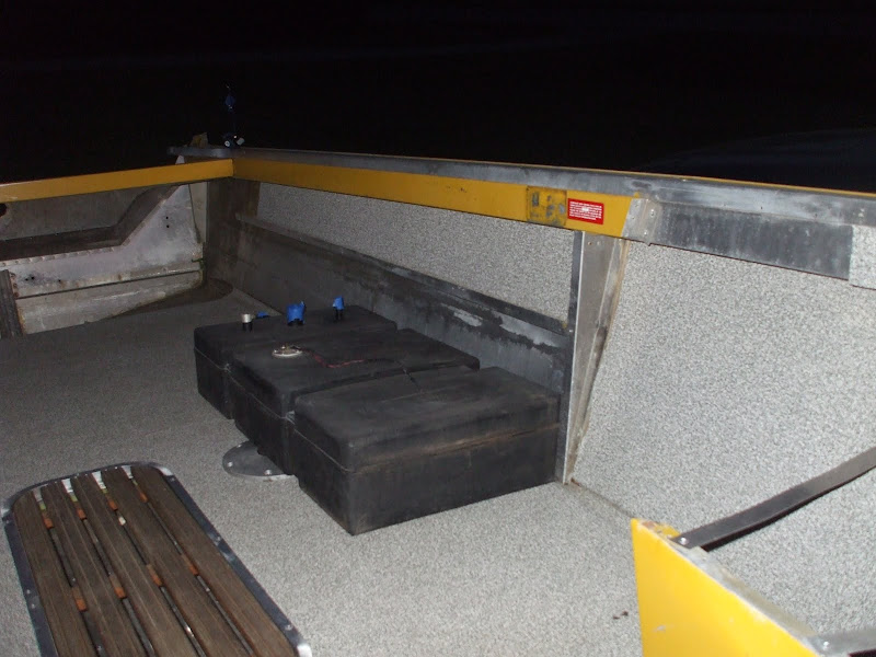

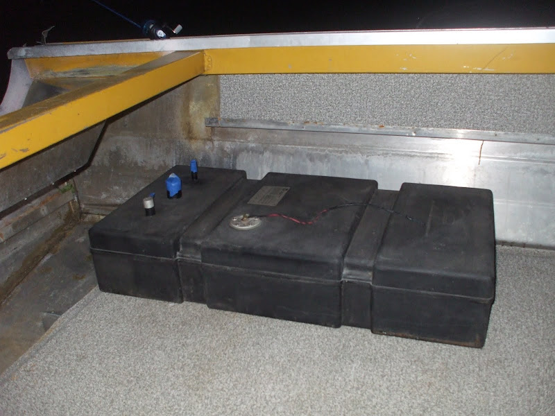

After returning home from a nice father's day dinner(shrimp and veggie kabobs) I was pleasantly surprised by a gift from a fellow brother in tin, jasoutside.:)
What a guy, he delivered(for free mind you) a 17 gallon permanent fuel tank in perfect condition.
Great size tank for this boat, and will make my life a ton easier once it's installed.
Thanks a bunch Jason, despite what fiberglass boaters might say...you are a gentleman and a scholar.
I will return the favor someday, hopefully by filling up the tanks in the Islander for a run in Saginaw Bay.
I checked it out in a few different locations, to plant some seeds of thought.
I'm leaning towards placing it amidships so the weight won't push the stern too low at rest.
More stuff to ponder while stripping paint off.
It says here I can switch over to diesel and I won't even have to change the tank.
Good to know since I like to have all options on the table.

Nice tank!! Jas...what a guy. I think I would tend to try to center it side-to-side but I guess that depends on your normal load balance. Only if you're alone a lot would I locate it port side. IMO almost any location other than the stern would be best. 17 gallons of gas weighs 103.343 lb. according to answers.com.

Nice tank. That size is perfect. You won't need to worry about auxiliary tanks with that capacity. I wish I had some ideas for you on where to put it. I went with a 12 gallon in order to fit it where I wanted it but I do wish I had more capacity.
I kinda like this spot. But I'd think you'd need push it back all the way and then you could build a jump seat box around it. Same on the other side for batts to even out the weight maybe?? Course then you are kinda transom heavy.
This would be a pretty good spot but then you are monkeying with your pedestal you have set there. Building a set box may be a little awkward unless you went to back to back seats or something, eh.
You could always drop it dead center up in the bow and build a casting platform. Course, that takes away your walkway for the bench seats up front in the bow there. On the other hand it would give ya some bow weight.
How about this (this is what I am kinda thinking for my Jet Star, maybe)...
Pull it out from under the splashwell and mount it here...
Build a bench sort of a deal. Maybe just a plain bench. Or, one with a flip up back to it sorta?? You know, flip down for a casting platform and flip up to sit down for the ride kinda deal.
Ah, just thinking out loud:D

To centre the weight of the tank and its contents could you stick it under the floor where the ski locker is? I know you'd lose the locker storage, but you'd have the weight low and in the right place, plus easy access to the tank and its various connections. Just a thought! :)

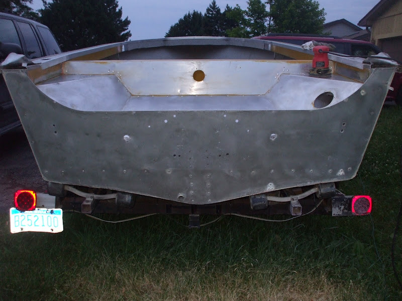

After work today I managed to get a coat of citristrip on the stern.
It worked pretty well, even though it's best at killing grass.
After that I used the orbital sander to clean up the stern and splashwell too.
I ran out of stripper so returned to mechanical sanding just to keep things moving along.
I had to take a break for a t-ball game too, so that's about it for today.
We are planning on getting some more resin on the transom, if the kids ever go to sleep!
There are exactly 8 too many holes here, from the exterior wood piece that Starcraft bolted on in the factory.
Extra splashwell drains?:D I will probably use JB weld on these, not sure if they are big enough to need a bolt or backing plate.
I also finished removing paint from the starboard gunwale.
I worked on the edges a bit, will still need to go back with a small brush and some stripper.

She's looking good. I can't wait to see it done. You will have her in the water before you know it. That tank is sweet too. Keep up the good work.

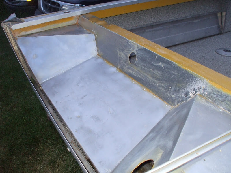

Here's a "before" shot of the stern of the boat.
Call me crazy but I sincerely think that was too much yellow.:facepalm:
The bare metal is a ton easier on the eyes as far as I'm concerned.:cool:
I am considering painting all of this grey though, for protection and a cleaner look.

H.A. if your skeptical about where to put that tank, you can always do a builders float test. You can use sand bags to simulate the location. A 18 gal tank will probably fill to around 15 gals. I know that sounds weird but I had a 18 that I mounted under the deck in the bilge and I could only get 15 in it and that was on a cold day.
The Jetcraft has a 35 gal tank and it's center mounted below deck all the way aft. It will take a full 35 gals. My helm is what's known as a forward helm because it's located further forward than a normal boat. My MonArk legend was nearly the same as yours and the front of it's 18 gal was even with the front of the consoles, below deck and dead center, if that helps.

Thanks for all the advice folks, I agree that the tank should be as forward as possible.
It's about a hair too wide to fit between the stringers, so that is not an option.
That would be the best spot for it, in between the consoles to act as a ballast.
I will need to test out different weight distribution and see how she floats.

What I'm asking about(and I was not very clear) are the ones that do not go thru the transom, on the shelf.
You can see the holes in this photo. I'm starting to wonder if these were done by the previous restorer and not the factory. I will check out some of the other threads to see if they also have these.

Not the splashwell, the shelf the the transom sits on. I have a hole on the left side here and no corresponding thru hole.
Sorry for the confusion, I've been about as clear as mud with my descriptions.
There were rusty screws in there, but I'm considering rivets. The screws might tighten things up better though.
Also got to work before this rain shows up tonight.
The transom is being painted grey. Rustoleum rattle cans do the job.
