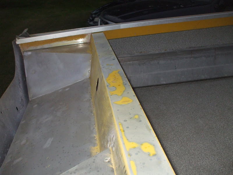

Been working on getting all the corners and edges on the splashwell too. The 3M drill attachment is working the best for me.
I will need to pick up more Citristrip, probably should try to get it in a bucket to save money.

I almost finished taking the paint off the cross beam top face after dinner.
Progress is halted however, due to intense lightning and a tornado watch.
Maybe we can get the rest of the transom painted in the garage, or else I'm taking a break;)
