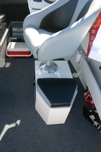

Huron Sr. drove down today to watch my oldest play T-ball...and dropped off an extra seat base and pedestal.
Not sure what I should do with it. It's super short at 8" so it would need to be on a box or something.
He removed it from his Sea Nymph since he doesn't like sitting that low.

8" is what you need if you want your head below the top of the windshield. That is what I ordered for the 18 and used in the 16.

Yeah, Check your seat height before you building a box to set it on.
Mine is 10"

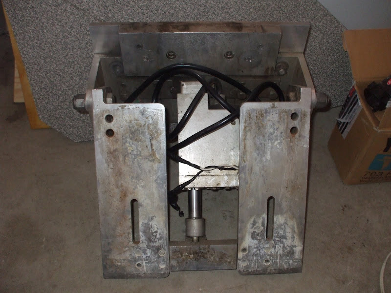

My CMC bracket needed some corrosion removed so I got to it with the 3M wheel. Not finished cleaning it up yet but improved.

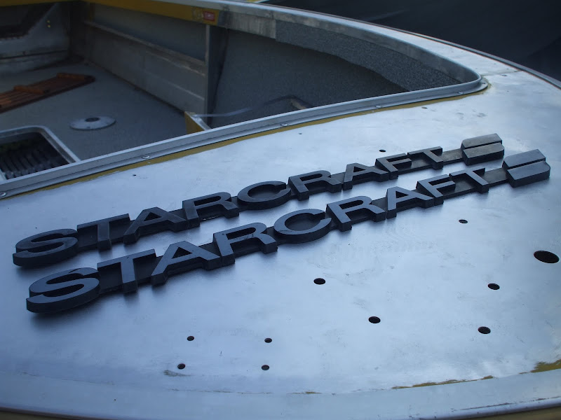

One other area of progress...I took a length of Stren braided line and sawed thru the double-sided tape holding on the Starcraft badges.
That tape is something else, almost as good as 5200.
I'm not sure what to do with these things. Any ideas?
I believe they had chrome paint on them or something.
I dunno buddy but they are in excellent shape for being 30 years old! Shoot man, I'm just a little older than that and I have a few cracks, breaks and missing pieces.
Maybe hit em with the paint color of your choice to look nice on the hull eh.

I would paint em up and stick em on the bedroom wall I'm sure the boss wouldn't mind:eek: Seriously though they are in good shape should be able to do like Jas suggested and reuse em .

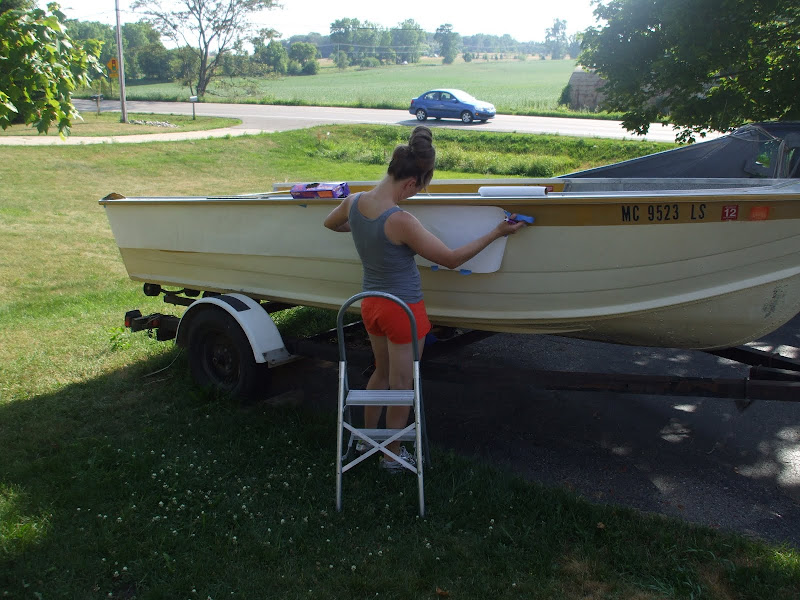

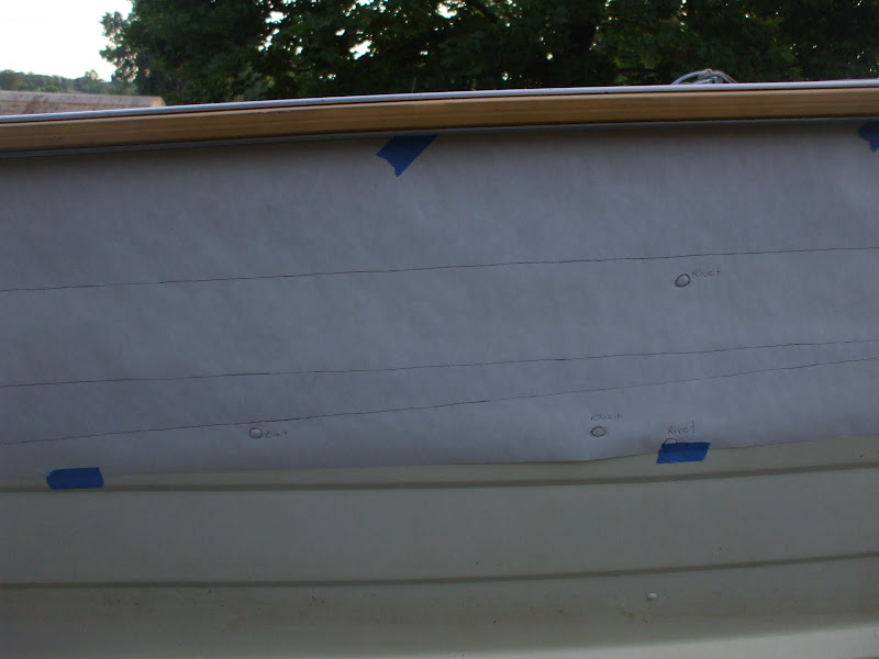

I was lucky enough to have some help making the template for the stripe.
There are some marks there indicating rivets, so it will be all lined up later on.

Should look sharp when painted. I vote for repainting and using the Stafcraft tags too.

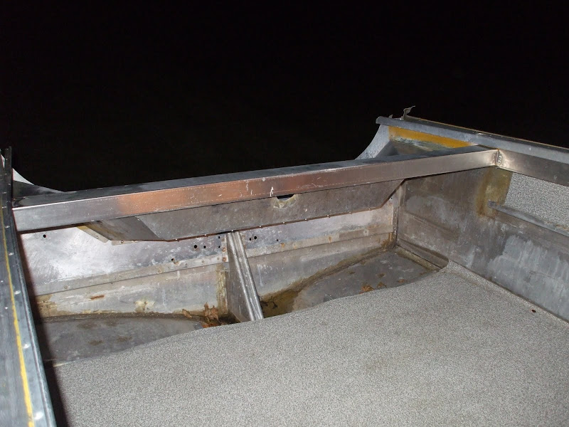

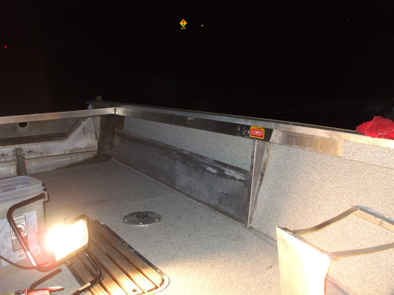

The factory paint is now gone from the interior, since we got back from some vacations and finally had some time to work.:)
We attacked the paint with the Citristrip gel and it worked very well with a brush.
I removed the first layer of yellow paint off her with the shop vac Roslynn came along and scrubbed it using a non-abrasive pad.
I did plenty of work, just not captured in the photos.:D

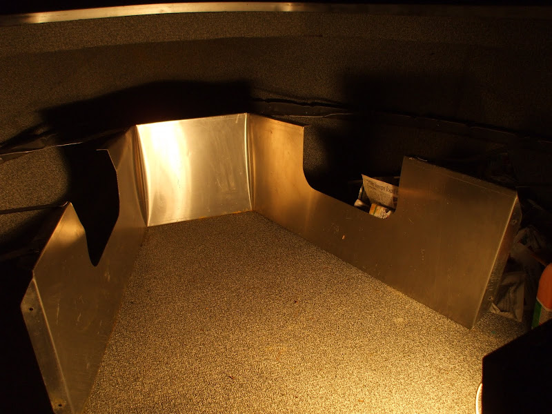

The bow piece got some attention as well. Not too many scratches, just a few dents.:)

HA... you could paint a flat board then dip letter side down in order to coat only the top.... if you plan on reattaching to the boat again. If not.... I liked Jason idea of adding some Starcraft decals to his Islanders trailer. You could rivet it to the trailer if you wernt planning on putting it back on the boat :D

Roz did an excellent job on all that paint removal, very clean!;):D
You did a nice job of taking photos of all her hard work:rolleyes:
