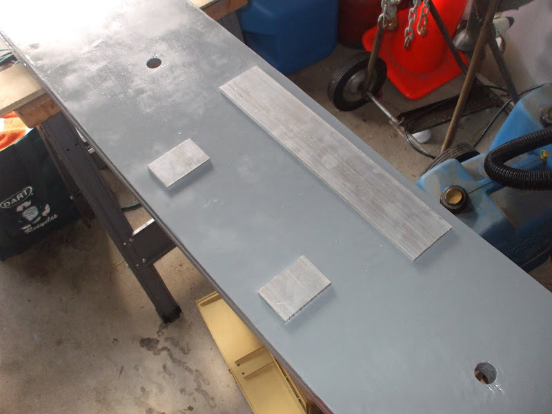

Don't bother with the Al on the inside, instead get a couple of Stainless or Aluminum Spreaders. I made mine out of 3/8x3x30 Aluminum.
Well, it's kinda funny since I got the idea here months ago from Steve and I ended up with almost exactly what he mentioned for spreaders, even though I didn't go back and check his post until after they were delivered.
Thanks for the recommendation back in January;)
Here's what they look like on the transom. This should distribute the weight and torque from whatever outboard ends up being bolted on:D
The lower bolts have the knee brace in between, so they are separate pieces.

That'll do the trick. Nice job.
