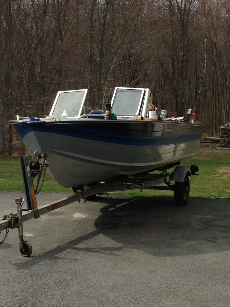

So I'm tracing the wiring on the Smoker to day and testing it with my jumper box. Bow light works after replacing bulb.. check! Anchor light works... check!! Bilge pump works... Ckeck!! Newly installed cabin lights work.. Check!! Now i hook everything up to the ground buss bar and New switch panel and NOTHING!! So I'm setting there.. like what the #%*%#!!! Then I realize.. check for fuses in the new switch panel dummy!! Daaaaaa! lol Everything works great!!!!!
Next install Gas tank all cleaned inside,checked gauge float and it works...
Any Ideas how to test fuel gauge on dash to see if it works?? I have a FLUKE Meter

Gas tank Installed Gas gauge and fish finder,compass all lights, bilge pump etc. working.... More pictures coming!

Looks great and like you're about there, so powering up is next and then splash time?

Motor is on... Steering hooked up.. Controls hooked up... Fuel line hooked up... next Battery, add Fuel fill Barrel with water and test.. trip to DMV for New Registration and hopefully will make a splash next weekend..

Looking good BG!
Hey the muffs work way better than trying to fill a barrel up with water and there's not the mess of slime from the 2 stroke oil.

Update,,, the Motor started right up but no peeing... Pulled the lower unit and the Impeller was toast...Going to replace everything.. also the shifter cam was in 3 pieces .. Parts on order..Hopefully back together by next week... so in the meantime I finish removing the stripes and Smoker Craft logo..
