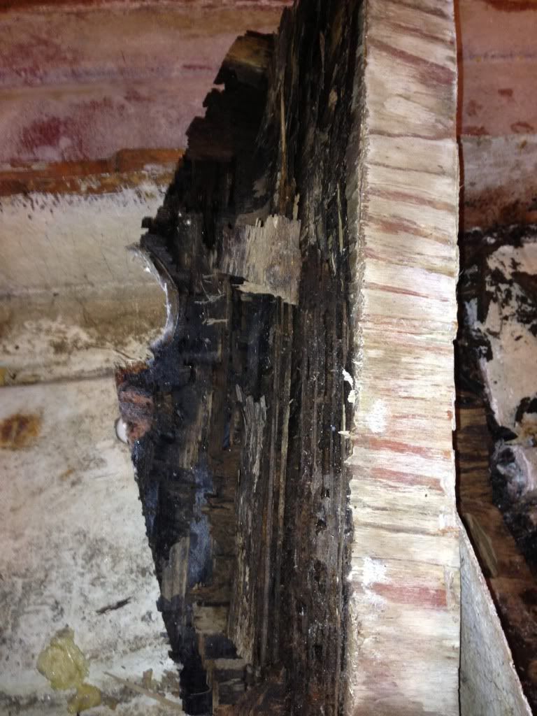

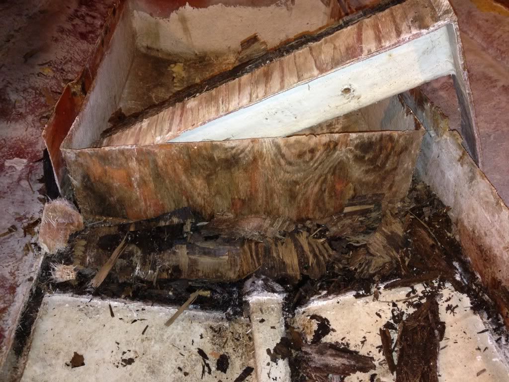

The demo just keeps getting better. This is the bulkhead and engine mounting block just before the bilge. Or what's left of it. Wood has turned to paper...naturally. Wow.

It's scary to look across your favorite waterway & see hundreds of boats, and wonder 'Which have no idea how close to major problems they really are........'
Because that ^^^ is lurking below decks & in motor mounts...
Knowing you took the time, effort & money necessary to find & correct all that nastiness makes enjoying it when you finish, all the better.

now you know why we all said gut it all. wood rot on boats is like rust on cars. once it is coming thru somewhere, time to roll up the sleeves.

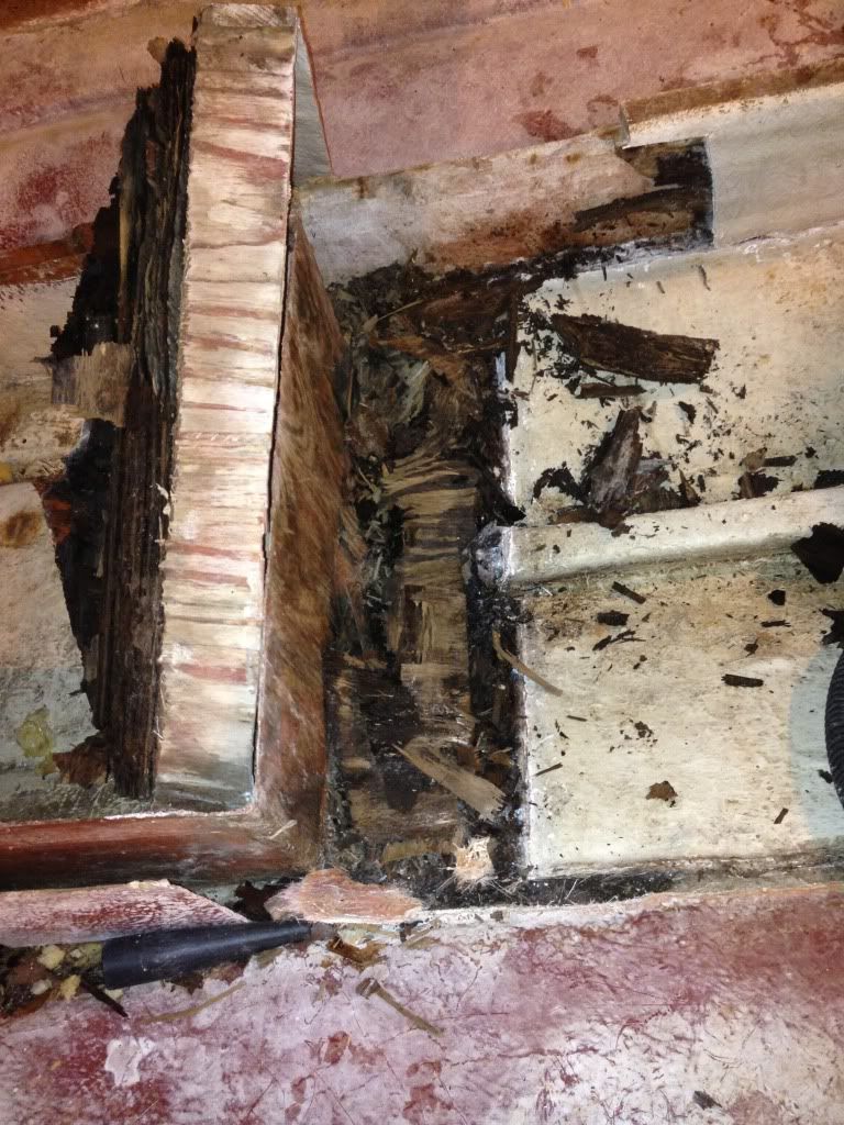

no need to chisel out that wood in the stringers, just get a sawsall and cut it flush.
The stringers are mush. I can pull them out with my fingers which is just amazing to me.

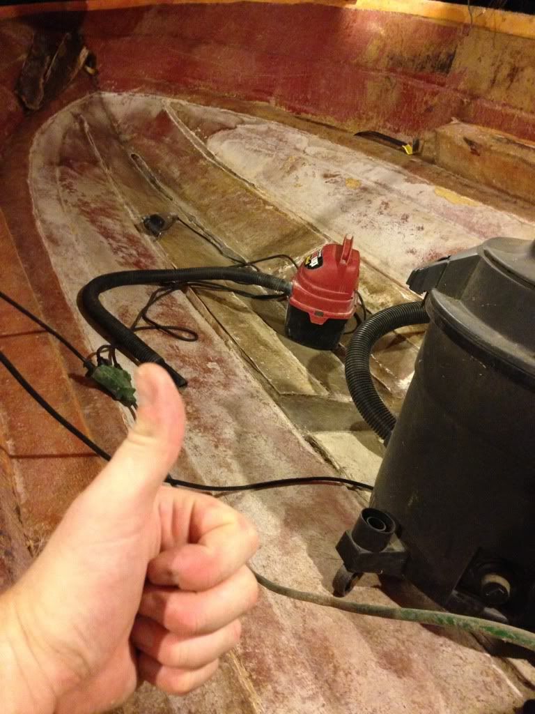

I haven't given up guys. Just wanted to let you know I was still all over this. I spent the last week on vacation at the beach which made me want to come back and finish this boat. Tonight I cut out the middle stringer. That leaves me with an empty hull. Tomorrow I am going to get a new blade for the oscillating tool and do some precision cutting on the remaining fiberglass that's left over from me cutting out the stringers and bulkheads. That should at least make my grinding experience shorter
