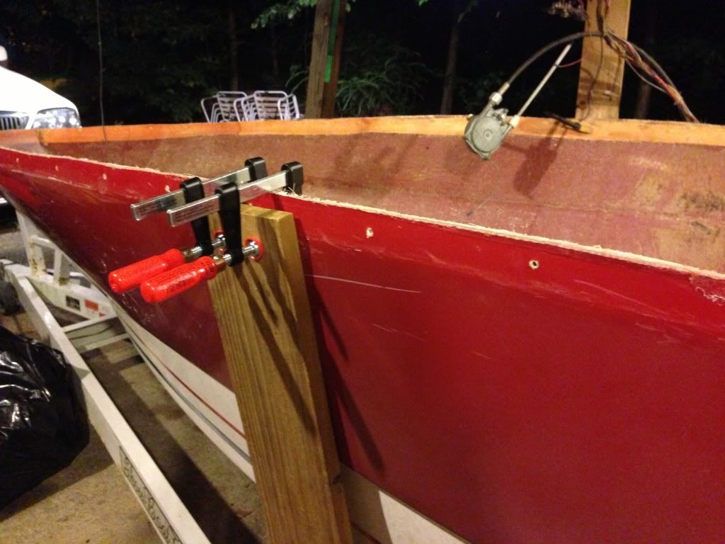

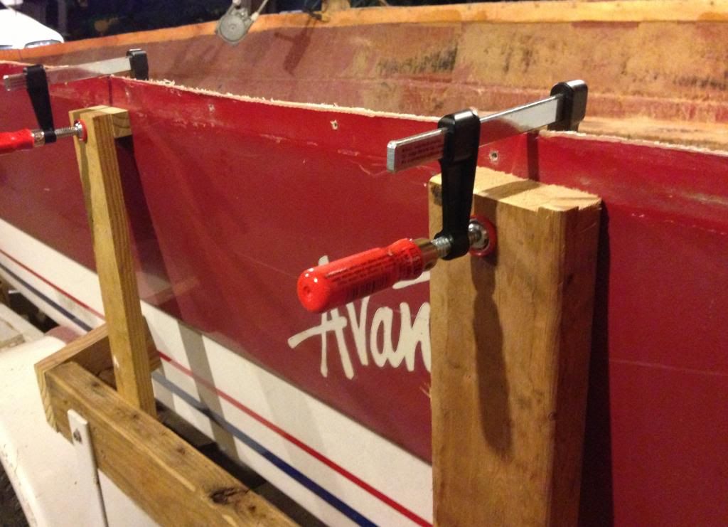

I'd do the absolute best you can to keep the hull supported NOW, not after more demo. And what you've added is a start, but IMHO, insufficient.
If the hull goes out of shape during demo, it may be difficult to guess-timate where it's supposed to be. The cap fitting is only 1 concern.
89avanti
Nov 25, 2012
137
Re: '89 Bayliner Avanti restoration - where to start?
I'll add more tomorrow to be completely sure the hull stays the same shape during demo and rebuild.
89avanti
Nov 25, 2012
137
OK, so I've reinforced the hull about 6x what it was. It doesn't move under my weight now. I used all scrap wood, really long screws and c-clamps.

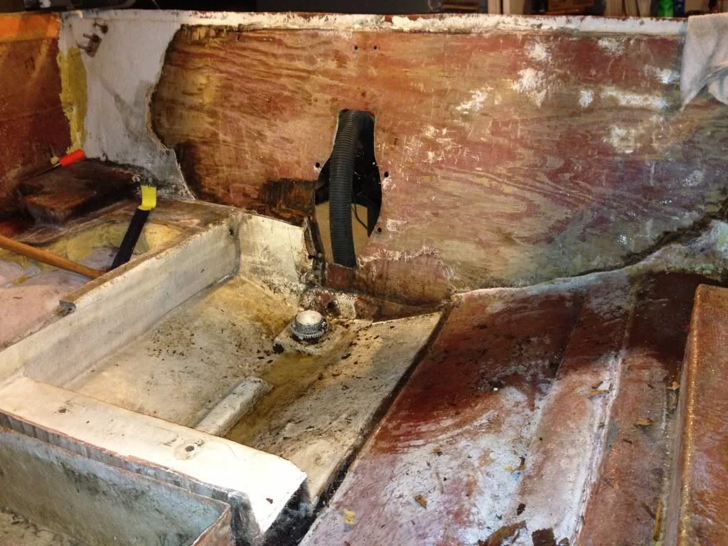

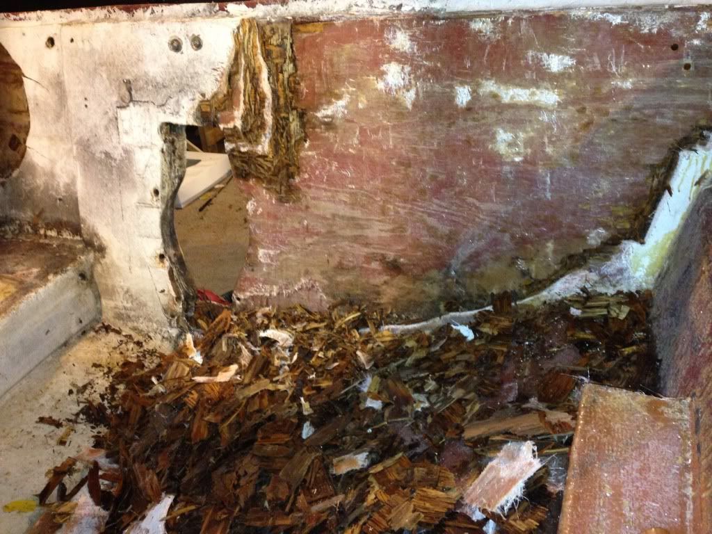

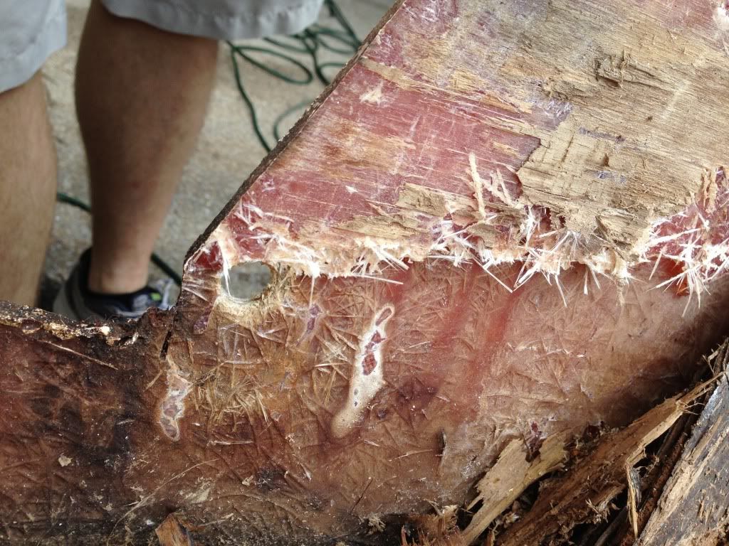

OK guys I hit another important question and a possible stopping point. As I'm tearing this transom out I got the wood down to the hull and I see an extra layer of fiberglass on the hull. Am I leaving this or taking it out????
carribbean soul
Mar 19, 2012
176
grind it smooth! that's where the manufacture put the wood on the hull and did not make contact with the back of the boat <void in hull>
89avanti
Nov 25, 2012
137
Gotcha. Thanks CS.

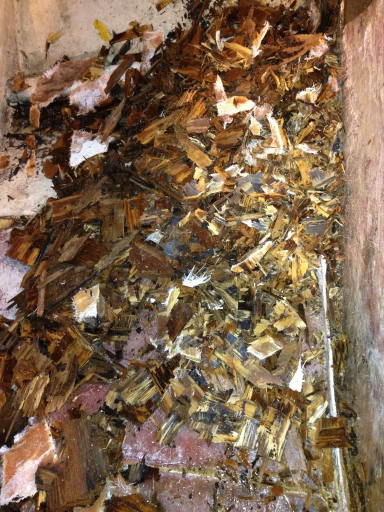

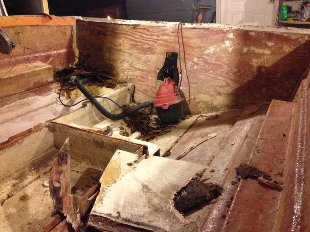

Update on progress.
I got through the right side of the transom last night. I picked the side which was less rotten to do first. Man it sucked. I was using a chisel and taking flakes of wood off at a time. The manufacturer layered the wood with fiberglass in between for more structure I assume. 1/4" ply, glass, 1/4" ply, glass, etc so on and so forth. I won't be doing it like that. Demo was WAY longer than it could have been because of how they did it. Regardless, I'm half through the transom and the other side is wood paste so aside from cutting the fiberglass out, cake.
53,272
That sucks. Looks like they changed their construction technique from 1984. it was two layers of 3/4" covered in 'glass.
Making progress though.

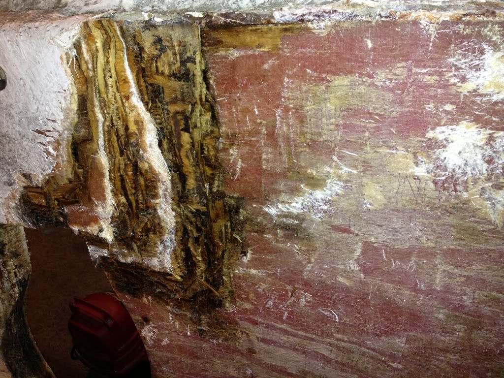

Should I pressure wash the entire thing once I have everything cut out? Then once more after I've done the grinding?
Also, in the second picture above, at the bottom of the transom there is break in the fiberglass. I believe Caribbean Soul said to just grind that out...will it eventually be solid? I don't want to have to grind that whole layer off, lots of glass to lose.
53,272
I pressure washed mine. yes, you will need to grind down, and build up.
