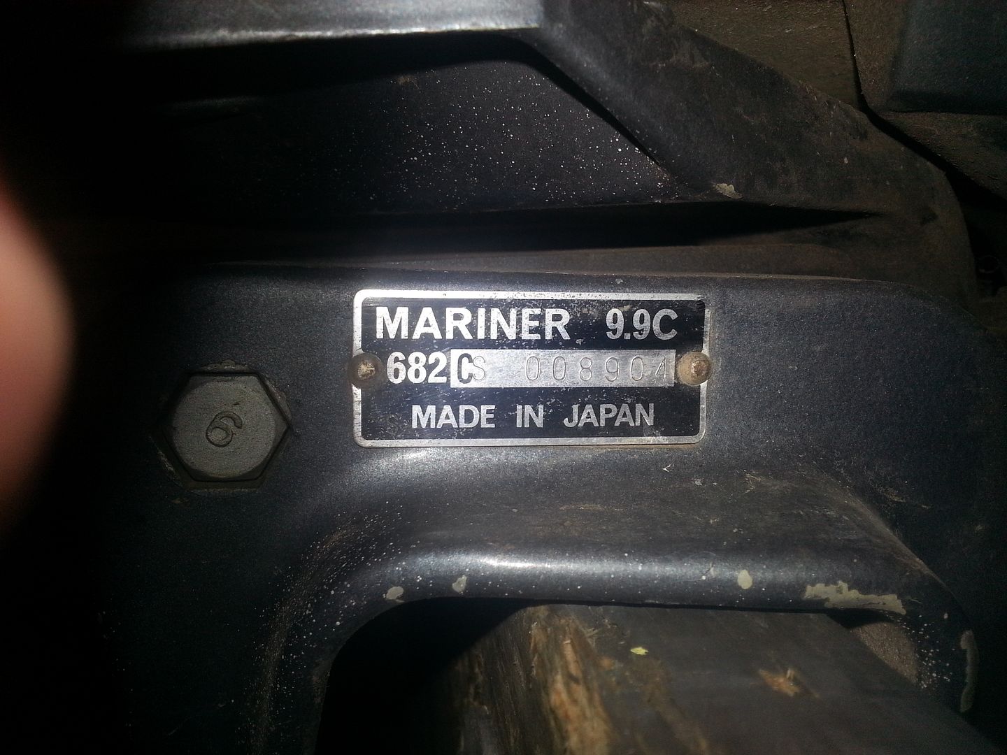

An old family friend dropped off his little Mariner at the house today while I was at work. I have never worked on one of these so I appreciate all the advice I can get. I am not sure the year as I cannot get the serial number to pull up.

flyingscott, I honestly don't know. I was hoping the serial number search would give me ideas but I came up with nothing. The serial number is lower than anything I see listed. It is a Yamaha made Mariner if that helps. I will go out and look for a cdi box.

Can someone point me to a parts breakdown on this one? I can't match the serial number with a parts list.

For your serial number, I get 1979 9.9hp
Serial Range (1979) 682-004461 to 682-011990.
