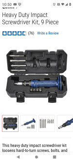

I tried the slotted impact driver and it is not deep enough, and has partially stripped the slot. The long screwdriver, I can't get enough pressure.
I understand now why Johnson outboards went out of business.
They make a driver with longer bits at HF.
I would suggest that you can't blame a manufacturer for failures or difficulties related to a lack of maintenance or wrong tool for the job.
You may get extra traction on the removal of the screw by fabricating or modifying or finding a heavy bodied steel rod that is long enough to easily reach the bolt and V shaped at the end a bit to stay put on the screw...then heating it red hot and heat cycling just the screw portion... but this is a last resort before drilling in my opinion.

OK, point well taken. I managed to get a chisel blunted and it fit snug and popped open, with a little effort. Replacement set screws cost $90, so I'll be fixing this one. Thanks.
