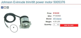

OK, new pump motor,are there better deals or is Sierra a good brand when it comes with seal. Does the seal on the center hydraulic s look suspect? If I'm replacing that seal, how do you replace that and where do you get the 4 prong tool to remove the cap?
Thanks,

Normally you use a spanner with 2 studs to remove the hydraulic cylinder caps. They are avail on Amazon for small $
A Sierra PTT motor is likely good. Normally I use ARCO, but it likely mach nicht.
Repair kits for the entire PTT unit are avail. They contail orings and seals. I would get the part number from crowleymarine and see what kind of price you can get, if you need it.,

I said pump not motor....if motor spins than most likely it's fine.
The whole rebuild kit is the way to go.
