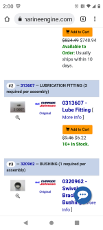

Part #2 .....3 required per assembly.

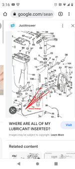

All I could find online. Might be broken off or missing. Look for a hole.
