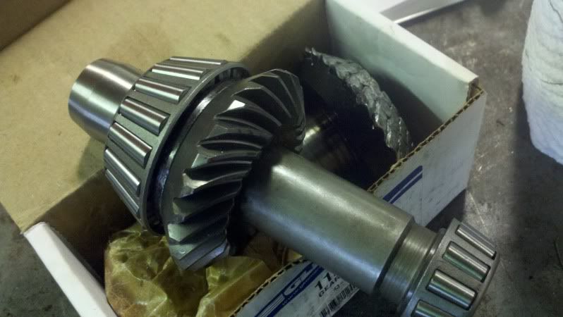

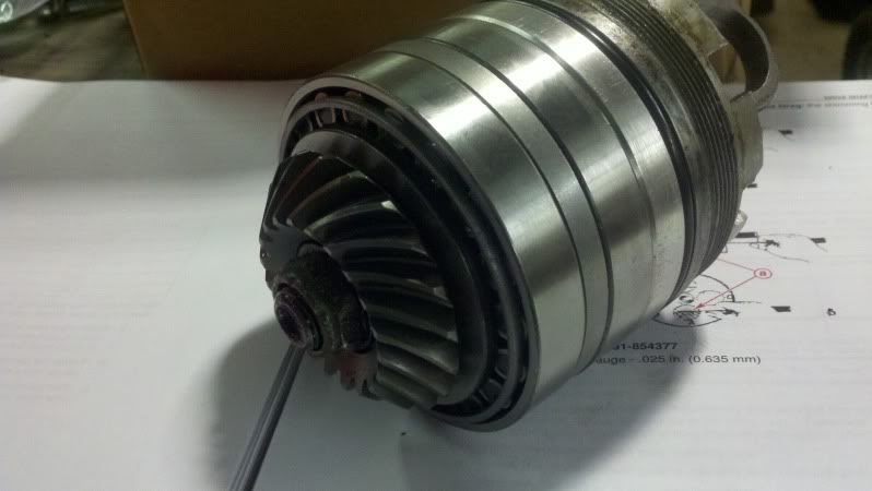

Sounds like you cooked the drive gear and driven gear. If its an alpha gen II pull the top dip stick and see if it reads any oil or if it has fragments on it. I would pull that whole top cover if it were me.
Heres a few images of a drive I just finished.

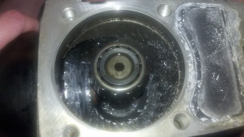

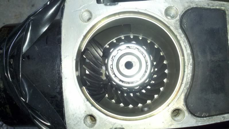

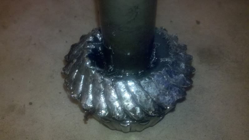

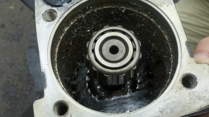

rkazmo
Jun 24, 2010
28
Re: Alpha one drive stopped working
Thanks to everyone for your replies!
I popped the top cover and it is the gears, totatly stipped!
Bondo
Apr 17, 2002
71,442
Ayuh,.... Then ya need another Outdrive,...
The trash from those gears is now In the lower unit too...
