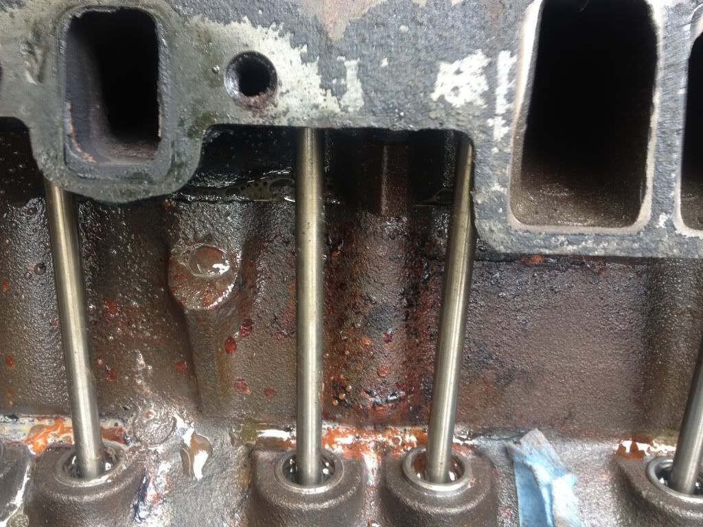

Got home pulled plugs they didn't look to bad and took all the bolts out of the manifolds and was able to see down in them to see of there was water in them and nothing. No signs of rust inside the exhaust runners. Now I'm stumped. Runs great at high rpms and no water that I could see on the exhaust runners..... Any ideas what to do next????

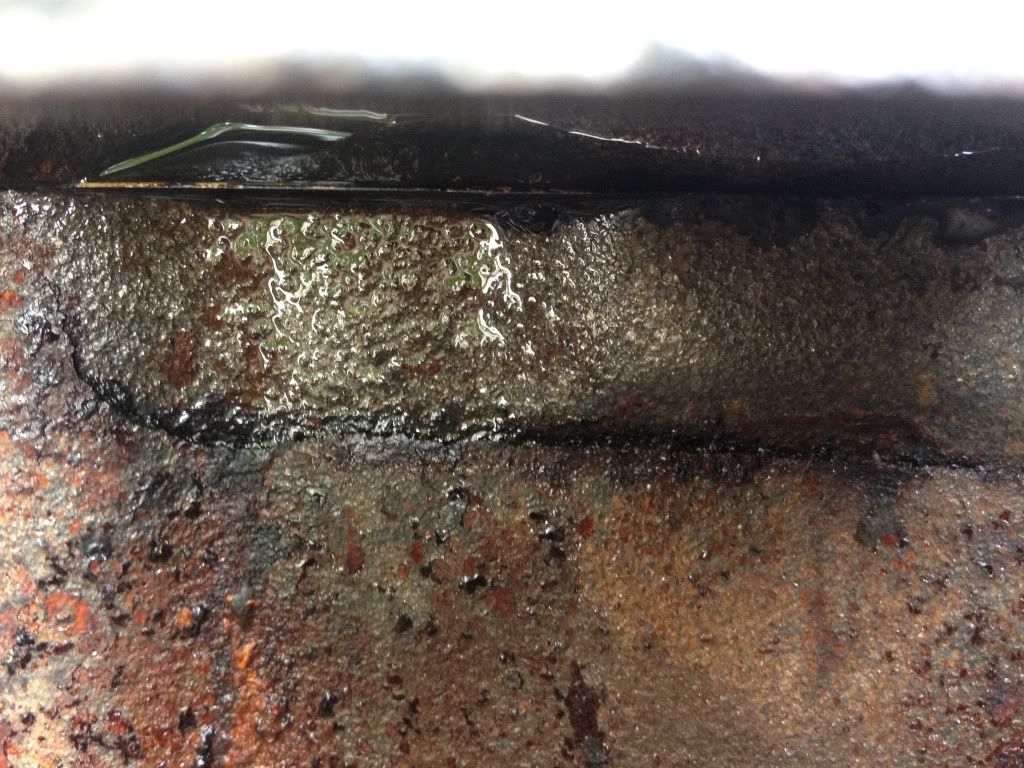

Ayuh,.... You winterized the Manifolds, 'n Not the block,... Now ya need a new motor,.... Sorry,....

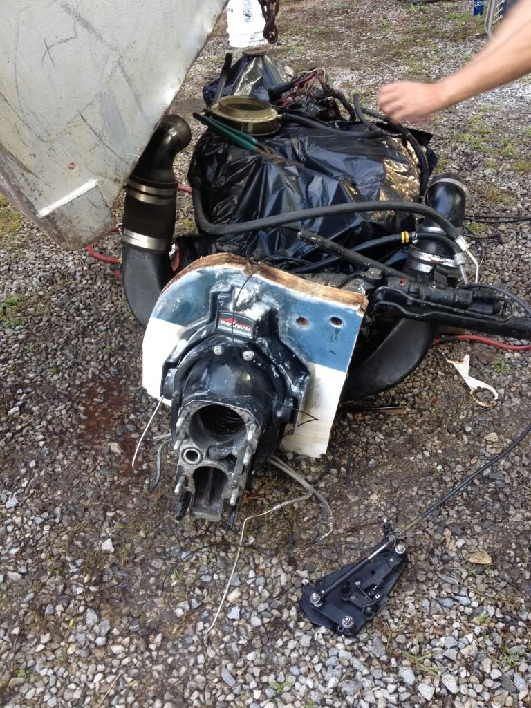

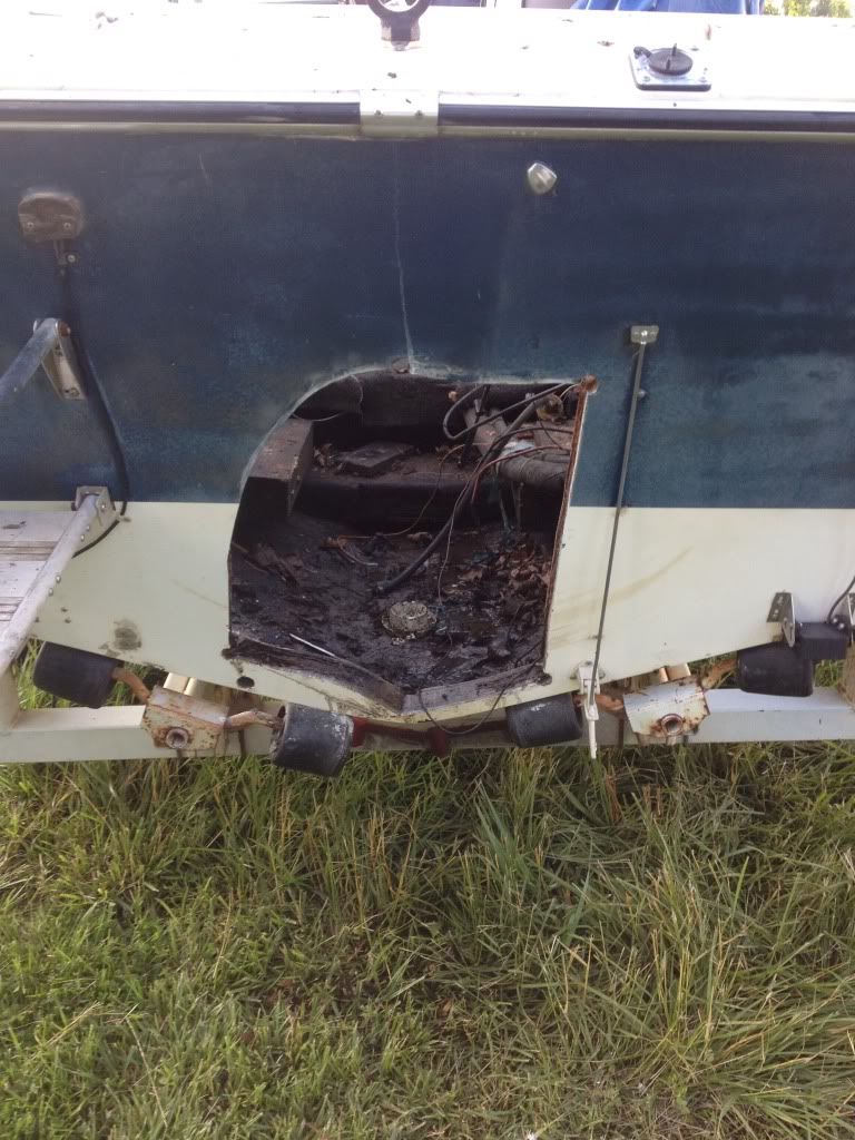

On the bright side I just pulled a motor out of a boat that had a hole in the haul. Gonna do a compression test, put a hei Dist with headers and radiator and run it make sure it don't over heat and no cracked blocks and try it again.

More then one way to get a motor out of a boat.
