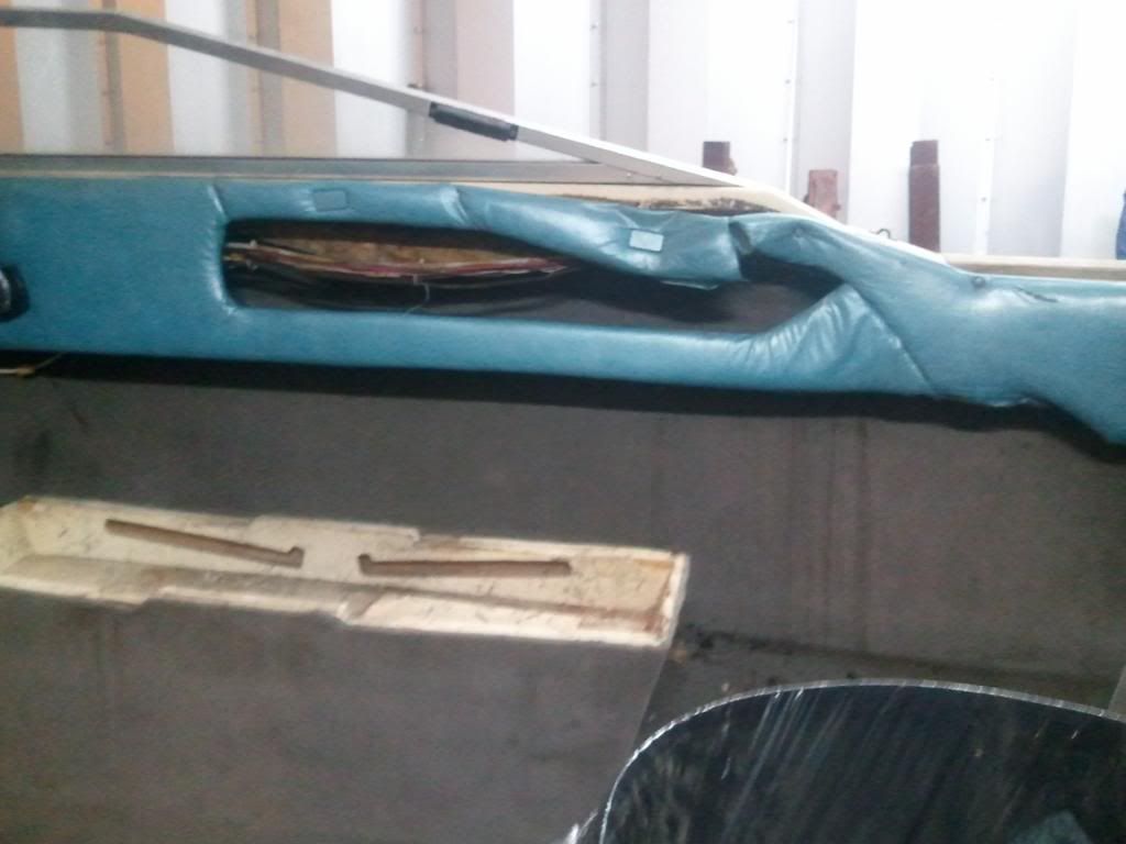

Another bayliner resto!;) This has been sitting in my driveway for a few years, it finally made it into the garage. Just thought i would start a thread so it is easier to get the great knowledge when needed.:) Its a 1983 19 foot going to due stringers and floor and transom and foam. Also adding a removable fishing platform, the fun has begun. Me and my uncle will be tackling this project. He is the one in the pic. [URL=http://s1293.photobucket.com/user/mrchev20/media
