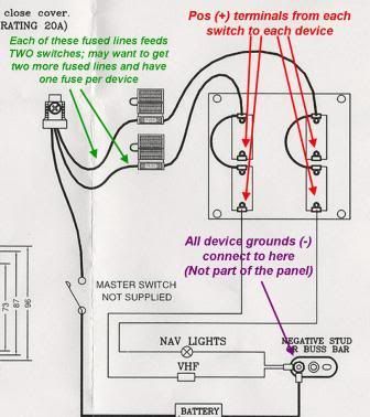

fish_on_the_deck
Petty Officer 3rd Class
Jun 30, 2010
94
Re: BEP Panel Switch Help
Thanks but I still don't get it, I don't see anywhere to connect into!
I assume the lower one is for the Negatitive, but with all the top ones taken . How do I connect?
NO NEGATIVE... unless the panel has lights on it (ie. a little indicator light comes on when the switch is on) there shouldnt be any negative to the panel. Obviously the loads (sterio, VHF, etc) will have negatives, but they will not go to the switch panel, they should find there way straight back to the nagetive terminal on the battery somehow... no fuses... no switches on the negatives.
For the hook-ups for your loads... each switch should have an empty terminal... like the instructions step 4 says. I cercled where they should be on the attached pic. You will need to tap onto this terminal with whatever the mate is.
It would help if you have a question like: "I assume the lower one is for the Negatitive" try using paint to mark up your diagram, or a picture of the actual product... b/c im not exactly sure what "the lower one" is.
these switches are simple... one wire comes in that is always hot. One wire somes out that is only hot when the switch is on. Youve found the wires coming in (wires with inline fuse)... look on the body of the switch for the terminal where a whire should be coming out. you can use a voltmeter or a 12Vdc light bulb to test.
let us know if you found the terminals yet... or post a pic of the back of hte panel and I'll circle them for you.

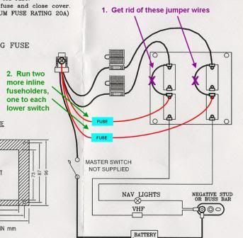

I'll take a stab at helping out, too:

ajgraz
Mar 1, 2010
1,858
Can I have another in line fuse for the Hot wire from the bottom 2. That way they are all protected with fuses?
Yes, but you want those inline fuses to come before the switches, and to have one fuse for each individual switch. And you want to get rid of the jumper wires linking each pair of switches.
Illustrated, here's what you want to do:
I agree! This is what I would do for a cheap, but improved solution. Also a separate little fuse block could be used, but this is easier/cheaper.
This way, if one fuse is blown you will only loose power to the "problem" circuit instead of the problem circuit AND its upstairs/downstairs neighbor.
