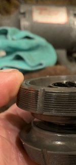

I just got mine tore apart, what do you guys think about the clutch?

The outside means nothing, it's the inside where the drive shaft rides on the inside of the clutch. What does the drive shaft look like?
ericcarr
Jul 27, 2009
294
I’ll post a picture of it when I get home from work this evening
