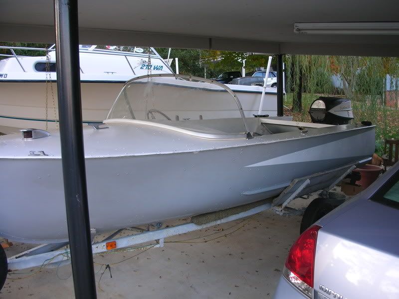

Hey gang,
I got my hand on a vintage aluminum boat that I am having a hard time finding information on. I was told it was probably a 59 or 60 duracraft boat. It does have the name plate on it but no date. It handles a 50 horsepower motor and can handle 5 people. At least the plate states this. Can anyone help me out trying to find this dinosaour a history. I am in the middle of restoring it. WHat I have done so far is mainly motor issues. I have rebuilt the lower end, changed all hoses, Rebuilt the carburetor, rebuilt the electric start. Thats about it. Other than that its all original. I will try to attach pictures to this but if it doesnt work I will try later. Just need to major help. I do not want to sink alot of money in this if I cant find any information on it. Plus It has a 1961 Evinrude lark 3 40hp engine that with a GPS shows 15MpH. That seems alittle slow for this.. Is there something I am missing to fix..

you are correct it is a mid 50's Duracraft. fantastic boat, handle rough water extremely well for it's size. it is heavy for an aluminum boat that size. looks to be identical to the one i had, but you have the windshield. it should do atleat 25 with the 40 if not more. i tried a 50 on mine, and it was a power house. there is not a lot of info available, the the people currently, running Duracraft, were not interested in helping me find more info. here are several post of mine.

there are a couple of brochures, at Fiberglassics.com

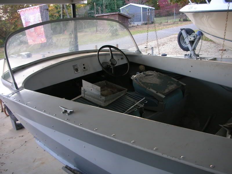

Thanks for the reply. I looked over your pictures for awhile and I fell in love with the bench seat and swivel seats up front. But you posted that it was to heavy in the stern. With the engine running mid 15 because there is something else wrong, I think if I were to do the same seating it would slow even more. I have a guy coming out next wednesday to work on the motor in the water this time instead of a trash can. The engine fires up and idles really well, just not all the power is used for some reason. He thinks theres something else. I went to a auto paint shop here in NC. and he does vintage cars and boats. HE adviced me to get airplane stripper and take off all the paint.. Sand it down and get it prepped for primer. Once I get there He was going to do it all for 1500. I want to paint the hull red or burnt orange wit the top being white and the stripe staying white also. My main concern is once i get the boat restored and ready. How am i going to get it registered and insured if I do not know anything about the boat. Also Is this investment worth the cost. I am 26 freshly out of college and dont want to sink alot of money into something that maybe down the road 10 years from now or less will not give me my return on Investment. you know what I am trying to say?

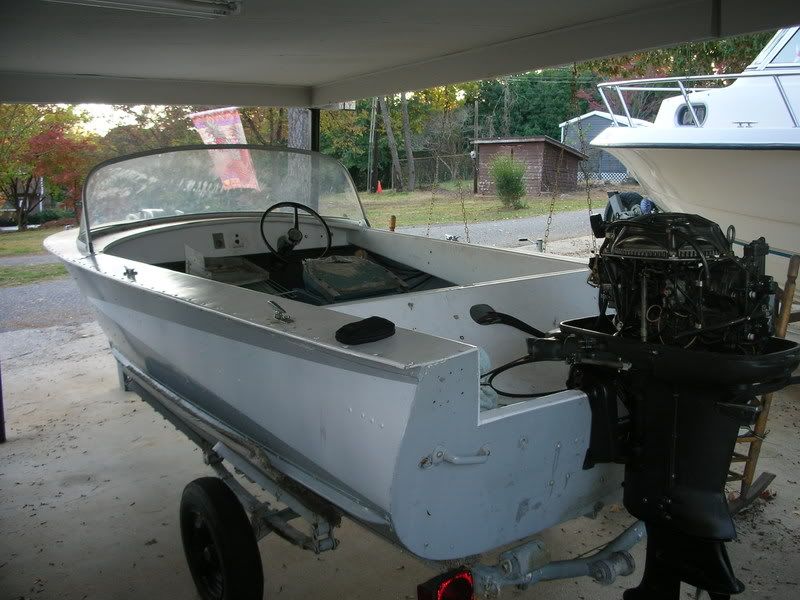

Hey gang. well the boat fired up just fine. but the mechanic didnt charge his tachmeter. so we had to wing it. he got in and noticed that the prop was to big for one thing. good thing it came with 3 extra props. I have to go through and see which one is the smallest. also he noticed the engine was firing on only one coil. so he thinks it something under the flywheel. i forgot what he said but i need to get my hands on new ones. other than that it FLOATS!! haha. one big thing he did notice though was that the engine has missouri registration stickers on it but the boat doesnt. so the engine is a aftermarket motor. didnt come with the boat. So do you think this will make the registration the boat and title more difficult.

OK gang, I need some more help. I have completly stripped the boat down to just the hull and am ready to start painting. This is where I am stuck. I am wanting to pain the hull a bring Tennesse Vols Orange and the Deck Bright White. The paint that is already on the boat is primer paint so I will need to sand it alittle and get it ready to be primed one more time. Before I do Topcoats and finally Clearcoat. BUt I need to know what kind of paint to get. Also what Brand. I have been looking online and really havent got a good answer. Can someone please help me understand what type of paint i should you.

HEy gang, I finally found some time to get to this project. I am posting new pictures of the work I have done the past few weeks. Like I said earlier this year I took all the parts off the boat and was ready to start painting. By the way I figured out why the motor wasnt running on all cylinders. There was a wire that was grounding itself in the motor. After I got the motor all wrapped up I took the boat out for it last test ride and it ran 28 with me in it and 26 with my wife with me!!!!!!! As you can see in the pictures I have primed it with Interlux Primekote. THis stuff is great!! It went on very easy and was a bad mess to clean up.
