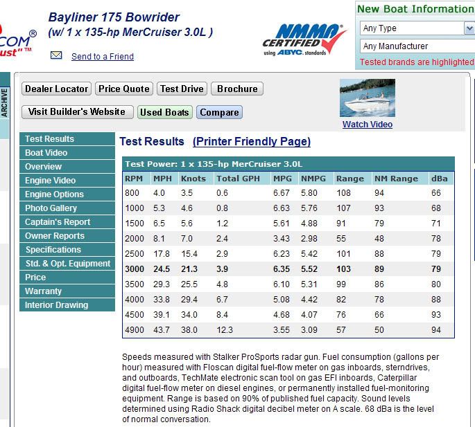

I put $20 in yesterday, went 12 miles to the beach, pulled tubes all day and drove back, all on $20.
Must have started out with WAY more than $20 worth in it. $20 at $3.50 per gallon is 5.7 gallons. A 17.5' Bayliner with a 3.0 gets about 6 MPG. So it used 2 gallons going the 12 miles to the beach, and 2 more gallons coming back the 12 miles from the beach. Means it "tubed all day" on 1.7 gallons of gas. It uses .6 gallon/hour just idling!!!
You can throw all the numbers around but bottom line using 6 gallons of gas I did just what I said. Take the Magazines with a grain of salt and maybe listen to the people who actually use the boats for more than a the few hours a review takes.

Good boat Chip73 - might want to make sure you keep it, you'll never find another one that can come close to what you claim! :) :)
I have a 16' Mark Twain with a 120 Hp 3.0 - it gets between 4 and 5 mpg (averaged over a days use) in the real world just like everyone (except yours!) elses 3.0. Never tried tubing or wakeboarding behind it (use the other boat for that) but I would imagine that it would not help the gas mileage.
