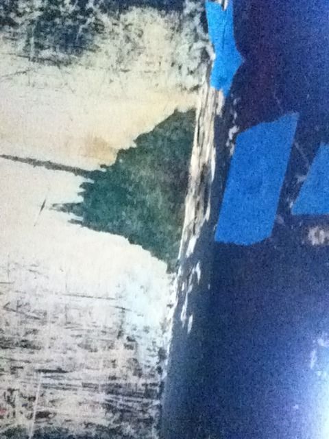

Keith, I do detect a problem with the bottom of the transom right in front of the prop, I have marked the area in Red so you can see it easier. I would appreciate it very much if you would take about 4 pictures, 2 from directly underneath the transom in red and 2 more 90 degrees with the hull from directly behind the area in red. Having the transom bottom in this area with a gouge in it could definitely create a lot of air bubbles, traveling directly back to the prop. It may not actually be as bad as it looks in the picture, so I am not positive, that is why I would like the additional pictures.
PossibleproblemmarkedinRed.jpg http://i369.photobucket.com/albums/oo138/hwsiii3/PossibleproblemmarkedinRed.jpg

Re: Could these lights be causing my EXCESSIVE prop slip?
Geez my camera phone is awful!
I'll take some better pics with the real camera tomorrow.

limitout
Banned
Oct 1, 2013
543
I think what he is trying to see is if that spot on the bottom is damaged or warn thru the gel coat or is it just a spot where the paint came off and the gel coat is still undamaged and intact
its hard to tell what is what with so many different colored paint its like camo so its very hard to see what we are really seeing

Keith, I would appreciate it if you would take pictures with the (real camera) LOL, just like pictures 1, 2, 4 and 5, but get as close as you can and still have good clean pictures that are in focus.
And you are very right limitout, thank you. I can tell by the Green color on the bottom that the gelcoat is gone by the transom, I just can't tell how chipped and rough it is on the bottom and the transom.
